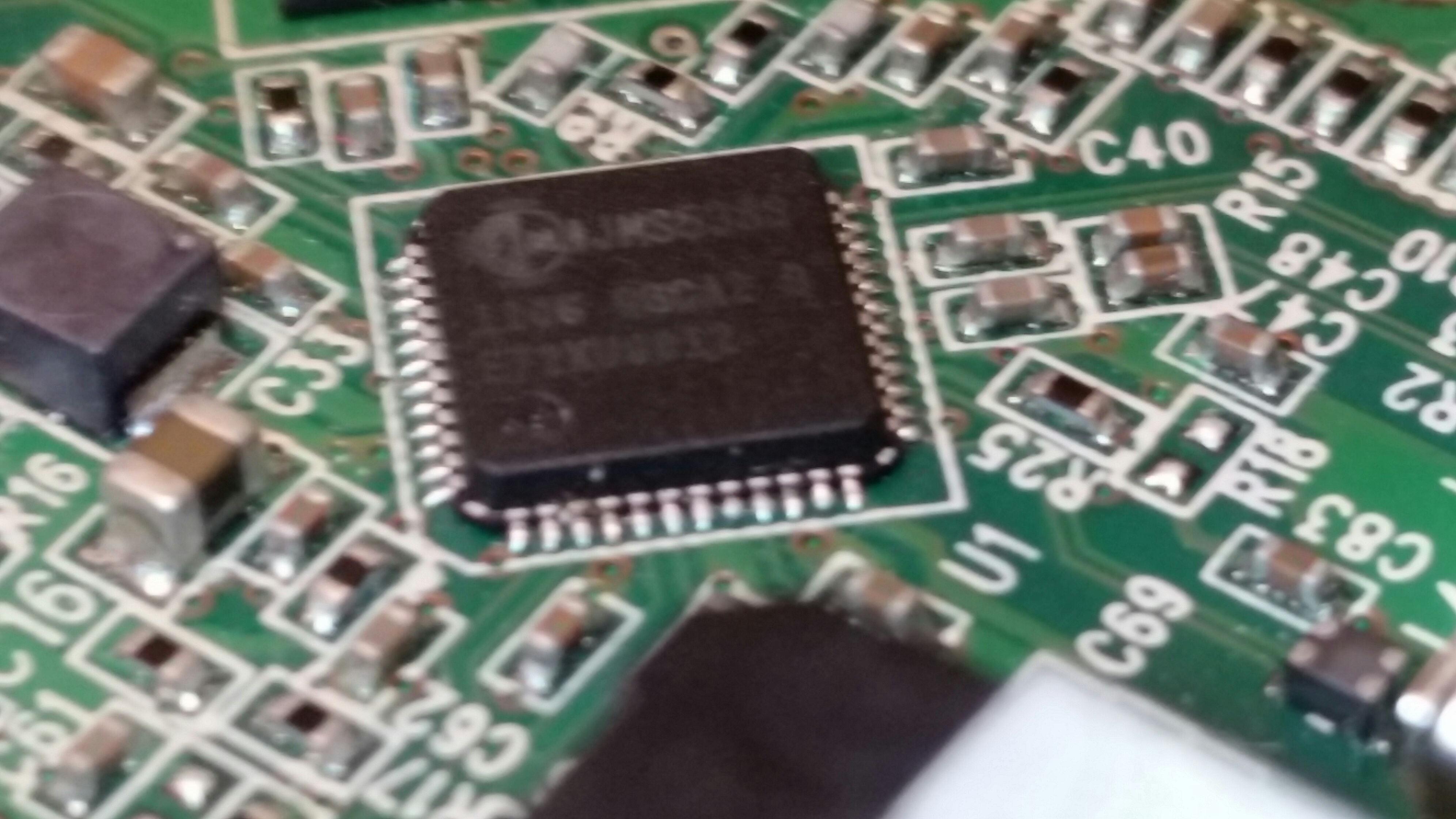

Is this an encrypted drive? The drive has 6 heads, 5 good 1 failed. I imaged 5 successfully before the head swap but the platter under the last head is in bad shape, so I have an image, but by no means complete. The client gave me the USB bridge board (JMS538S) however this does not decrypt the drive.? I have also tried initio and asmedia chips but still do not read the drive. I think there is a way to tell the type of encryption used in one sector near the end of the drive. I cannot find it, but that may be under the last head which we didn't get. Any help would be much appreciated.

Definitely encrypted. Only that bridge model will work as that was the type it was encrypted with. Asmedia and such will not work.

Thats the confusing thing. The picture is of the bridge board that came with the drive and it says the drive is write-protected when scanned?

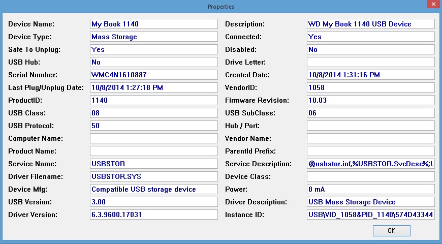

You need to reduce the capacity of the 2TB clone to match the capacity of the original 1TB drive. To this end I would use a tool such as HDAT2 to create an appropriately sized HPA.
A capacity of 625076223 sectors equates to only 320GB. If you connect the bridge board on its own to a USB port, what do you see in USBDeview or UVCView? This should tell us if the bridge is native.
Could we see MOD 25? This will tell us the location of the SmartWare VCD and the end of the visible data area.

Sorry, I didn't notice the site wouldn't upload a bin file. Here are both the USB report and the MOD25 file. The patient is a 2TB drive and the clone is a 3 TB drive. Setting the corresponding HPA now.
Interestingly, the USB bridge board has taken on the S/N of the clone, is that normal?
