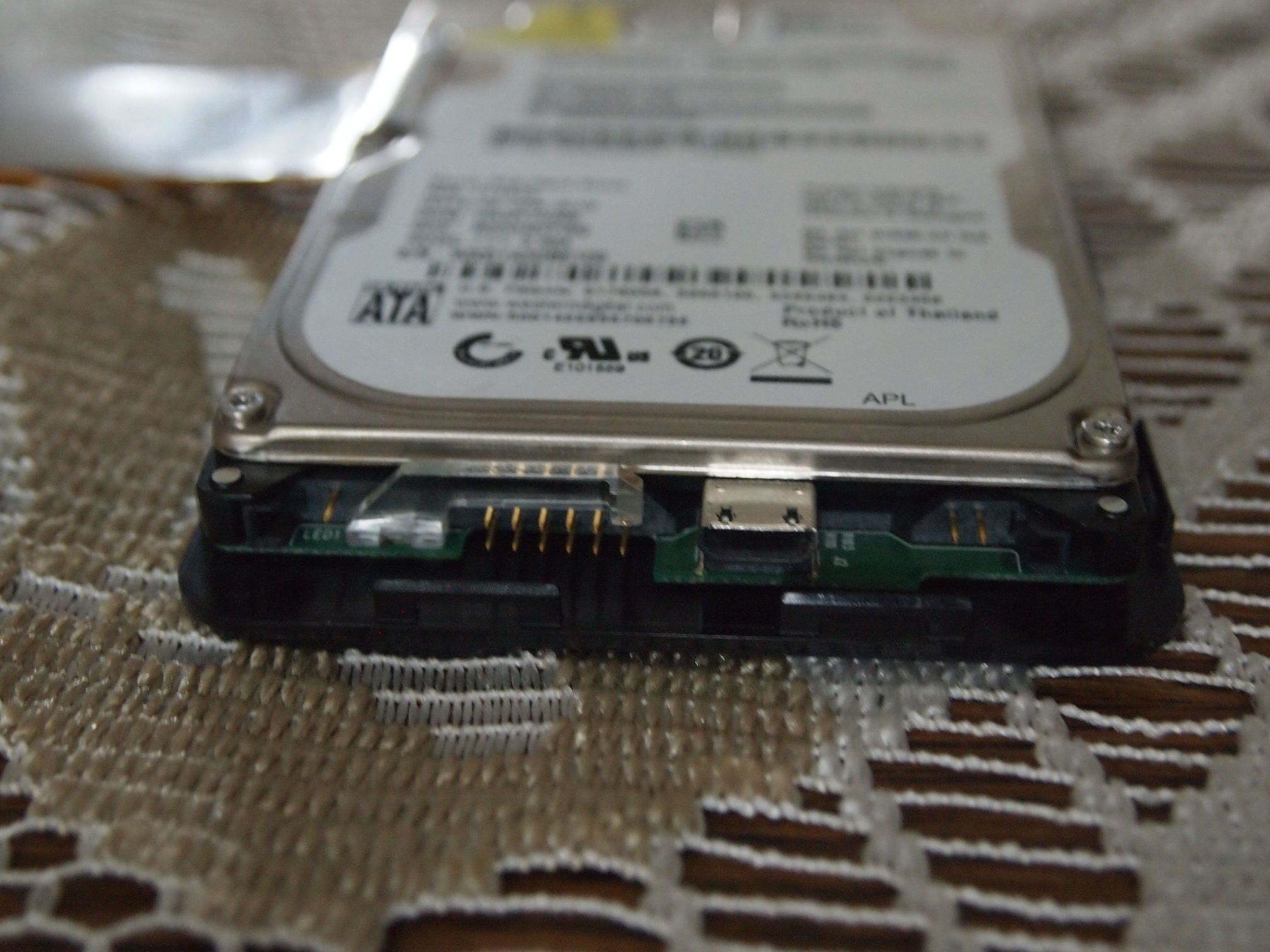

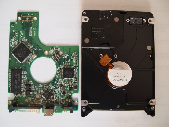

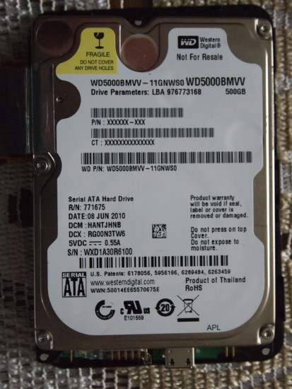

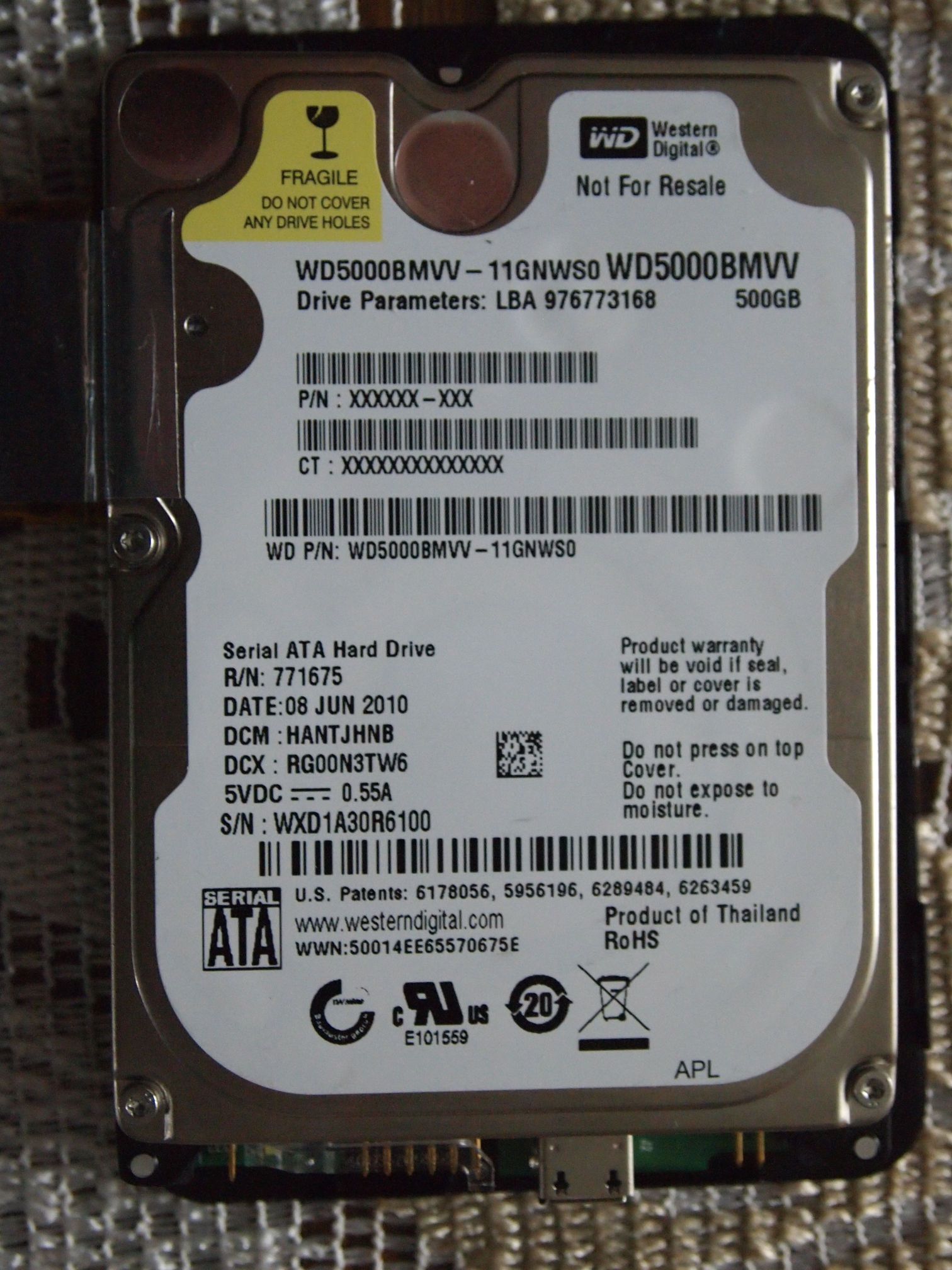

I've got a 500 GB Western Digital WD5000BMVV-11GNWSO. That's one of those disks with only USB on the PCB.
After connecting it to the USB, the disk doesn't make any alarming sounds - it rotates the platters, blinks the LED. Unfortunately, it's not recognized by BIOS.
My drive is: WD5000BMVV-11GNWSO
My PCB is: 2061-701675-604 04P
I found a donor who might send me these:
drive 1: WD50000BMVV-11A1CSO
PCB 1: 2061-701675-002 04P
drive 2: WD5000BMVV-11GNWSO
PCB 2: 2061-701675-604 10P
My question is if I have any chances to use his PCB to rescue the data from my drive. If you think yes, what exactly would I need to do? I read that I surely would need to replace the 8-pin chip. Anything else?
My other question is about the method to solder some wires and removing 4 capacitors to get the access straight to SATA. Is it really doable? I read that I might get encrypted data out of that. Do you have any experience with that?
Best wishes,
Piotr

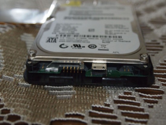

PS. I attach the photos of the disk in case it might be useful:

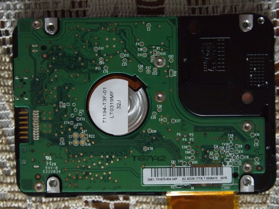

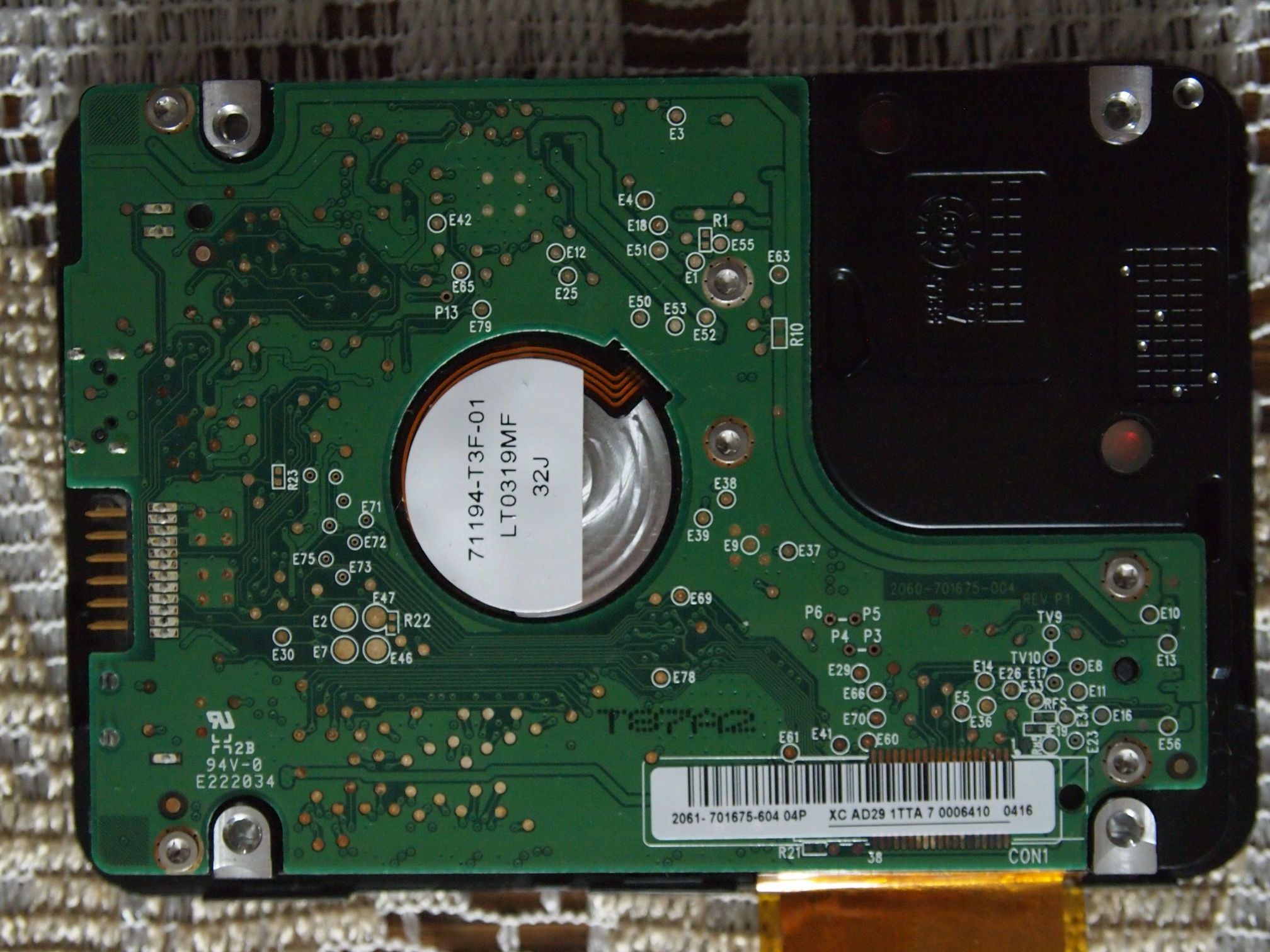

Dear all,
finally I got my screw set and was able to detach the PCB. Here comes the photo of the other side of it (dark side? ; )
Thank you for your ideas,
Piotr
 Post subject: Re: WD5000BMVV - disk not recognized by BIOS
PostPosted: October 11th, 2014, 1:39
Posts: 17230
Pin #7 of U14 (/Hold) appears to be hardwired to Vcc. This means we can't short it to ground as I would have liked to. Doing so would have invalidated the firmware, in which case the bridge IC would then have identified itself as an Initio Default Controller.
If you connect the PCB on its own to a USB port, does it appear in Device Manager?
Does UVCView detect it?
http://www.users.on.net/~fzabkar/USB_ID ... ew.x86.exe

Thank you, fzabkar.
Unfortunately, nothing happens if I detach the PCB and connect it to the USB port. UVCView doesn't see it. What else could be done?
Pin #7 of U14 is definitely connected to VCC.
Do you need a better quality photo?
Below what UVCView shows if I connect disk as a whole:
PostPosted: October 15th, 2014, 9:43
Joined: September 25th, 2014, 11:21
Posts: 7
Location: Wroclaw, Poland
Hi again, is there anything I can do to retrieve the data from this disk? I wouldn't like to spend a lot of money on professional data recovery. But it has already taken a lot of time and I wonder if there's any chance for me to avoid it. Thanks.
PostPosted: October 15th, 2014, 15:36
Posts: 17230
UVCView is indicating that something is present on the USB port but it cannot communicate with it. You could try shorting the data output pin of U14 to ground while powering up the PCB (Ace Lab uses this approach, but it makes me feel uncomfortable). If the bridge then identifies itself as an Initio Default Controller, my approach would be to convert the PCB to SATA mode and then try to retrieve the drive's firmware resources. The next step would depend on what we find.
