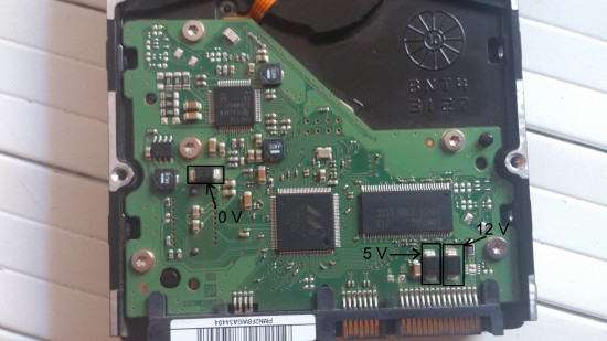

hi everybody
i don't work a lot with this hdd i just store data and p, one day i wanted to copy something
the drive dosn't in bios and it's not spining :roll:
i'm not good in electronics but i checked the 12V and 5V TVS and they r working
but in the other TVS i find 0V !
is that normal ???
any suggestion ?

Try a diferent PCB to see if it spin up.
