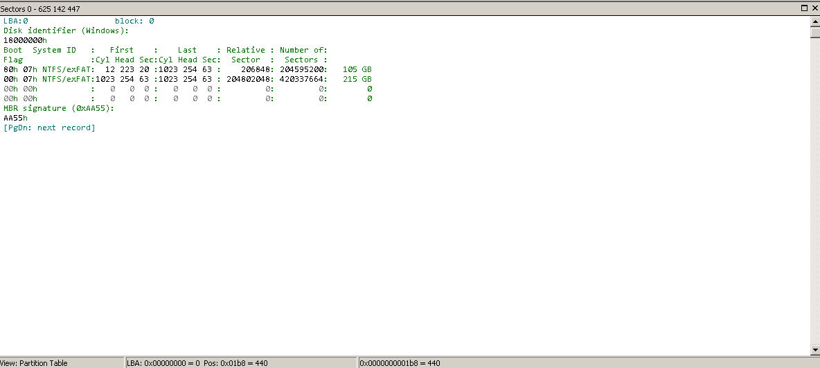

 Post subject: Re: Hard to deal file system corruption.
PostPosted: October 17th, 2014, 3:16
Posts: 17230

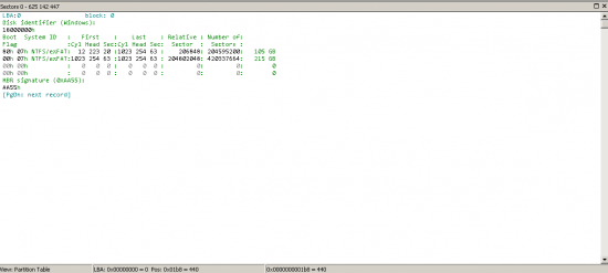

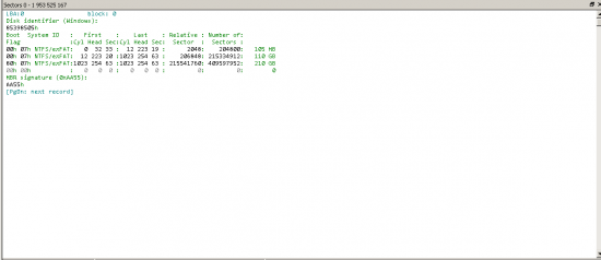

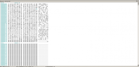

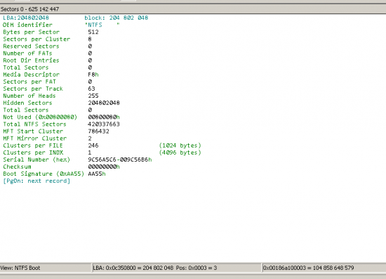

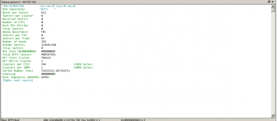

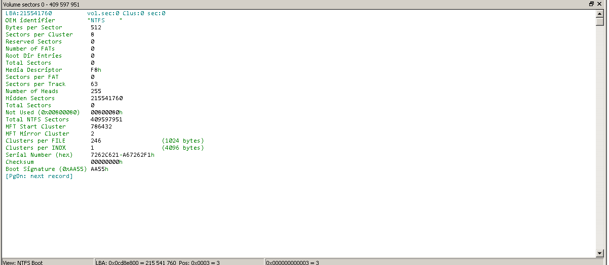

Show us sector 0 (MBR and partition table) and the boot sectors for each partition. The boot sector should tell us where the MFT is located, assuming it is decrypted. I'm not familiar with Pointsec, but if it encrypts the entire drive, then we may be able to tell if the drive has been fully decrypted by looking for a backup boot sector at the end of the partition. I'm assuming that decryption is a sector-by-sector operation, from beginning to end.

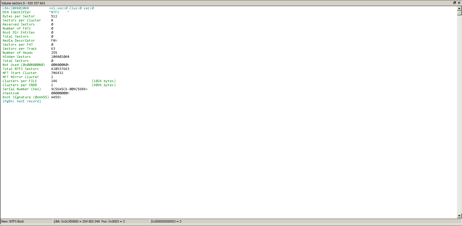

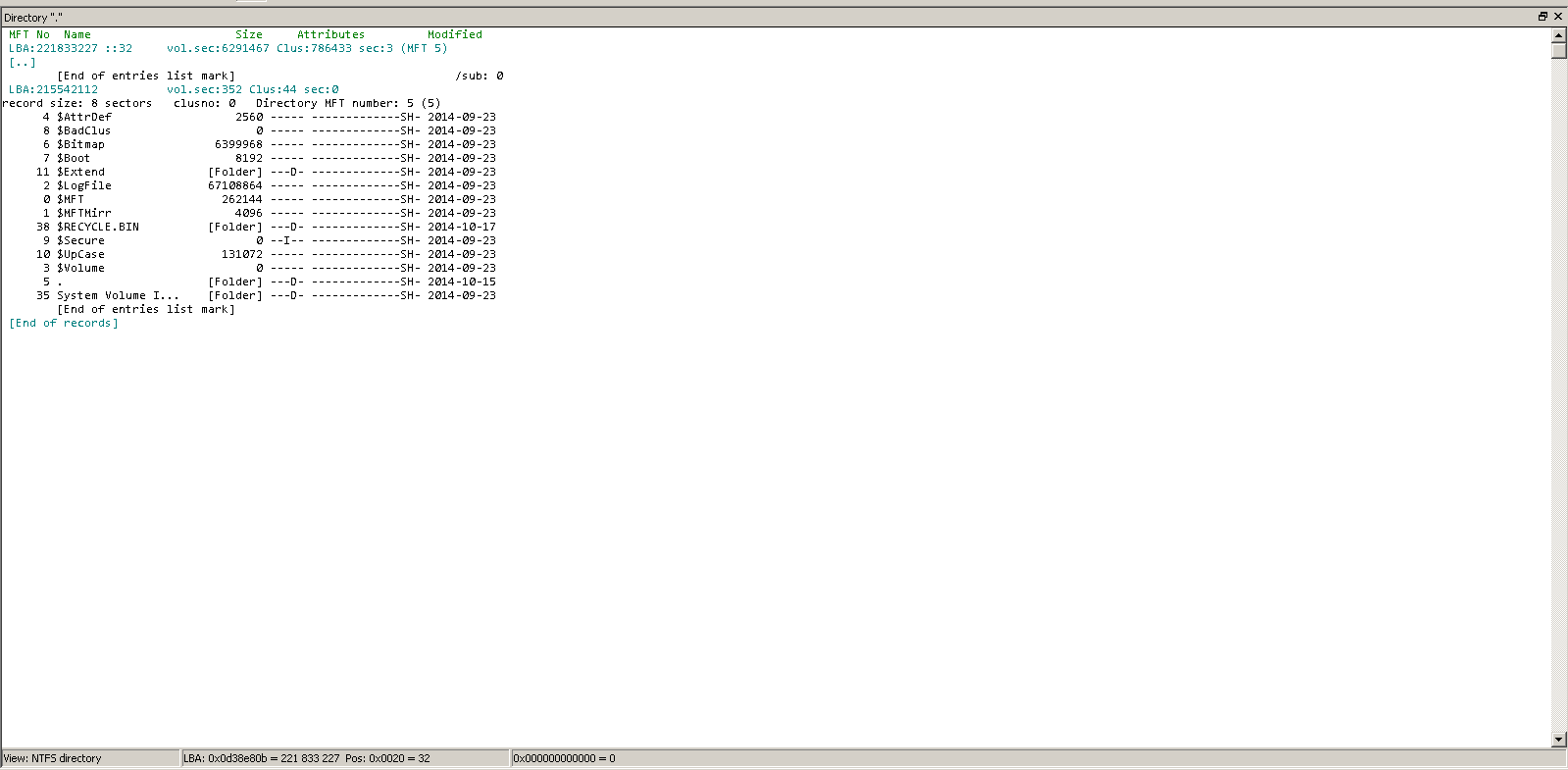

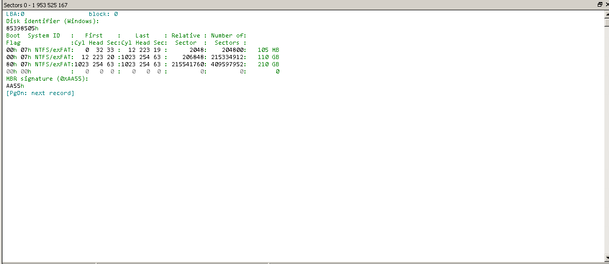

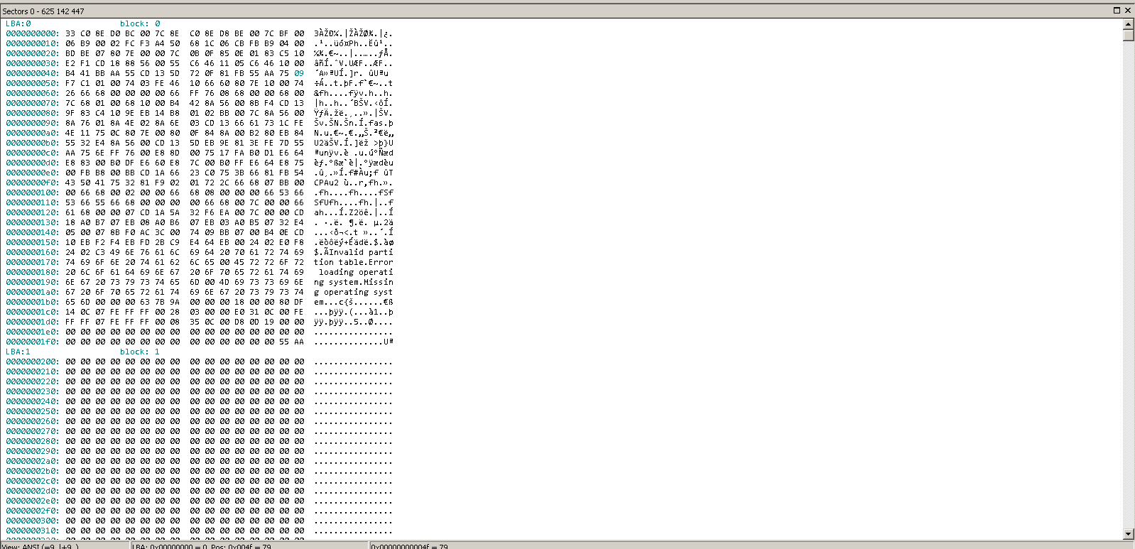

Here is all details like -- 1) partition table 2) MBR 3) MFT details 4) Root directory etc.
DISK 1

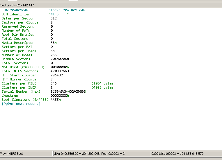

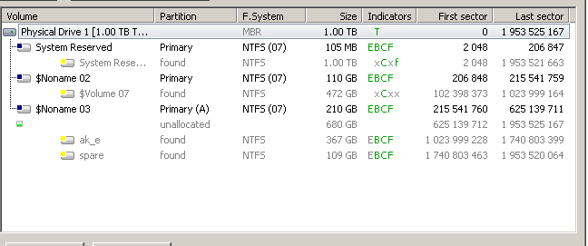

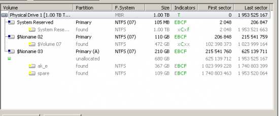

Here are details of DISK 2

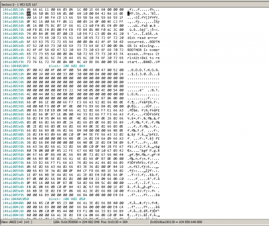

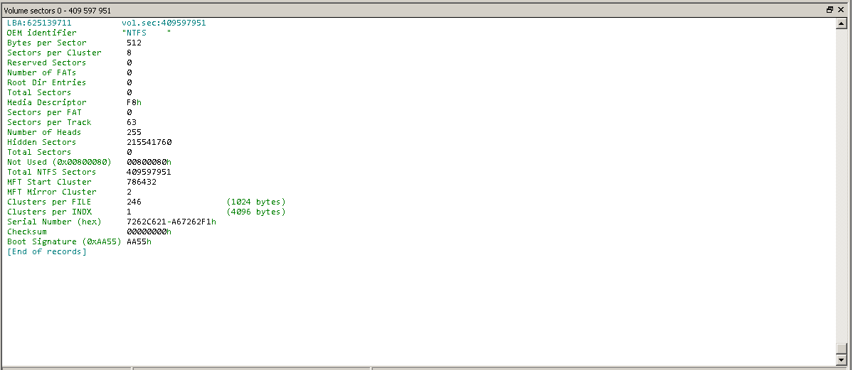

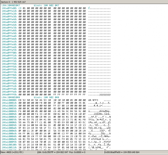

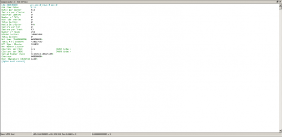

PostPosted: October 18th, 2014, 19:02
Posts: 17230

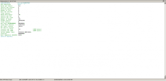

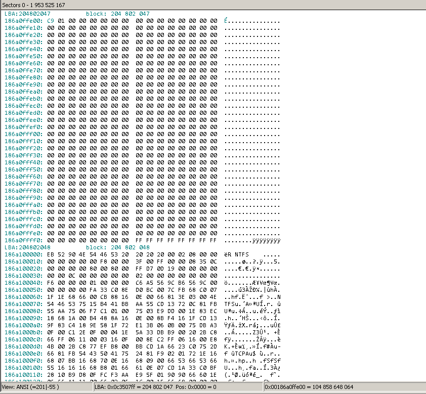

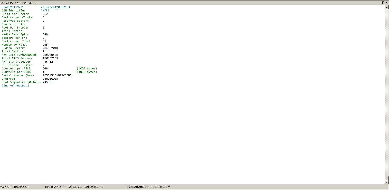

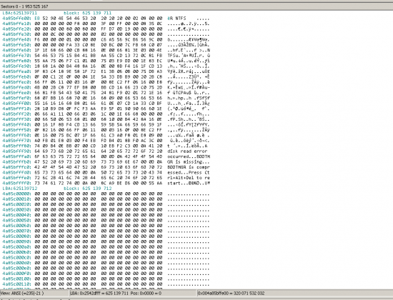

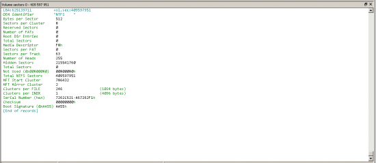

The boot sector is obviously not encrypted. There should be a backup boot sector at the end of each partition, namely sectors 204802047 and 625139711. If the backup boot sector is not encrypted, then I would think that lcoughey's concern regarding partial decryption could be put to rest. That said, it could be that I don't understand how Pointsec encryption works.

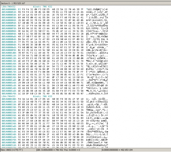

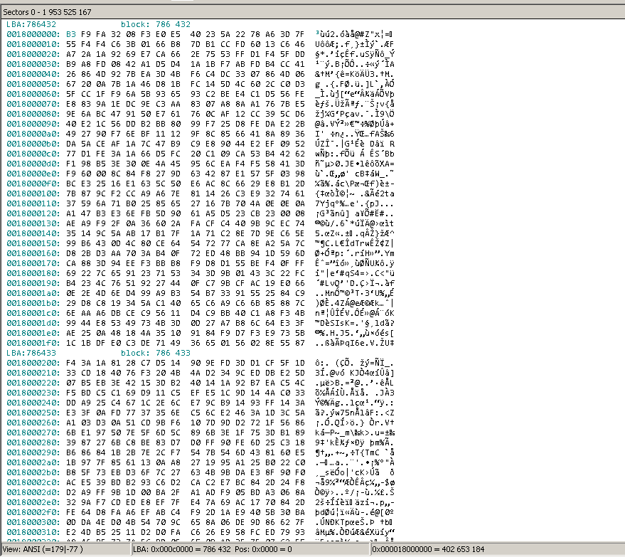

My next step would be to examine the MFT start cluster, namely 786432, and then walk down the MFT. If you have a clone copy, then CHKDSK in readonly mode should be able to do an integrity check of the NTFS file system.

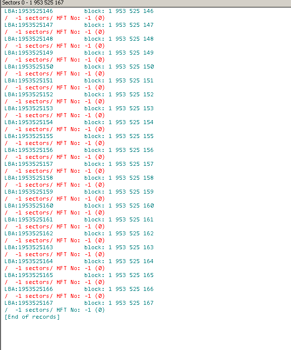

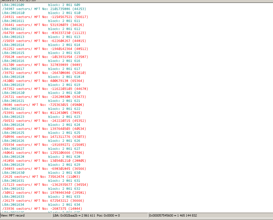

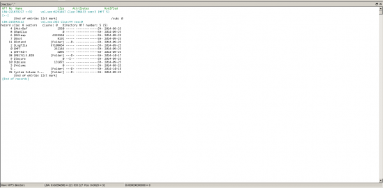

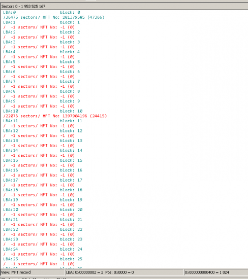

Hi Fzabkar

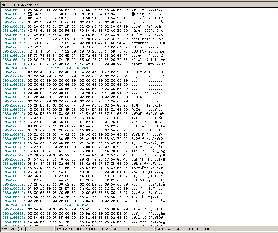

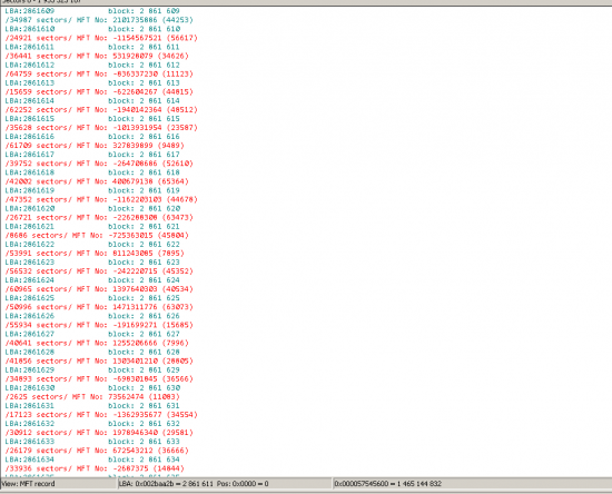

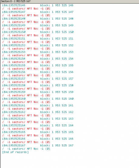

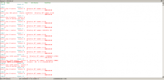

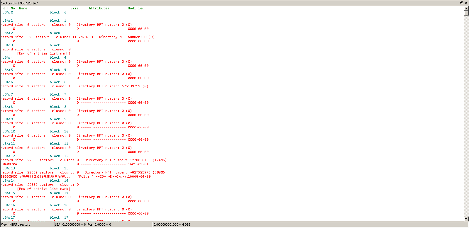

I tried to run chkdsk , it has detected MFT error but could not fix it (gave error MFT cannot be recovered).

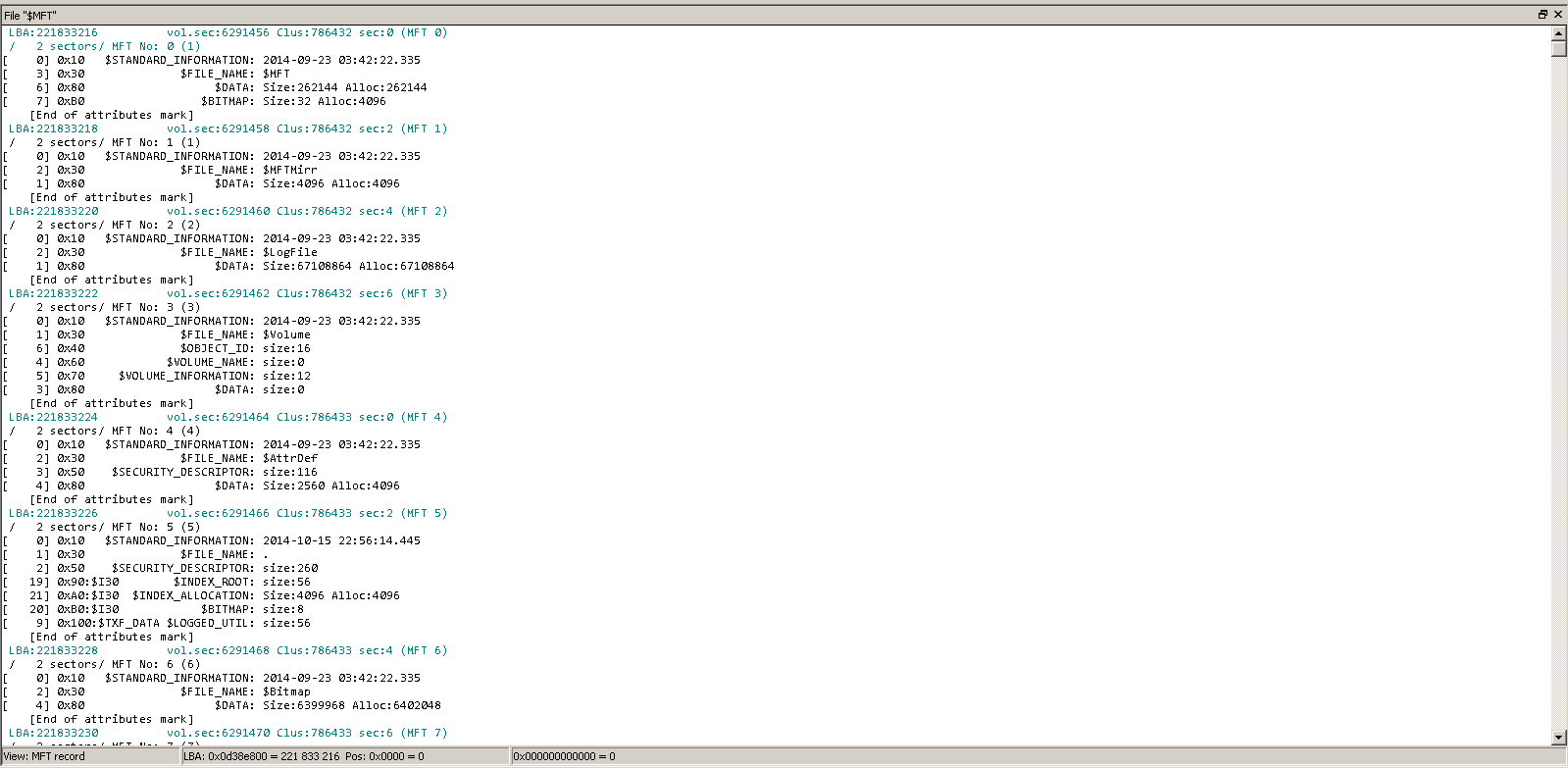

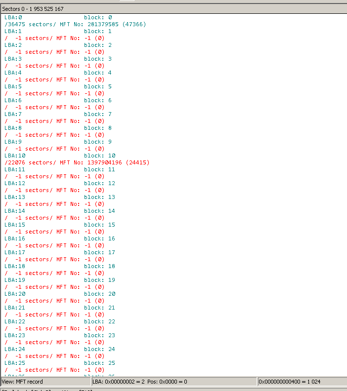

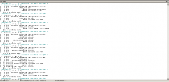

I have taken snapshots of various sectors ,hope it will make picture clear. I have also attached MFT records details which shows errors.

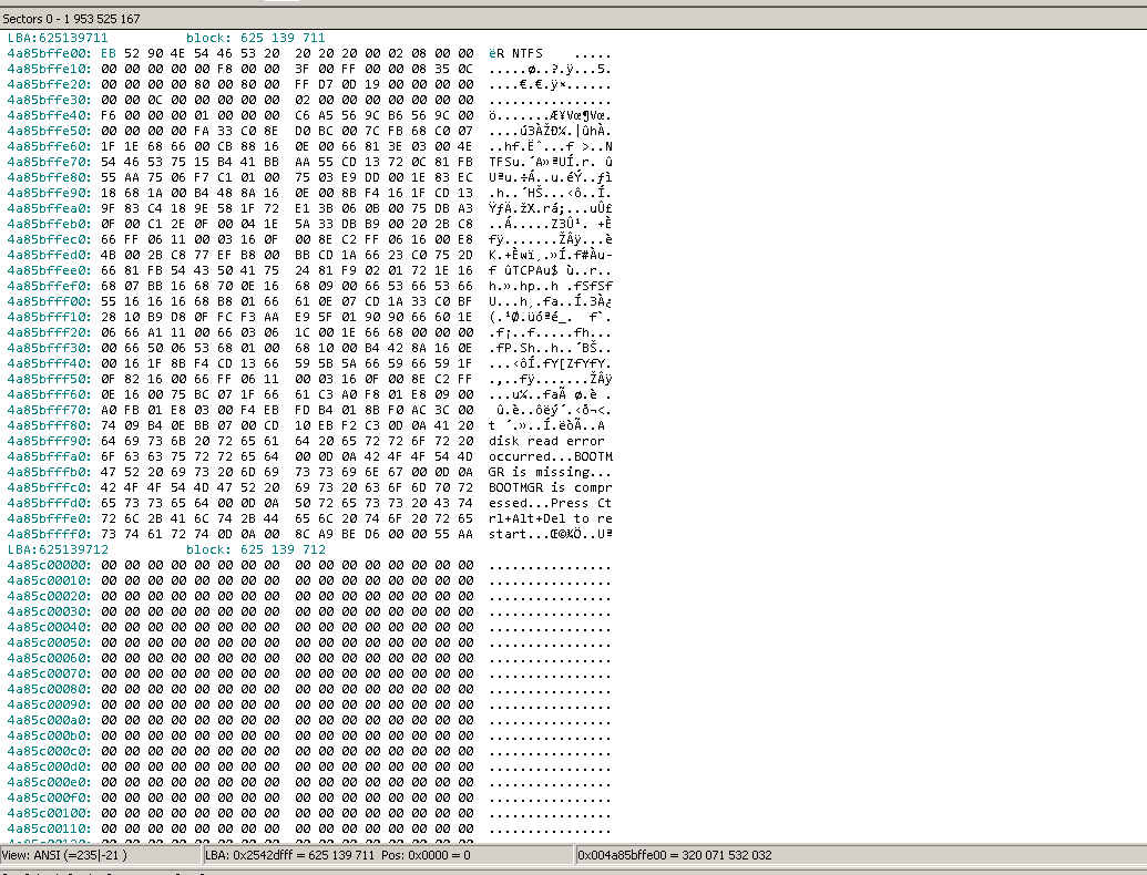

winhex gives error --cannot open "$MFT" unexpexted data at a offset C0000000 and offset 2000 Res =9 , Res2 = 9
I am eager to know what could be so severe issue for this corruption.
