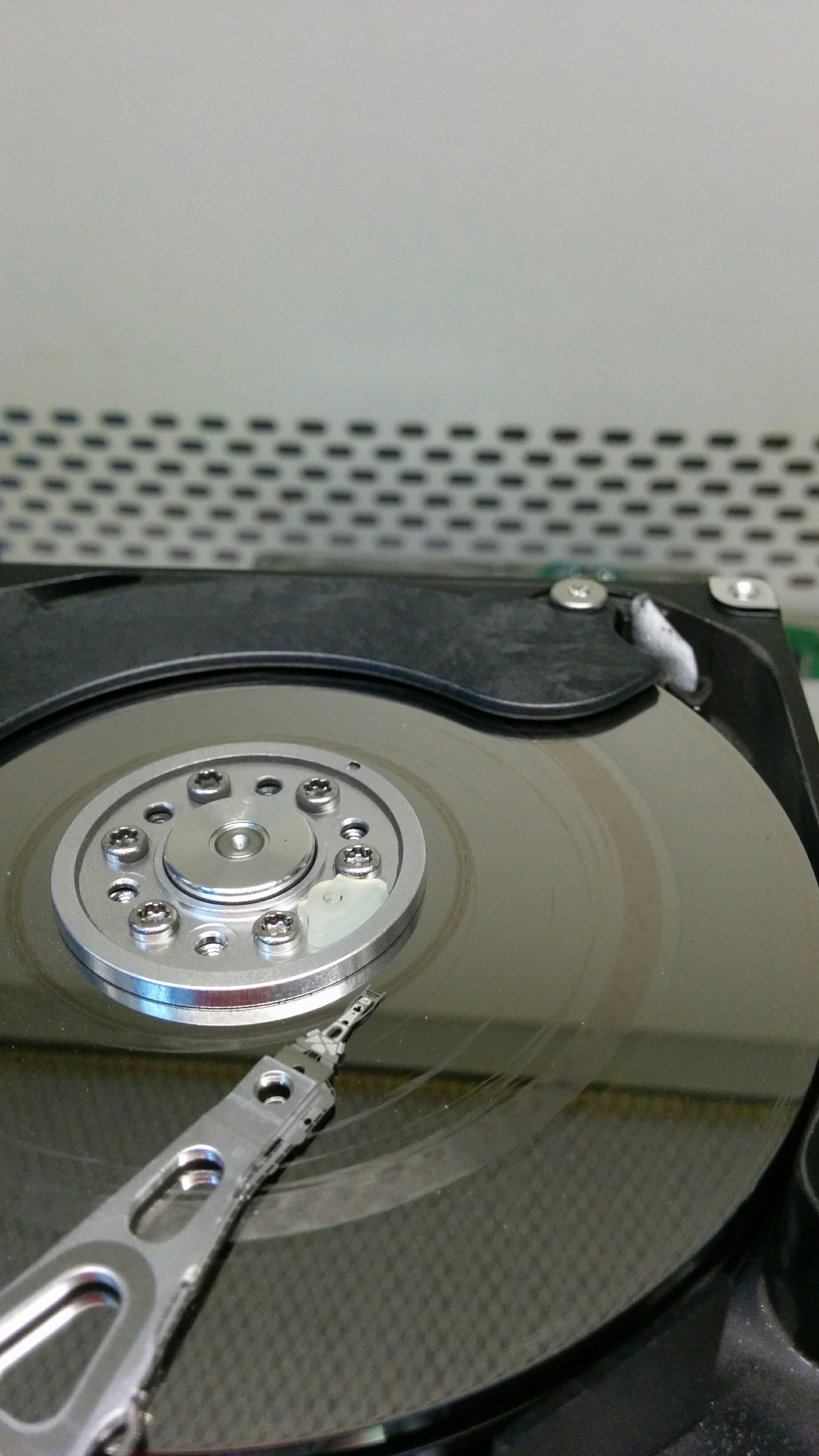

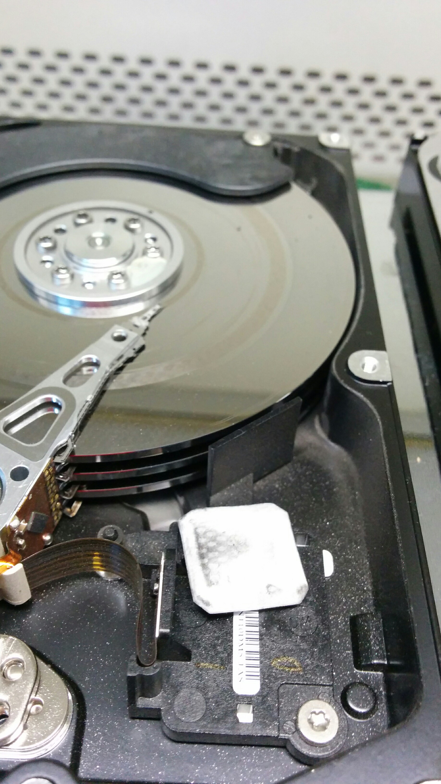

I got this case. Completely dead. Platters all FUBAR.

Yep, total lost cause. Nothing can be done for that one.

Of course, situation is not good, but I see only upper surface is damaged. I think, it's need to make diagonstic for other platters, because we keep hope for some result untill all system heads/surfaces are damaged.

Yeah, but SA location is scratched too.
If possible, it will take alot of donors/$$$$

We didn't see that :). System surface placed by 0, 1 and 2nd head (bottom part of platters stack). But I agree, case will be very hard (so can take several donors) or impossible.

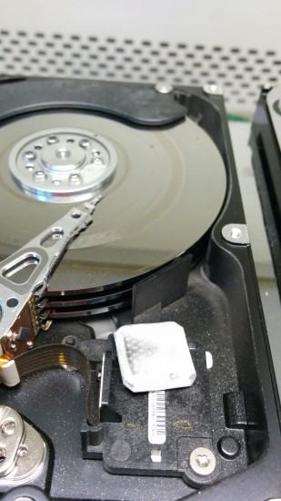

In my experience of this type of damage, it's usually a similar story for the other surfaces not just the top (visible) surface.
IMHO unrecoverable. :-(
