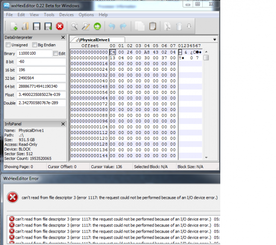

Everything about this drive seems normal, except for the I/O error. Bios detects, nothing burnt, spins up nice, size is correct, no corrosion, smart info would make you think it's new - just no logical access to the data or partition at all. I've never seen a failure like this before, so i'm blaming the pcb and not the user (me). The WD 1tb green is nearly identical to the one in the awesome "inside a Hard Drive" sticky article (wd10EARS), but mine is WD10EADS and the 8 pin chip is missing from it's designated home on mine. So please correct me if i am wrong in thinking that; my wd10eads is a level 3 HD, with bios on the platter, or inside the 4 sided chip, or both, and there is nothing I can do with brains, forum, and coffee to fix it. So i'm having to send it away to donordrive.com?

What if you open the disk with a Hex Editor? do you see anything there?

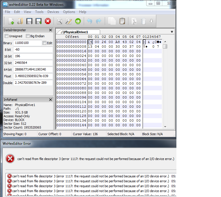

If that is your sector 0, it does not seem right to me. It's too "empty" (too many 0) and nothing about boot data.
I presume you've tried changing cables and physical port on your mother board?
Are you saying that you're not getting any SMART data even when it's directly connected to your computer via SATA? I read somewhere that a USB bridge interface could cause SMART unreadable. So it's best read through a direct SATA connection.
If your hex editor allows you to search through the whole hard disk, try searching for a filename that you know, assuming that this is not encrypted.

The drive is currently on internal MB sata header. Identical results with a second cable and alternate stat header. I have tried it attached to another pc too. I'm very sure the partition was ntfs. I have 2 other funtioning IOCell ndas drives of the same size that are working fine if we need to confirm. They are virtual scsi (or usb) and characteristics are as if they are attached to the motherboard.
A text search with the hex editor seems stuck in the mud without progress. Paging down is very sluggish, and sadly on the first few pages, other than the first two lines of data, it is all zero's.
