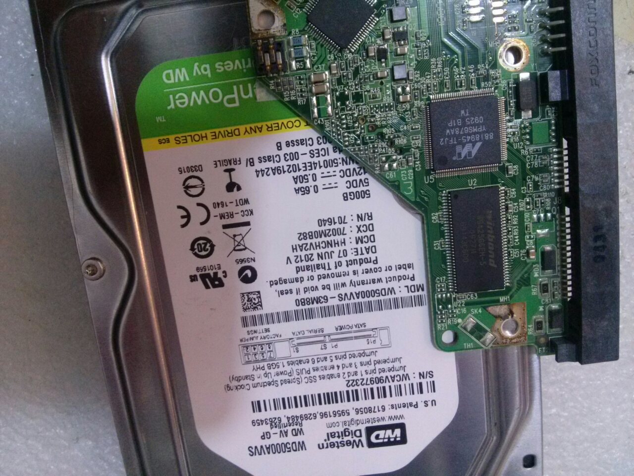

Hi
PCB of this hdd damaged and BIOS integrated.
I replace PCB with PCB same part number but can not solve problem.
what can I do?
Thank you.

what tools you have ?
can you access SA with new pcb ?
ROM can be rebuild from SA.
RAID/Server Recovery
 Post subject: Re: WD PCB damaged
PostPosted: April 6th, 2015, 11:34
If you have access to a PC-3000 you have two options.
1. Read the ROM via the Boot ROM Code utility (often works even for damaged PCBs)
2. Rebuild ROM from SA

Thanks all for answers.
I have MRT pro and will do your guide.
