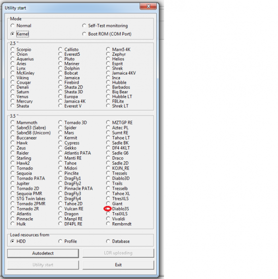

I have here some WD30EZRX-00D8PB0 drives.
Model : WDC WD30EZRX-00D8PB0
Serial : WD-WMC4N2756908
Firmware : 80.00A80
Capacity : 2 794,52 GB (5 860 533 168)
those 3 drives are brand new. i am trying to test it with PC3K but not recognized falimy drive.
on Mod C5 says DIABLO3S FAMILY BUT pC3k NOT RECOGNIZE IT.
witch ones must i select on PC3K? diablo3d? or others?
MOD C5

 Post subject: Re: You konow Family for WD WD30EZRX-00D8PB0?
PostPosted: November 3rd, 2014, 7:37
Joined: May 21st, 2007, 16:10
Posts: 1592
Location: Gothenburg/ Sweden
Yep, it's Diablo3S
PostPosted: November 3rd, 2014, 7:58
Posts: 811
Location: World
But in my PC3K do not apears Diablo3S family, the most similar family is Diablo3D
is need select on PC3K Diablo3d?

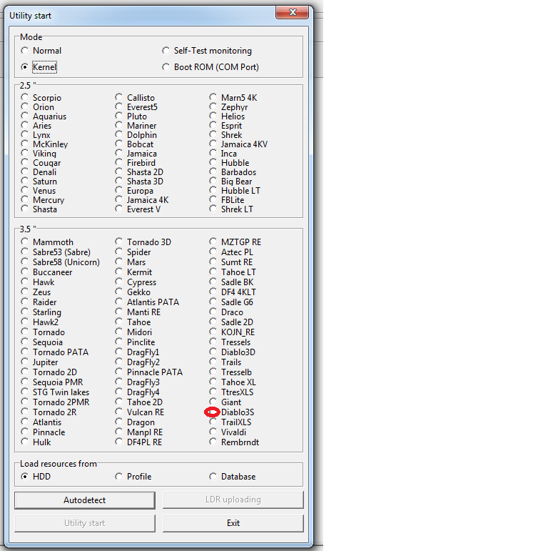

PostPosted: November 3rd, 2014, 9:42
Posts: 838
Location: Pakistan
latest version do have support for Diablo3S.
