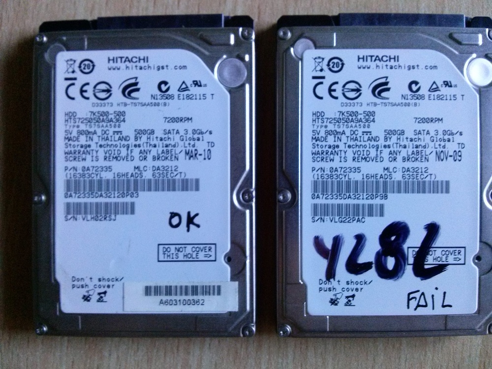

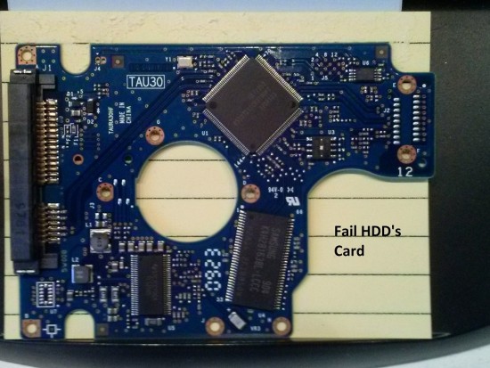

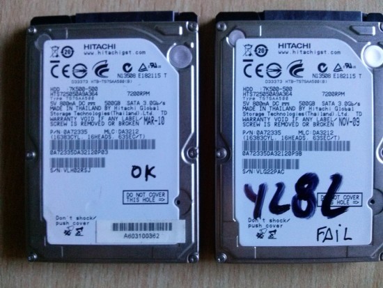

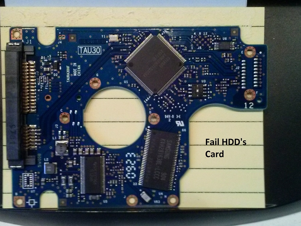

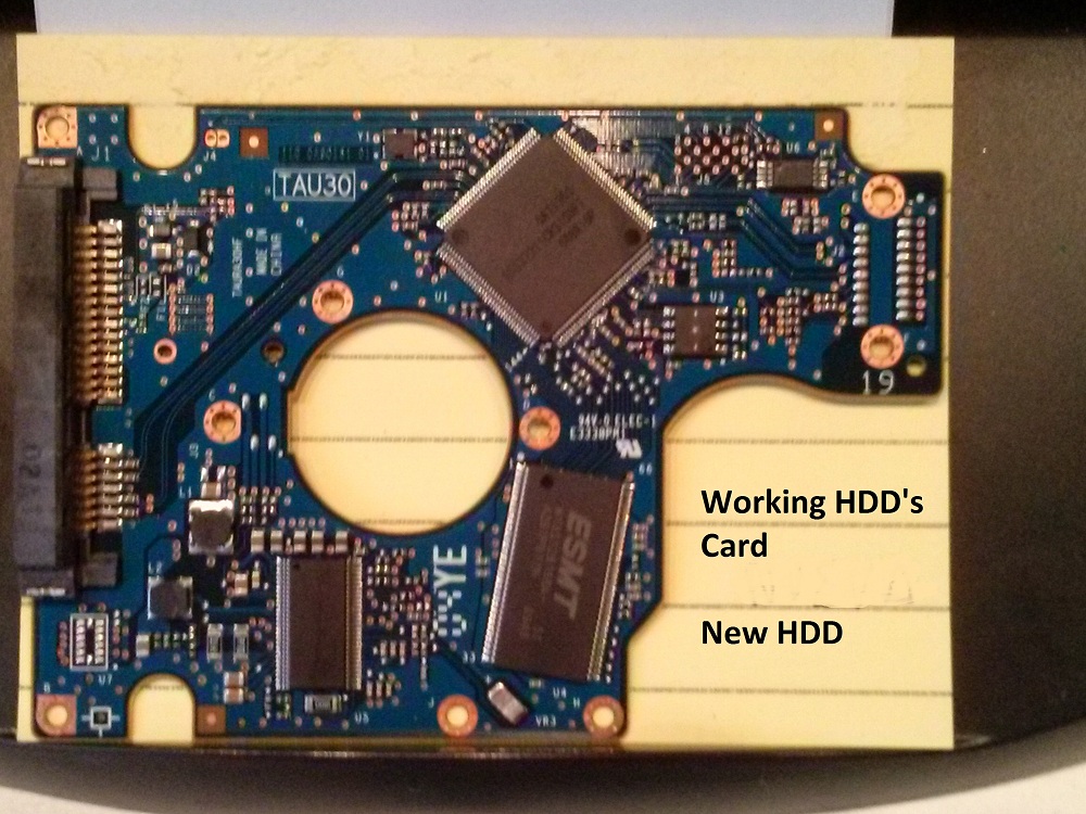

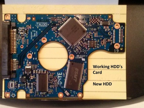

After some months I am back, I've just received at home the second HDD to use as spare.
Attached you will find the pictures of the two HDD and their cards identified as Failed and Ok/Working.
This is the state of the Failed HDD plugged into a PC's SATA connector after powering on:
- disk does spin, engine seems to be fine.
- very low beeps all the time,
- heads movements are not perceived,
- HDD is not detected by motherboard's BIOS in any way.
On the other hand, I checked and confirmed that the Working HDD is correctly detected by BIOS and works Ok, connected to the same SATA slot than Failed HDD. A louder beep is hear when powering on then heads move and the device starts working correctly.
Test#1:
I swapped the cards (see on pictures) between the HDDs and the result was the following:
- Original Failed HDD is still doing the same symptoms described above.
- Original Ok/Working HDD is no longer detected by BIOS either, and of course not working propertly.
So, after swapping cards, Failed HDD and Working HDD are both not detected by BIOS at all.

 Post subject: Re: Data Recovery from Hitachi 2.5 HD
PostPosted: March 17th, 2015, 15:23
Joined: December 9th, 2014, 19:57
Location: Argentina
I forgot to clarify that after the test#1 I swapped back the cards and everthing returned to the begining: Failed HDD keeps not working and OK/Working HDD returned to work perfectly again.
PostPosted: March 17th, 2015, 15:33
The reason it isn't spinning up is likely due to stuck or possibly short circuited read/write heads. I highly doubt it's the motor or bearing on that model. If your data is important, I'd highly recommend that you stop messing around and take it to a professional.
If it's not that important, and you just want to see if you can do it you should first try listening very carefully to see if you can hear a slight hum as the motor is attempting to spin. You'll need to stick your ear right onto the drive to possibly hear it. And you'll likely feel one area of the PCB (where the motor control chip is) getting very hot. If that's the case you may be able to free it up by opening it and gently spinning the cylinder counterclockwise while gently guiding the heads back to the parking ramp.
Again, you should not try this if the data is at all important. In all likelihood you'll only make the recovery impossible. In fact I've got a drive here right now that's a failed DIY attempt to unstick the heads and it's unrecoverable now.
