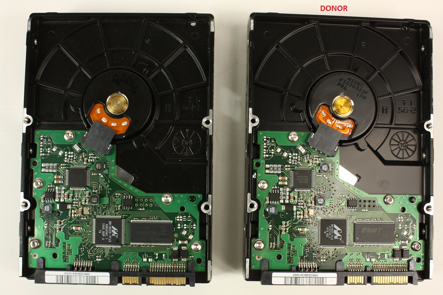

Hello!
I've got a 500GB Samsung HD502HJ with burned transil 6V8A,
(visually transil looks ok, but was shorted - tested by multimeter).
I have changed broken transil and tried to run HDD - nothing happened - no spin,
so I swapped ROM to donor PCB, also nothing happened.
In my opinion the ROM is dead.
Is there any possibility to find donor PCB with the same content of ROM?

zero - ohm resistor is OK - conducts.
ROM was transferred under temp. control on BGA rework station.
ROM from donor PCB was soldered back, donor drive is still alive.
I will try to read ROM in some programmer.

Yes it does, patient HDD spin up with donor PCB + donor ROM.

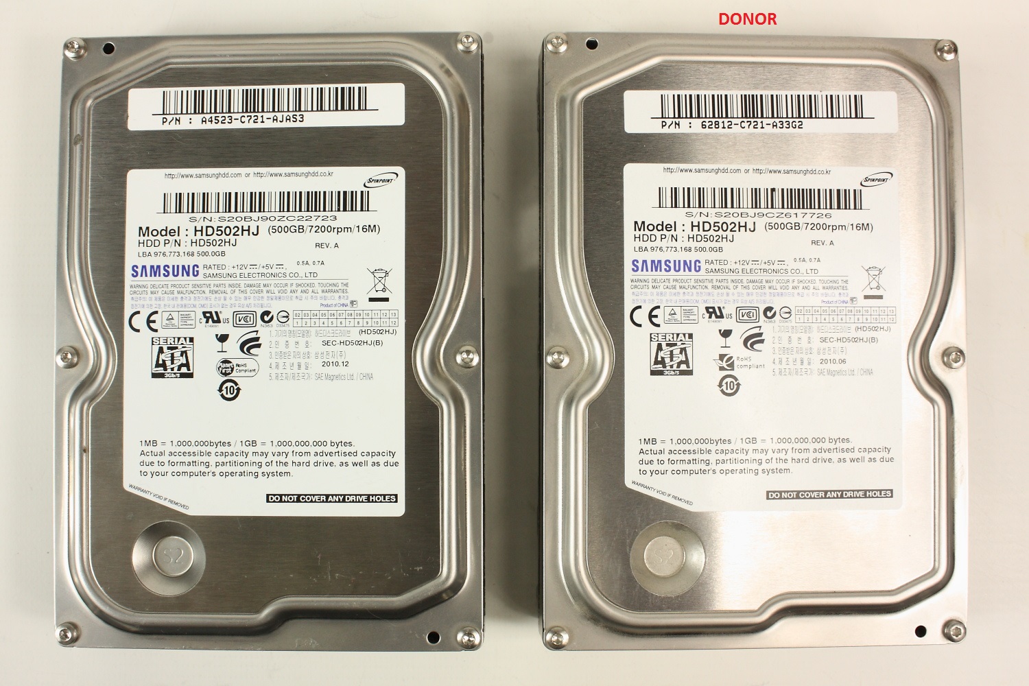

Problem solved
I found donor with compatible ROM - only PCB swap.
