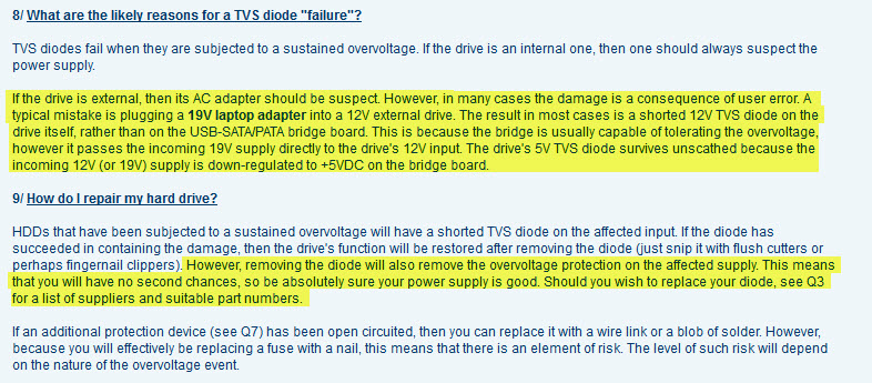

I think it's a voltage/PCB issue because I may have accidentally used a higher voltage adapter with the 5V port a while ago. I decided to open it up and check it out, despite being somewhat of an electronics noob. I heard that the TVS diode might have to be pulled out in order to get the hard drive working again.

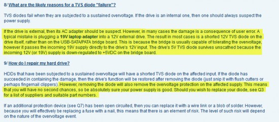

Diagnosis is usually the first step and your reasoning seems to suggest over voltage.
Better to be sure though before ripping anything from circuit boards.
Be warned too that if any protection device is bypassed and there is still a a fault, then the next thing down the line will likely fry too often with more severe consequence. For example one should never replace a blown fuse with a metal pin.
there's quite a good background write up here
http://community.wd.com/t5/Desktop-Mobi ... d-p/250274
regards
Kern

hdd2015:
check the write up first if you can.
The power problem usually gets by the diode in the case and blows the 12v one on the drives cct board.
Whatever, be sure that if you use the PSU supplied with the usb case, ensure it is trustworthy before snipping any protection off the hard disk itself.
I have one in here at the mo, and as per the writeup the diode on the case cct board is still good whereas the 12v on the drive tested bad.
If you can't grab a picture, at least see if you can find the make and model of the drive, as fzabkar requested, it would give someone the opportunity to point at things.
Alternatively as pcimage mentioned, maybe plug directly into an IDE equipped motherboard.
The usual symptom, if it is a blown tvs, is the PC will kick start briefly before the PSU protection sets in.
If so, then remove the diode, carefully.
the usual jurisprudence applies, don't be blowing anything valuable up in the process :)
good luck
Kern
