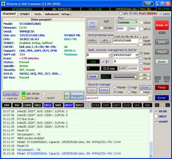

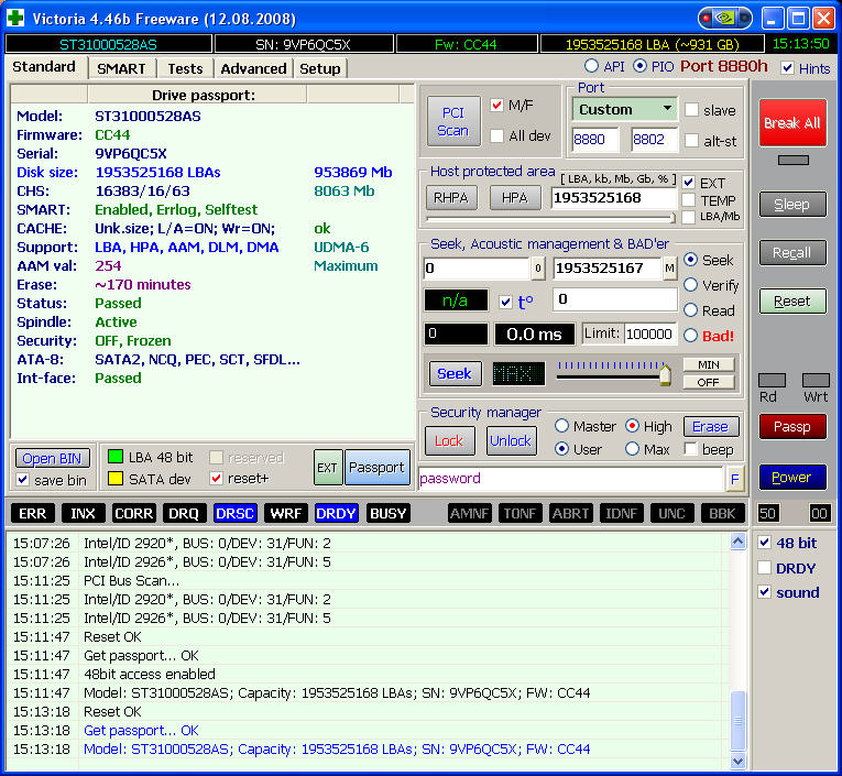

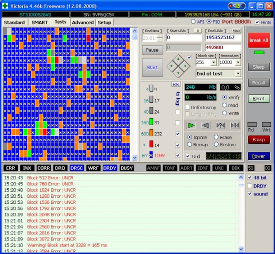

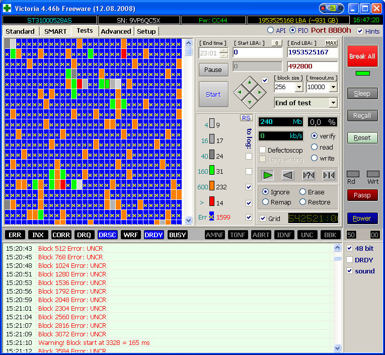

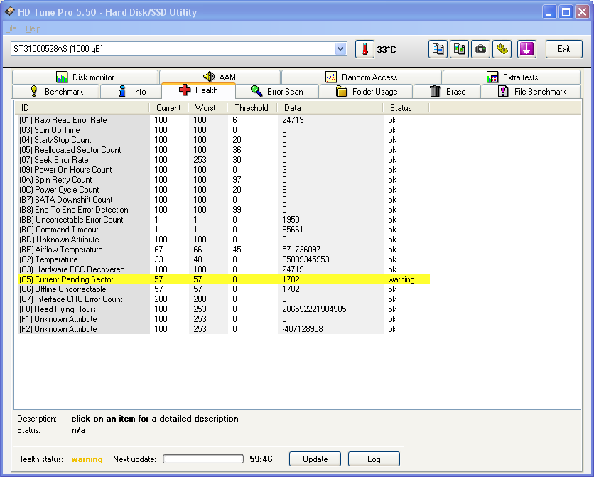

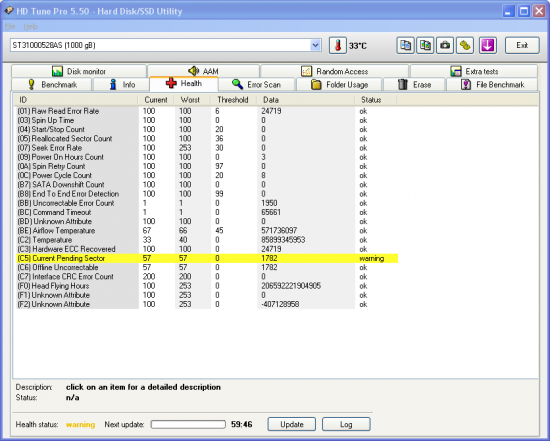

I did some victoria scandisk, and the SMART result after the scandisk:

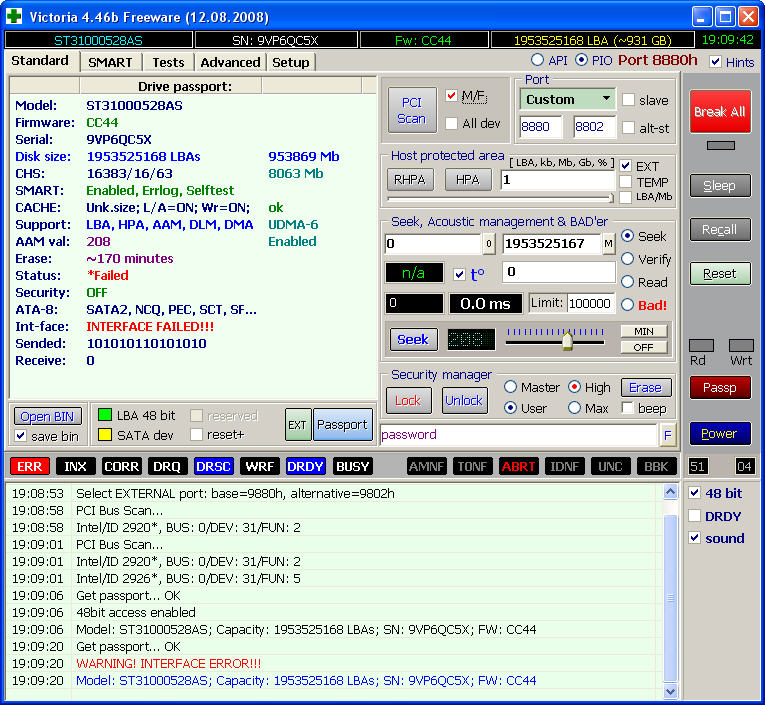

I dont know which command led me to this result, now i have this when i connect the HDD with sata data cable:
Jumping to Power On Reset▒
Rst 0x20M
(P) SATA Reset
PASS
RW: Error processing Performance Parameter File: 203C
(P) SATA Reset
PASS
Send Status: COMRESET seen
ABORT!
SenseCode = 03310000
ReadyStatusFlags = 0002A1A5
ABORT!
ABORT!
ABORT!
ABORT!
ABORT!
ABORT!
ABORT!
ABORT!
ABORT!

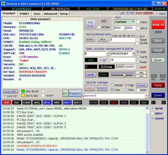

Also i have no more SMART table access, i can detect the drive into Victoria, but now it gives me this:
Do you have any idea wich CULPIT command did this?

warnerr wrote:
No I don't know. Damage is increasing exponentially. Perhaps time to open it up and clean platters with CRC spray. :lol:
Yes, but i did mistaked with terminal commands. But no problem because i dont care about this drive, it's just a playground for 7200.12 type for me.
I wonder if there is a copy of the most important module into the F3 arch? So i can just restore them to go back to initial point?
warnerr, you said you have invested 9000$ in a DR lab, just curious what did you buy for this money?

-Performing commands you don't know is one mistake.
-Not Documenting each step so you actually know which changed your drive is another.
-Spending hundreds of hours reading all over the web, while obviously exaggerated, is another. Reading is one part, experience is key.
-reading tons and tons about this trap is overkill. Almost every tutorial on the 7200.11 fixes start with "Do Not try this on a 7200.12", yet you still did it.
-Wanting to "fix" a drive no one in their right mind would ever use for data is another.
-not listening to Pro's is another.
If I drain the oil out of my car and run the engine until the con rods smash out the engine block, I can flatten the battery trying to start it. So I ask a Pro and he says my engine is dead. get a new one. Do I say, no, I bought new battery and now the engine turns over so it must be nearly fixed?
just because you hammered commands into the drive, and now terminal says something different does not mean you have got it on the way to being "fixed".
What criteria are you using to decide the Pro's don't know what they are talking about?
I would be interested to know what, specifically, you have actually learnt so far. Aside from don't apply 7200.11 fixes to 7200.12 of course.
Anyway what evs

int0x13 wrote:
DATA IS NOT IMPORTANT, JUST WANT TO FIX IT, I DONT CARE AT ALL ABOUT THE DATA.
The hddguru forum gets a lot of posts like this to make it look like the data is not needed when it actually is. Posters are more relaxed about answering posts where data recovery is not in question. I have to ask myself what is purpose of your post. You obviously have a drive that is failing and have zero knowledge on how to fix it. Are you expecting to become an expert overnight? Maybe? Why are you running random terminal commands on the drive? Who knows why... It just doesn't add up and I truly believe this is misinformation. Nobody in their right mind would spend almost an entire month fixing a broken drive to reuse it. Send it to a professional or buy a new drive.
