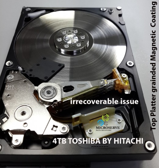

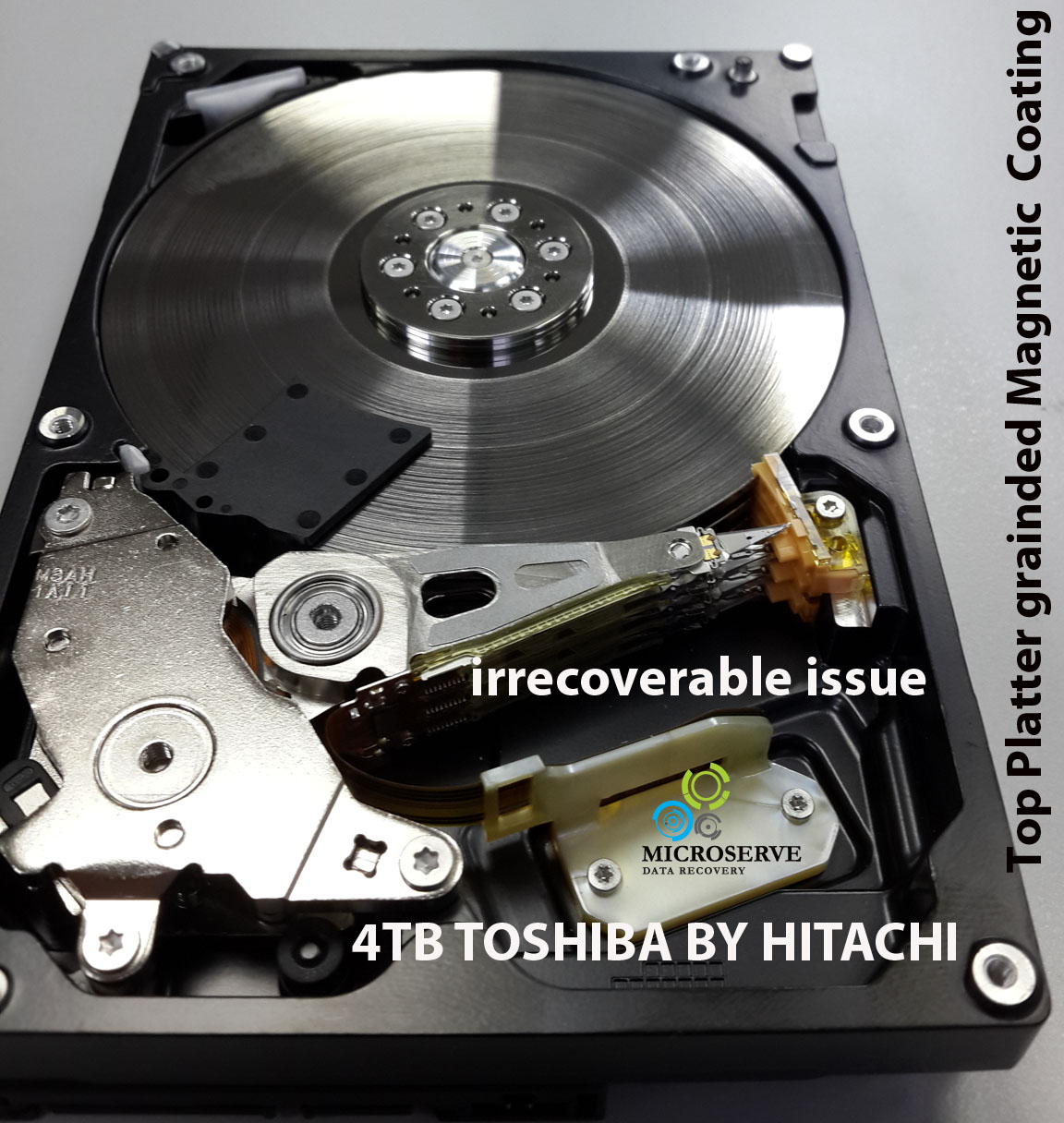

One of Our Data irrecoverable Case Dairy-Toshiba 4 TB as per user statement suddenly get Problem as not detecting.

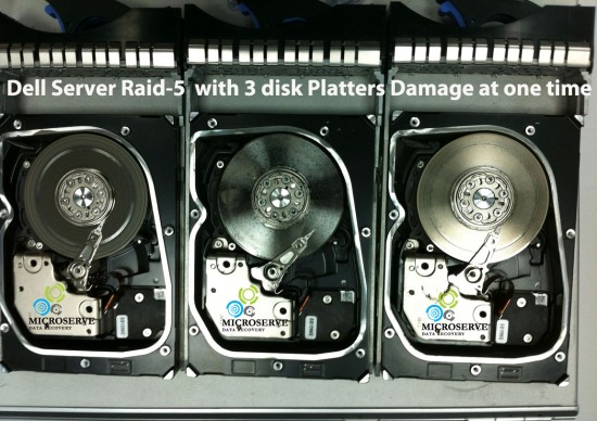

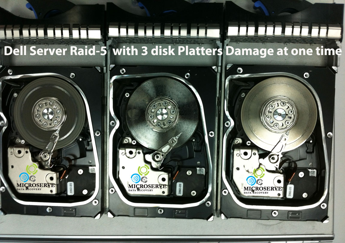

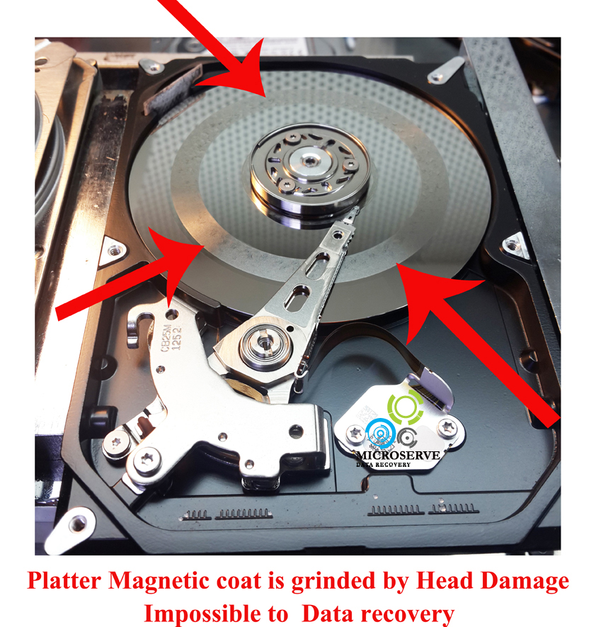

One of Dell Server 3 Disk Platter damage at one time.
 Post subject: Re: IRRECOVERABLE ISSUES BY PLATTER DAMAGES
PostPosted: October 13th, 2014, 4:46
Posts: 811
Location: World
Good example of irrecoverable case.
Sometimes is difficult for customers understand why data is not recoverable, but in this case normally they understand it

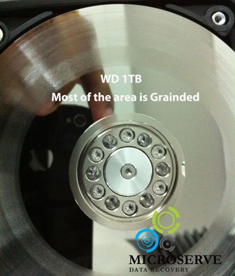

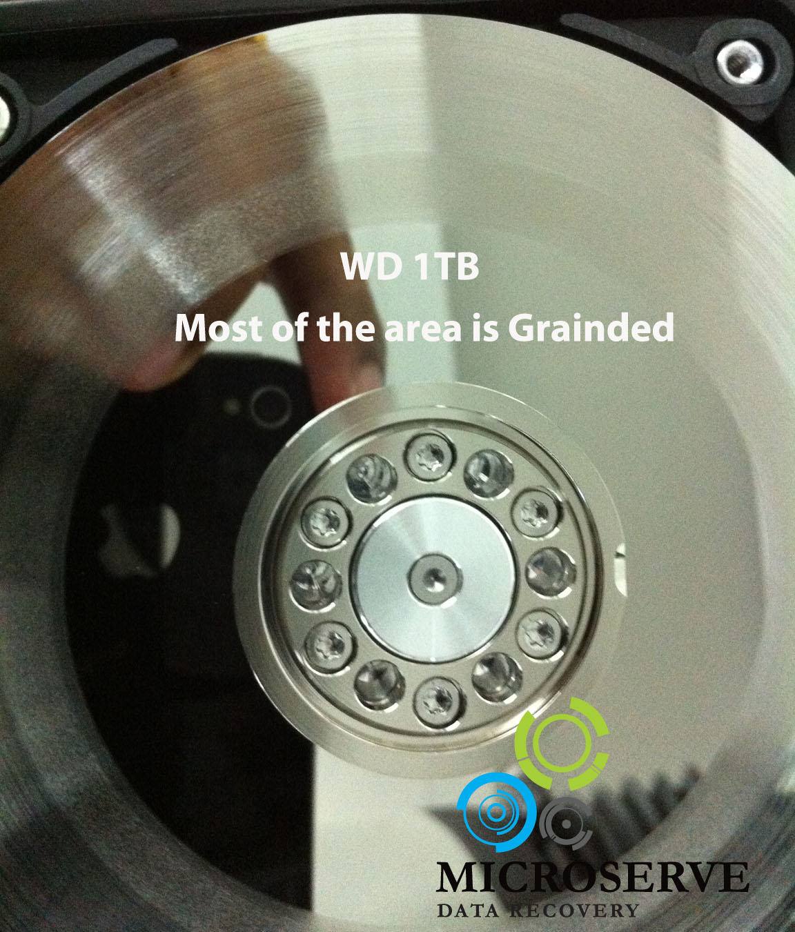

WD 1 TB

exactly you are right sir.

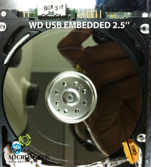

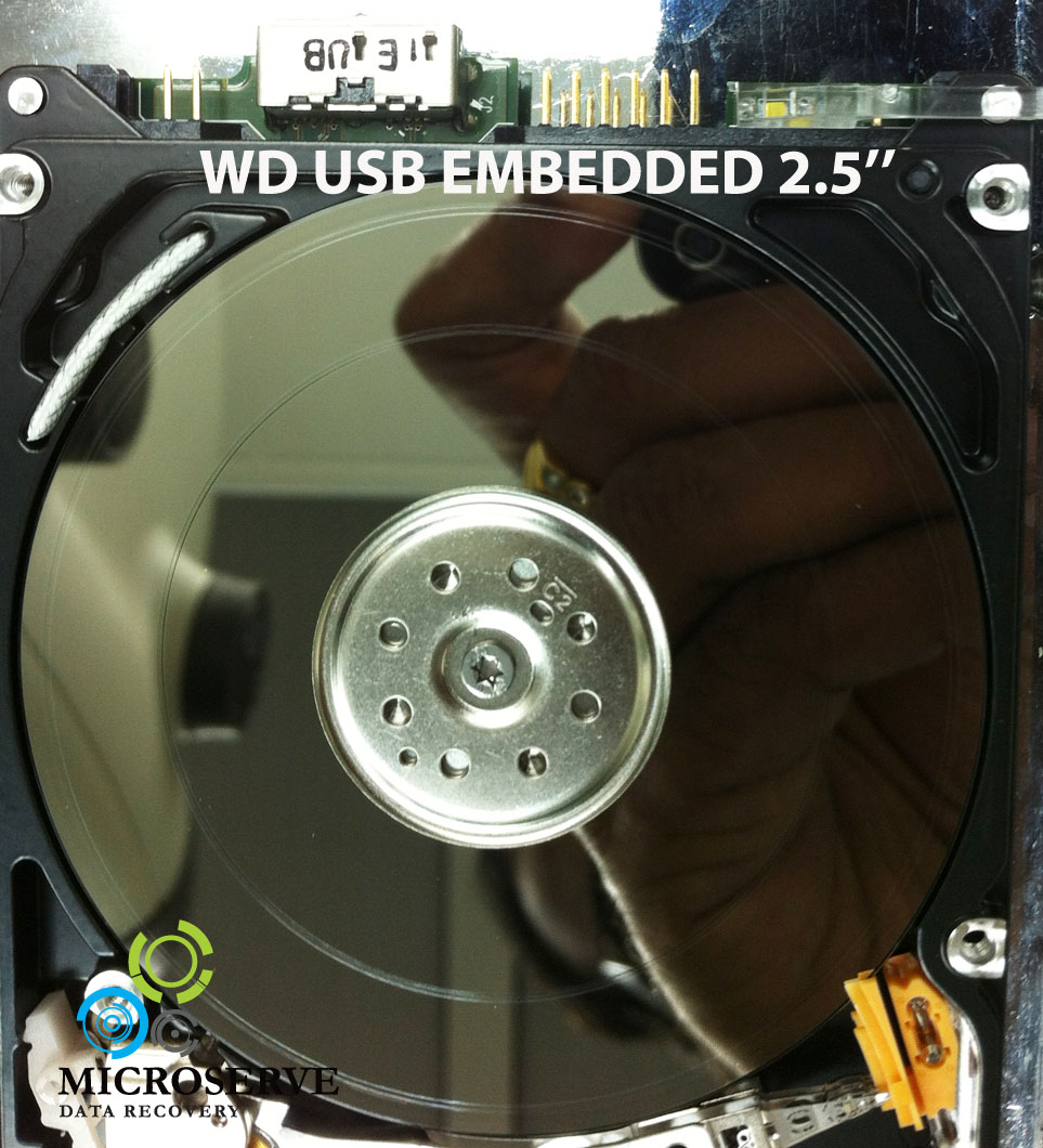

WD 2.5'' USB EMBEDDED HDD Slight scratch But irrecoverable

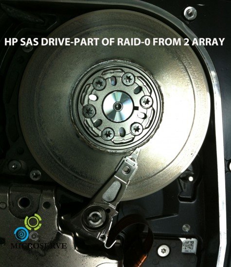

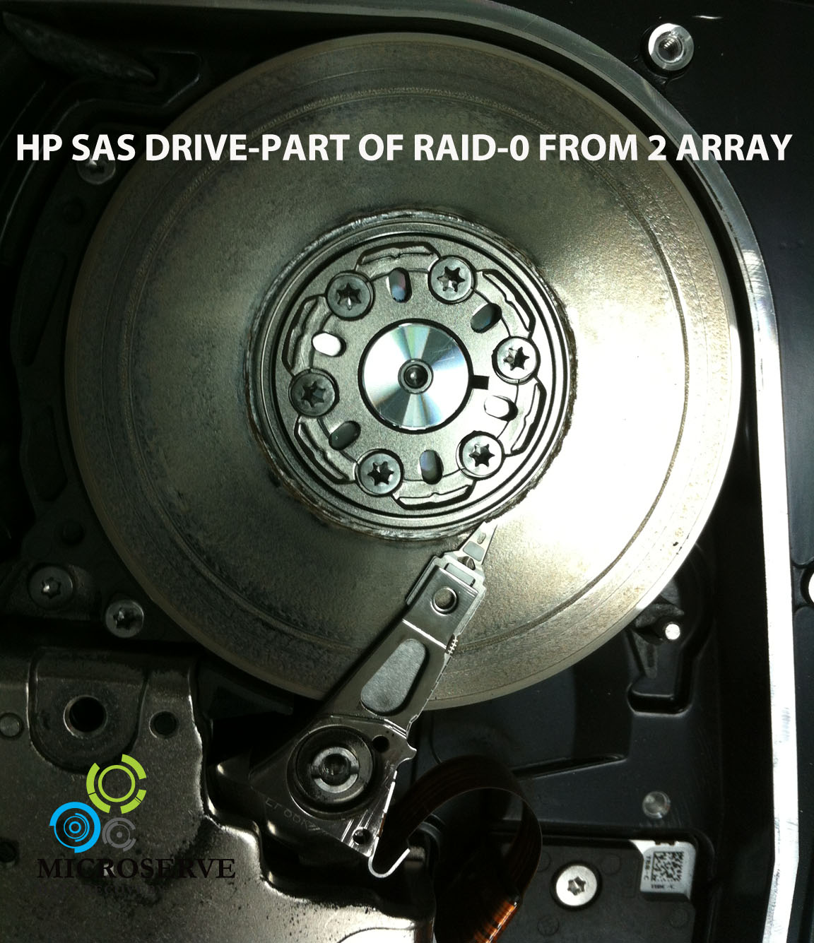

SAS RAID-0 ARRAY MEMBER

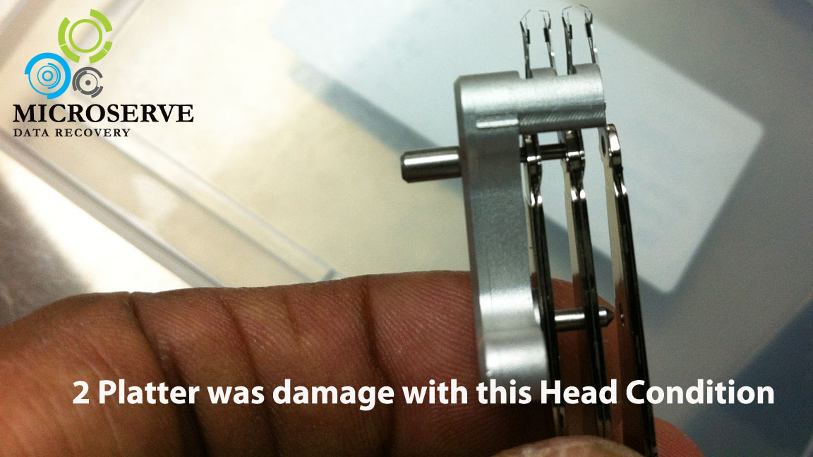

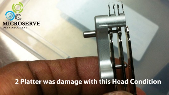

How Head comes like this..but 2 platter was damage with this head

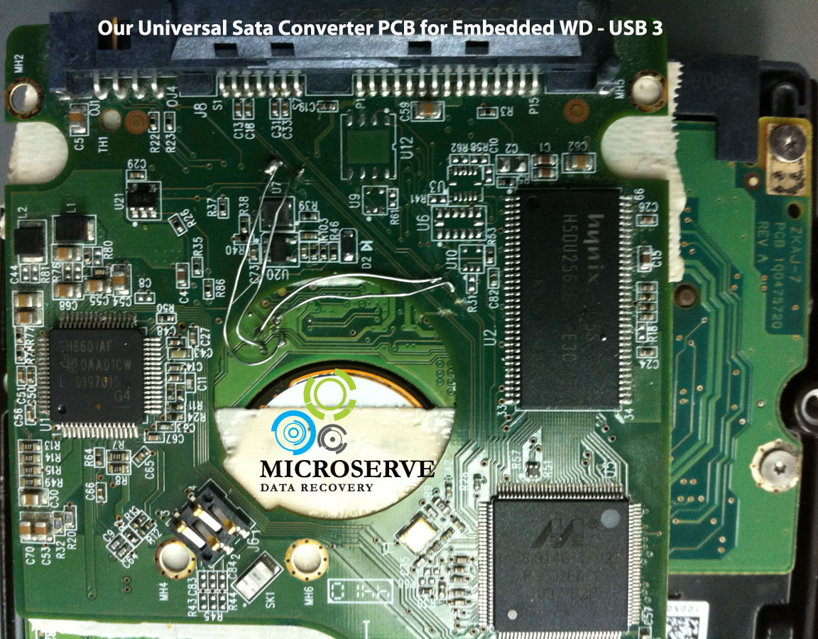

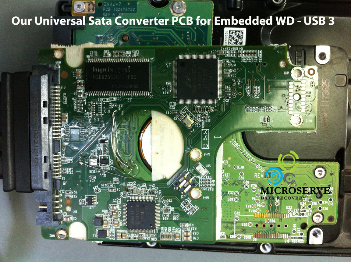

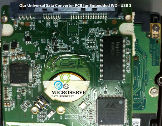

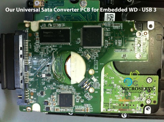

Our Universal Sata Converter for WD Embedded USB-3
PostPosted: October 13th, 2014, 6:14
IF it is only this surface, this can be recovered partially with no guarantee (if and only if it is a vital case....) but requires a lot of intervention - let alone encryption. The other are not.
PostPosted: October 13th, 2014, 6:36
Joined: September 25th, 2014, 3:26
Posts: 66
Location: Qatar
the case is over.this was not possible with guarantee.we confirmed earlier it is not new current case sir.Thanks

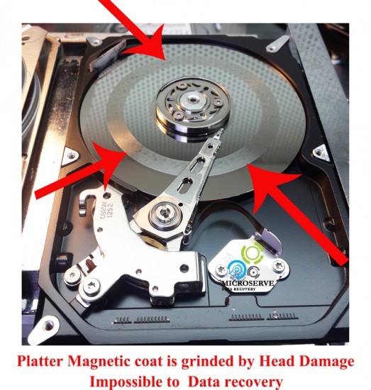

Toshiba New Case IRRECOVERABLE ISSUES BY PLATTER DAMAGES
