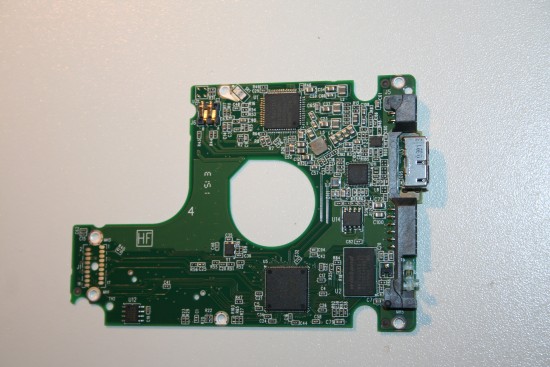

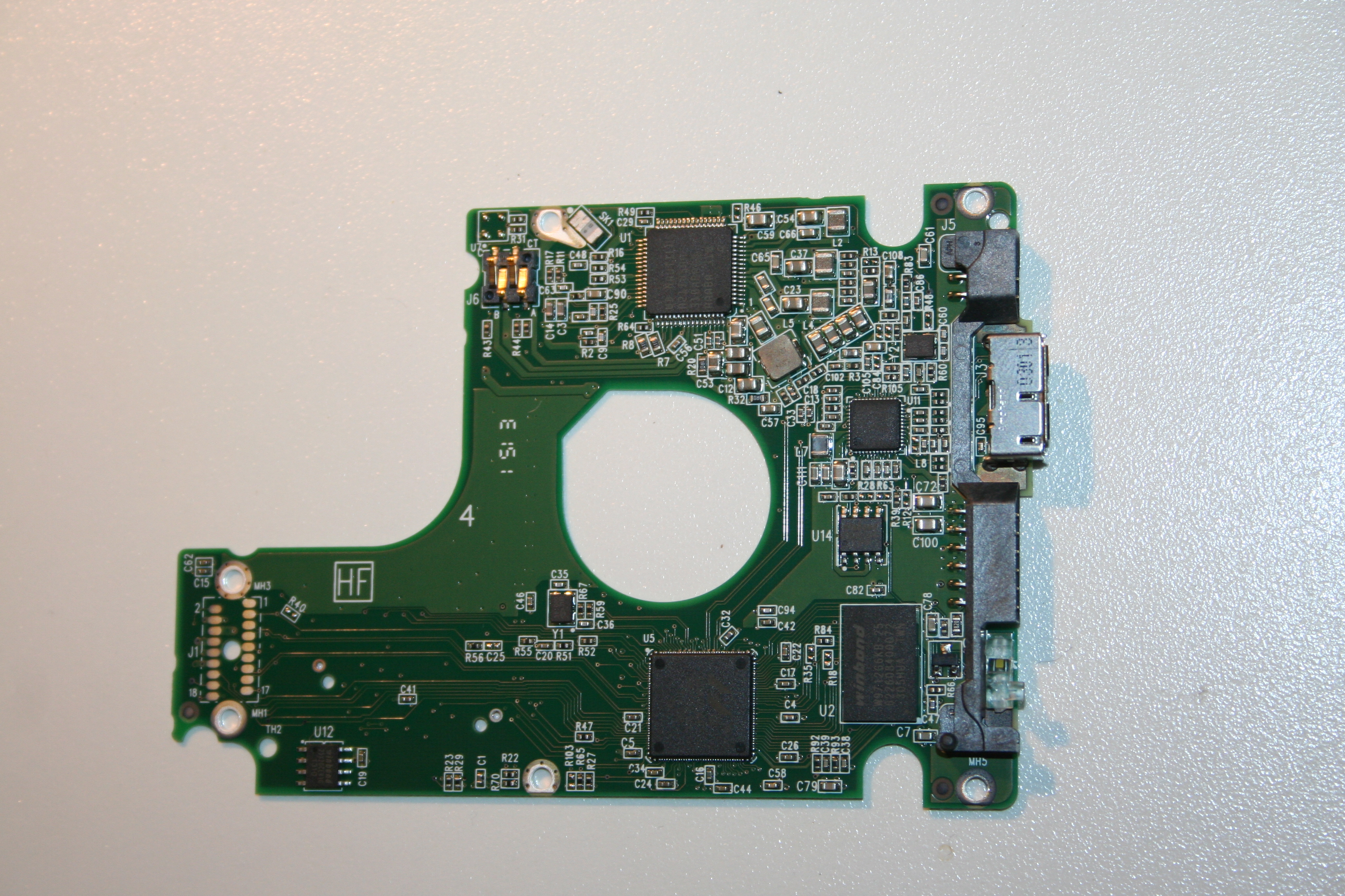

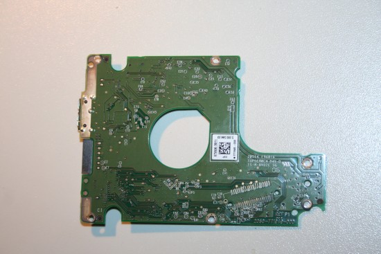

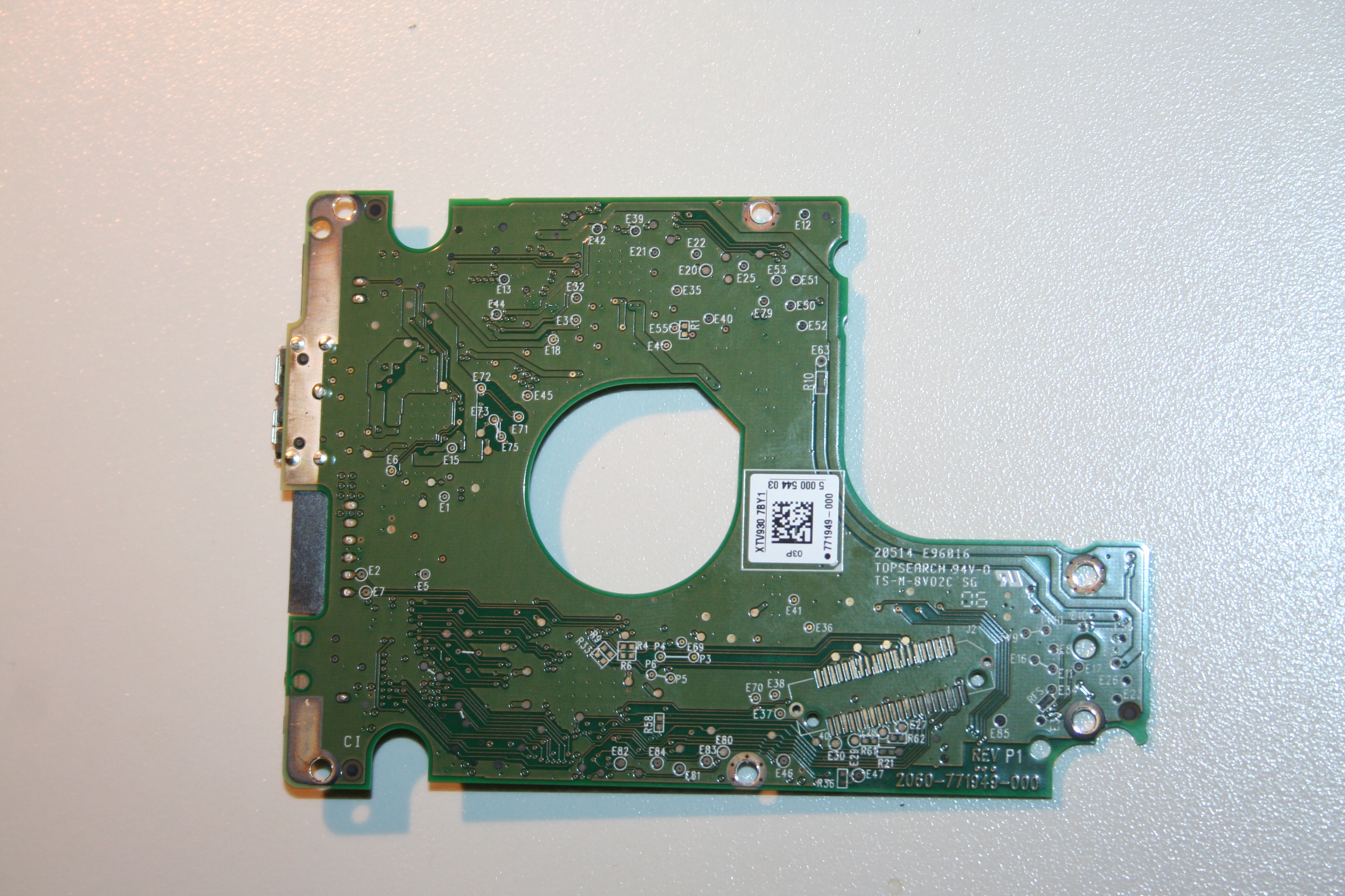

I have a patient WD5000LMVW, DCM: HHKTJABB, DCX, CV07E3TD, with usb-port on it. Which one should be suitable donor pcb for this one?

upload the picture of pcb both sides

Here we go.

Solution found, case closed.

For anyone else wondering the compatible SATA board for this one is 2060-771959
