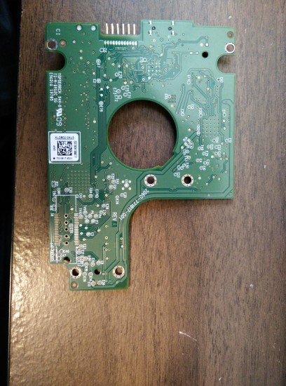

From what I understand the board should already have SATA connections leading from the bridge chip to the main MCU could you upload an image of the PCB board? someone here should know the connections you can use to make a SATA connection without buying a whole new board.

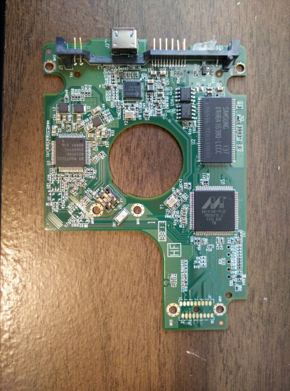

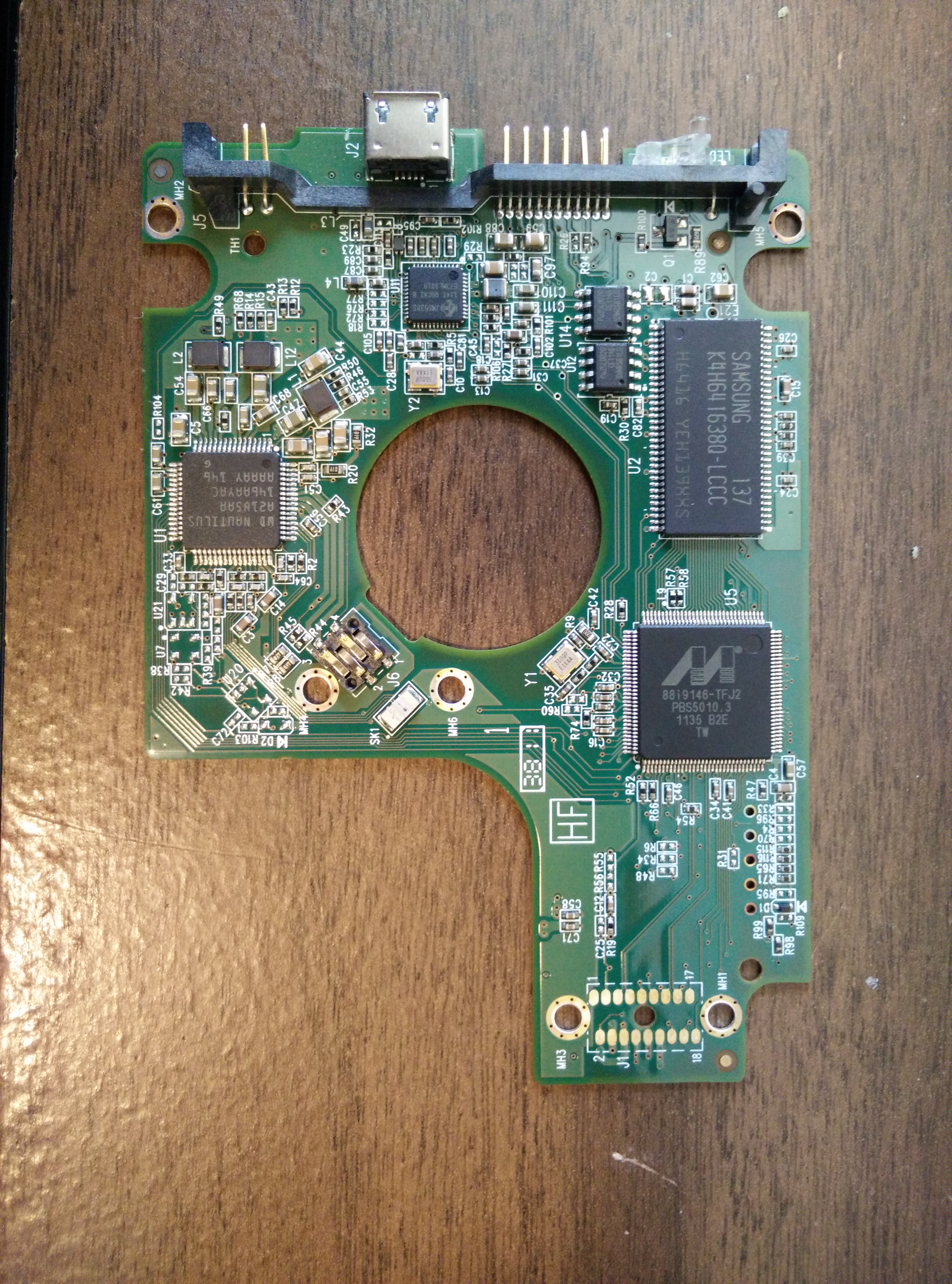

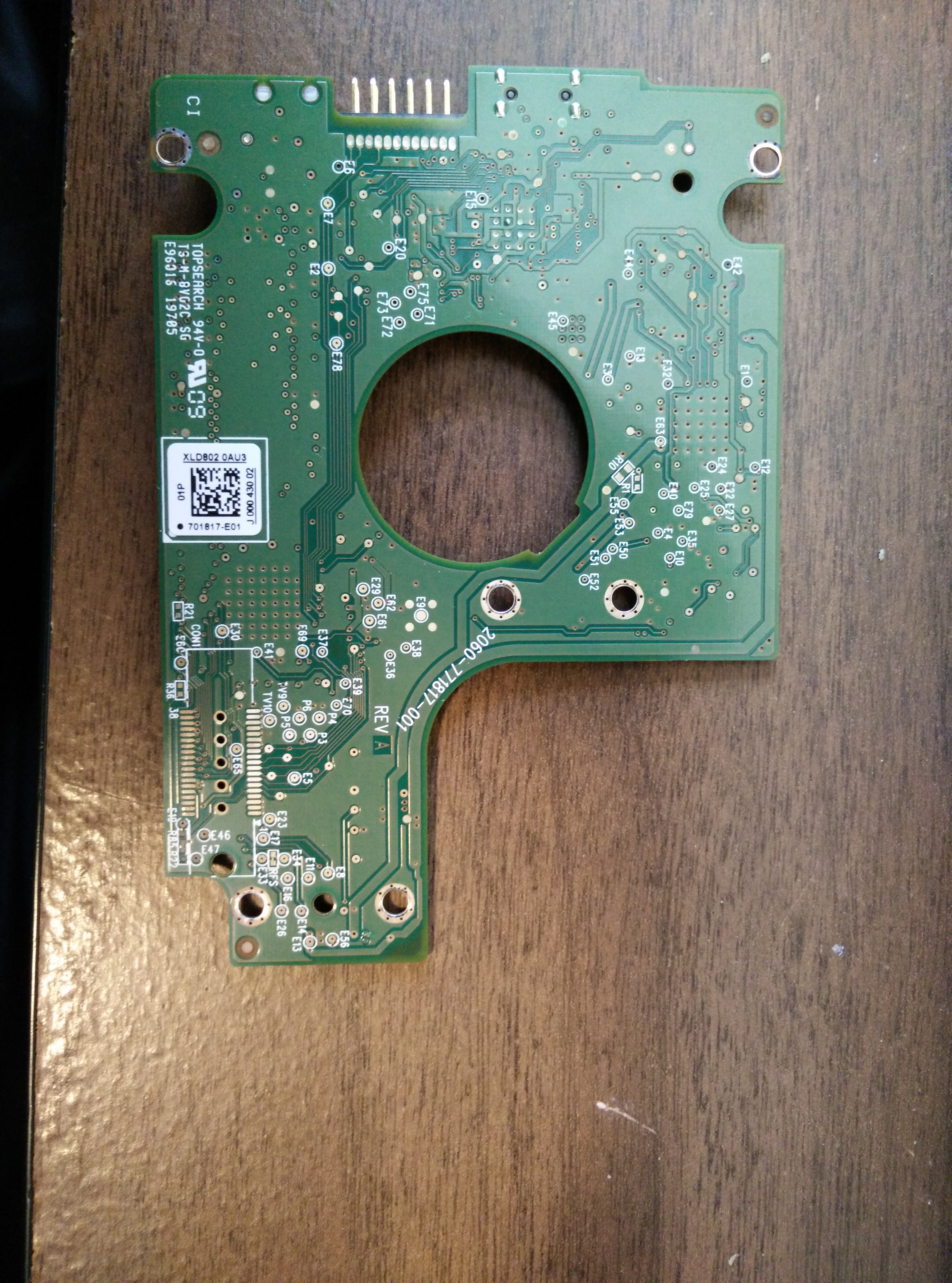

Here are front and back images of the PCB.
Back:
Front:
It's just a damaged USB port so if I was going to use the existing PCB I would probably just remove the existing USB port and solder on wire leads to that location rather than try and tap the SATA bus before the bridge. I just think it might be more time effective to swap the board for a SATA board than to go through the hassle of trying that.
Thanks!
-Ben

Did anyone manage to find a matching SATA board for this drive. Its not on Ace Labs new list. MCU is 88i9146.

ISTM that you should be searching for a PCB with the same MCU and motor controller (Nautilus):
http://www.google.com.au/search?q=nauti ... J2%22+2060
How about this one (2060-771820-000 REV A)?
http://ep.yimg.com/ay/yhst-144375849714 ... 2601-1.gif

Hey, fzabker: I was just writing this as your reply came through. I did find this exact board in my donors and it is a good match. This was from a WD5000BPVT. Thanks for the reply.
