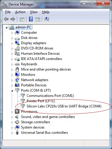

Hey guys, I bought this adapter from eBay:
http://www.ebay.com/itm/400524483249?ss ... 1439.l2649
I got the drivers installed and i set it to COM1 on my pc and downloaded the ZOC software. For some strange reason, it can't find my COM1. It's working on my device manager but it just don't detect it with the ZOC terminal software. I set the com1 to 38400, 8N1, with no flow control.
Is the adapter I bought the wrong one? It looks like it should work with the GND, TX and RX connectors and I plugged it into the HDD according to this picture:
http://malthus.zapto.org/viewtopic.php?f=6&t=193
 Post subject: Re: Seagate Momentus Thin ATA Unlock Possible?
PostPosted: December 5th, 2013, 23:19
Posts: 4022
that adapter should be perfect.
When you plug in the adapter, you will see in device manager what com port the adapter is. that is the com port you use. Doesnt matter what your comport is numbered as lon as it is the one windows gave the adapter.
38,400 8N1 is correct.
make sure you connect it like:
PC-------HDD
GND-----GND
TX------RX
RX------TX

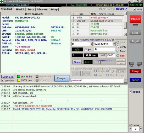

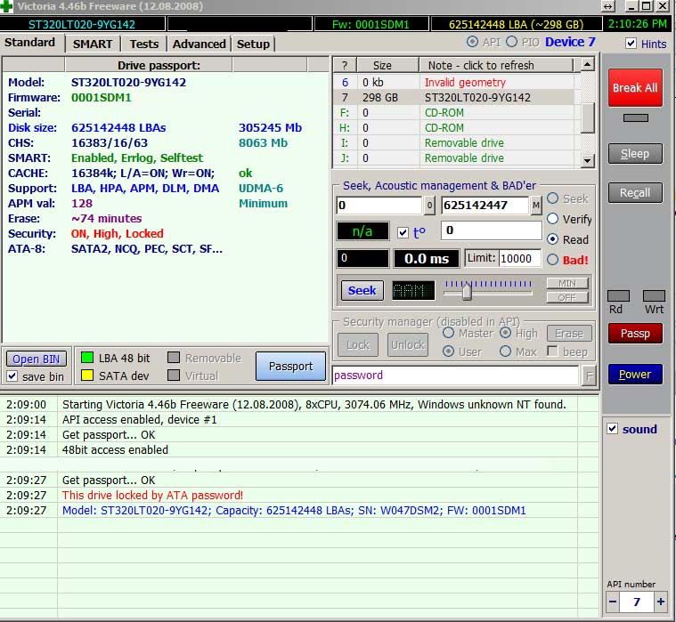

I just ran Victoria on the drive and it says that the drive is locked with ATA password. I'll attach a screenshot of the program results.
PostPosted: December 8th, 2013, 14:20
Posts: 927
Location: uk
Thats right! The script has dumped the password for you as a bin file. So now all you have to do is load the bin file into Victoria for Windows and click unlock.
You need to set up the drive in PIO mode. Click on the 'F' next to the password box. Load the bin file and then unlock.
Job done and many thanks to Moltke!
