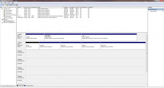

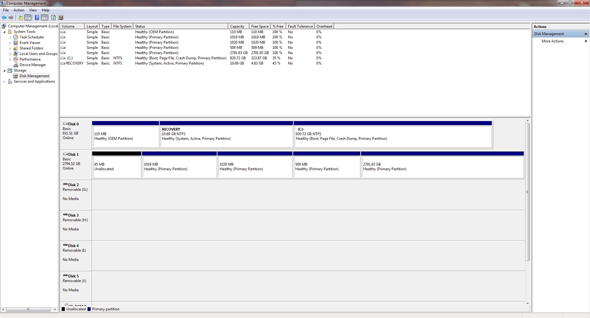

I cant mount/retrieve the data inside the hdd. This hdd previously is used on a NAS storage. Any clue on how to retrieve the file?
Refer the image below, my computer can detect the drive. However, there is no 'file system' being detected by windows. The window using are window 7 Ultimate.
 Post subject: Re: Recover data that cant be detected in windows
PostPosted: December 11th, 2014, 8:42
Posts: 3551
Maybe the data are encrypted.

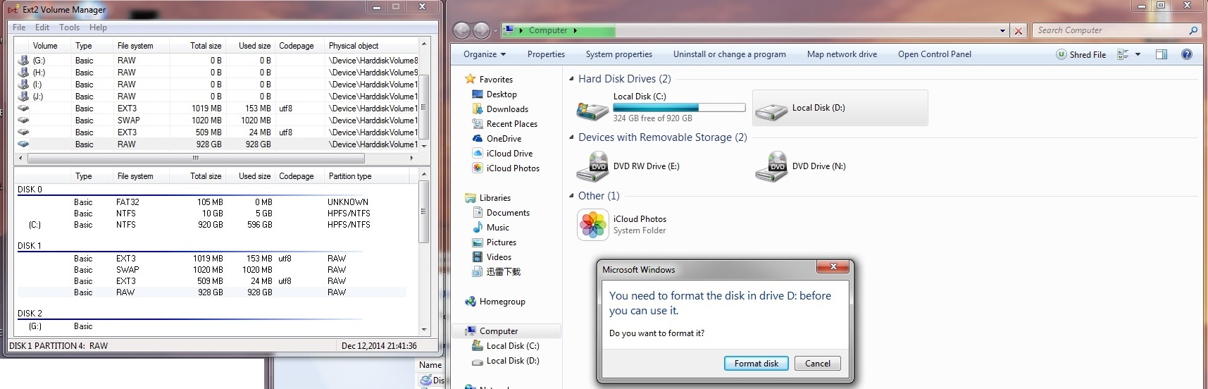

Must guess as you didn't mention NAS maker: Most NAS are in EXT2 file format. To mount that type file system to windows use a product such as ext2fsd to begin.

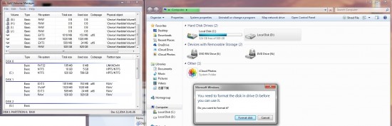

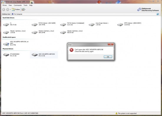

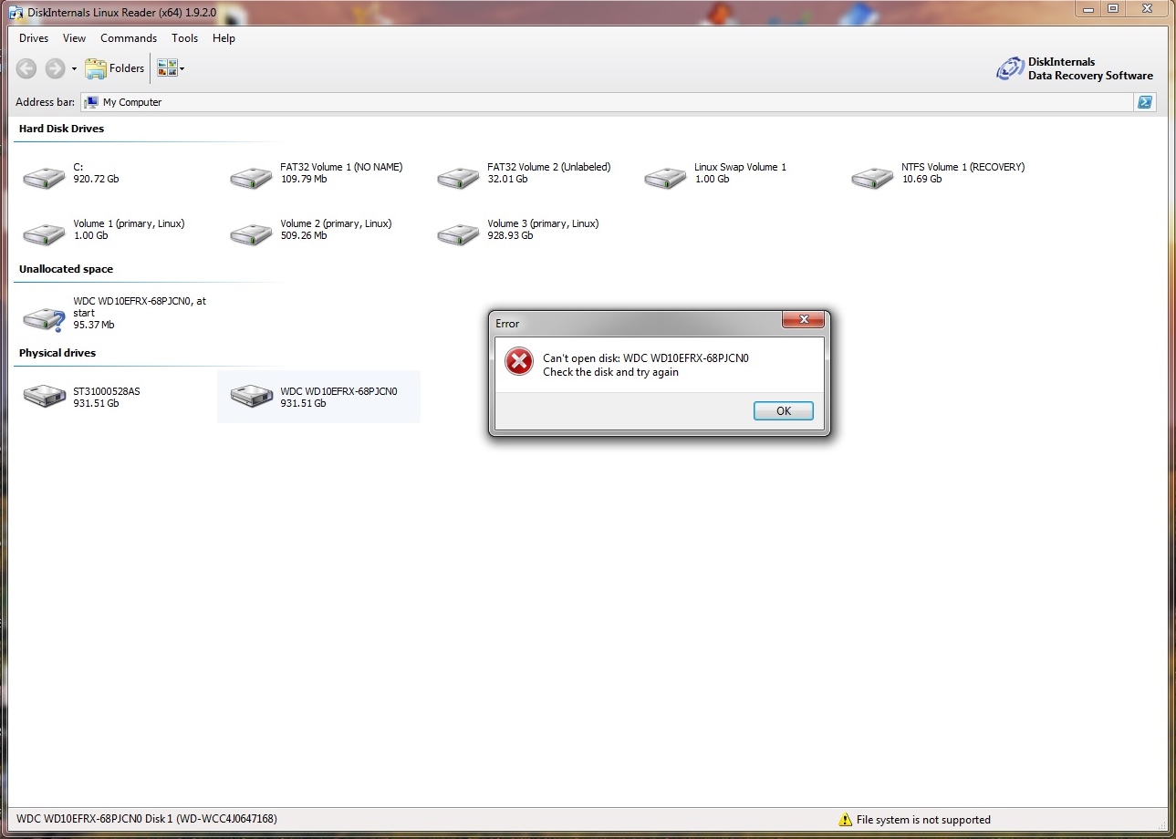

The maker of my NAS is seagate. The model is BlackArmor 400. I tried to mound using ext2fsd, but i cant access to the HDD. Check the picture below. I still cannot access to the drive.

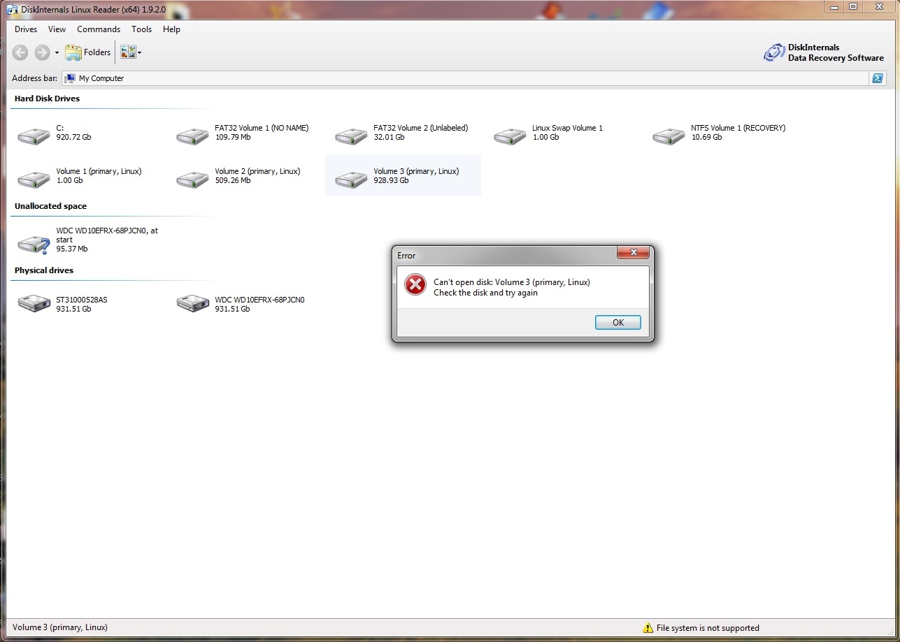

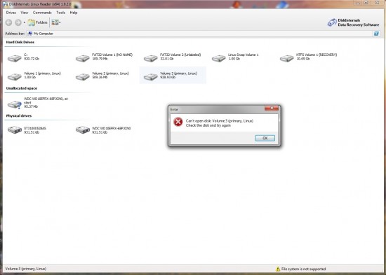

Try Linux Reader for Windows (freeware):
http://www.diskinternals.com/linux-reader
I got the error message as attached.
