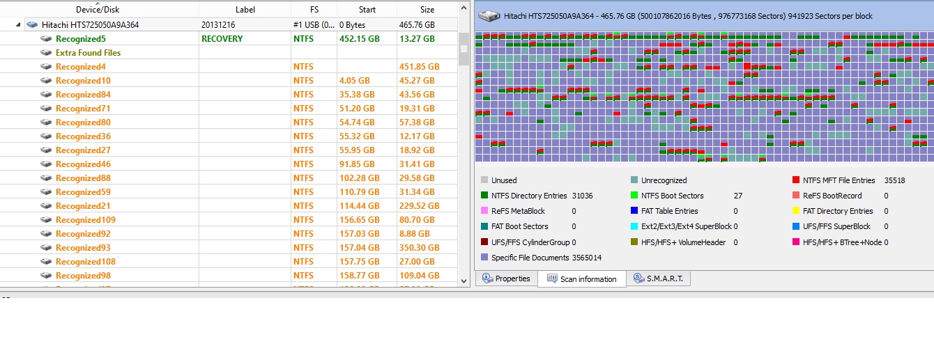

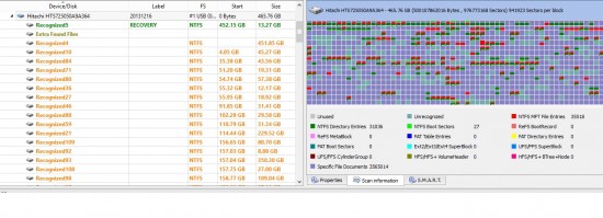

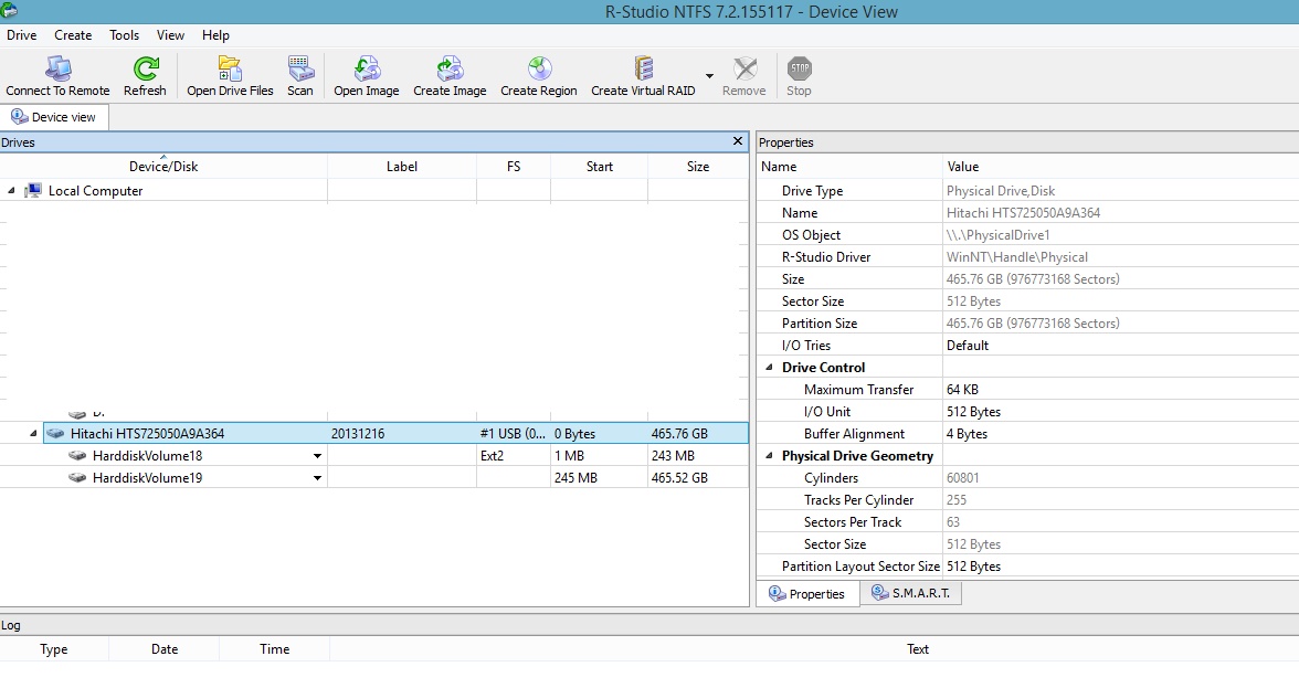

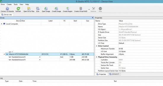

Hi All,
I purchased R Studio, attached the HDD using a SATA USB adaptor and ran the application. As you can see from the BeforeScan.jpg file, it shows Hitachi... After I ran a scan at the "Hitachi" level, it shows me so many "recognized" disks (see AfterScan.jpg). When I tried running a scan at "HardDiskVolume" level, again it is starting to list many "recognized" disks. Can someone tell me how to go about it? At which level should I be running the scan? The help manual isn't very helpful.
Thanks.

 Post subject: Re: Hard disk recovery
PostPosted: December 23rd, 2014, 16:23
Posts: 360
Location: Toronto
If you had only one partition on the disk, you may look into the Recognized4 partition.
PostPosted: December 24th, 2014, 13:23
Joined: December 20th, 2014, 5:45
Posts: 6
Thanks. I had 2 partitions previously - (1) HP recovery partition and (2) C drive.
PostPosted: December 24th, 2014, 15:43
Posts: 360
Location: Toronto
Yes, and R-Studio found the recovery partition (the green one, Recognized5). I think Recognized4 was your working logical disk.
PostPosted: December 25th, 2014, 14:57
Posts: 6
Harddiskvolume19 showed some green coloured Recognized partitions. And I managed to recover some files from that. But not all. Also, a lot of the photos that I recovered are showing in thumbnail view but when I try to open, it appears grey. One more thing. R Studio doesn't seem to preserve folder names and files names. All files are in the same folder and just have a serial number as file name. I tried using another software EaseUS which preserved folder paths and file names, but not all files are opening :(
PostPosted: December 29th, 2014, 17:02
Posts: 360
Location: Toronto
R-Studio does preserve file and folder names when it recovers files by analysing the remnants of a file system. And simply cannot preserve them when it finds lost files using scan for Known File Types (raw file recovery), and no file recovery programs can. You may read more about specifics of those file recovery methods in this article: File Recovery Basics: How Data Recovery Works.
For your case, I'd rather look at partition's size and position on the disk rather than its colour. And I'd also look at Extra Found Files, both inside and outside an inspected recognized partition(s).
