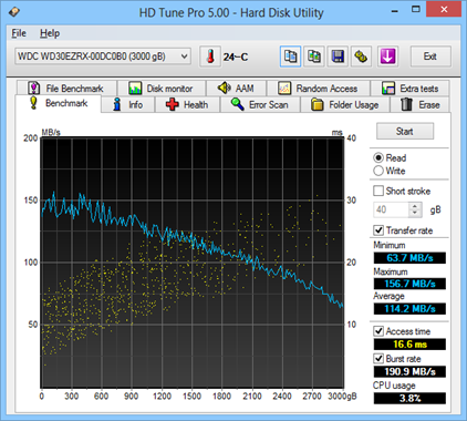

These numbers don't look right. The maximum transfer rate should be about twice the minimum rate.
Are these figures the read transfer rate or the write transfer rate?
Can you upload the actual benchmark graphs?
Edit:
Here is a shortstroked (2.2TB) WD30EZRX-00DC0B0 graph:
http://blog-imgs-55-origin.fc2.com/p/c/ ... ne_002.jpg
This is a fully stroked WD30EZRX-00DC0B0:
http://lh6.ggpht.com/-JWOUo73V2zM/UMsxA ... 25255D.png
Your results appear to be consistent with a drive that has been shortstroked to 800GB. If so, then you have a 32-bit LBA limitation in your driver or BIOS.

Here's a screenshot of the report from HD Tune for the RAID:
https://www.dropbox.com/s/eg6p7xsck27edu7/Screenshot%202014-12-19%2022.48.07.png?dl=0
Screenshot for the WD30EZRX:
https://www.dropbox.com/s/d6xz2jeaj9wsqc6/Screenshot%202014-12-19%2022.58.51.png?dl=0
HD Tune info for the WD30EZRX (HD Tune info for the RAID is empty):
https://www.dropbox.com/s/kifo37vnspuix2p/Screenshot%202014-12-19%2023.03.31.png?dl=0
It's curious that HD Tune is reporting it as only a 2.2 TB drive in that screenshot. Just an anomaly with HD Tune?
Windows properties on the WD30EZRX:
https://www.dropbox.com/s/5gbuunposohjrwi/Screenshot%202014-12-19%2023.06.37.png?dl=0
Anybody see anything in here that I'm missing?

The Windows Properties screenshot for drive G: is that of a logical volume, not the physical drive. As such, the capacity information would be retrieved from the file system, not from the device driver. Therefore it's possible that Windows is unaware that the 3TB volume is occupying a 2TiB drive, in which case you would have a data loss time bomb. At the moment the used space is 1.87TiB which is within the 2TiB limit. However, as soon as you attempt to write beyond the 2TiB mark, the data will wrap around to sector 0 and trash your file system.
How does the SATA controller appear in BIOS? Is it configured for RAID, AHCI, or IDE mode? Note that even single drives can be configured in RAID mode. AFAIK, some BIOS RAID versions will not support individual drives in excess of 2TiB. RAID and AHCI use different drivers, so if you built the file system in AHCI mode and subsequently switched to RAID, then that could explain the 32-bit LBA problem.
The flat HD Tune read benchmark graph for the WD30EZRX suggests that the JMB363 SATA controller, or its driver, is throttling the drive's performance. Comparing the graph against the ATTO benchmark would suggest that HD Tune may be using a sub-optimal transfer size, eg 64KB or 128KB, but I'm only guessing.
