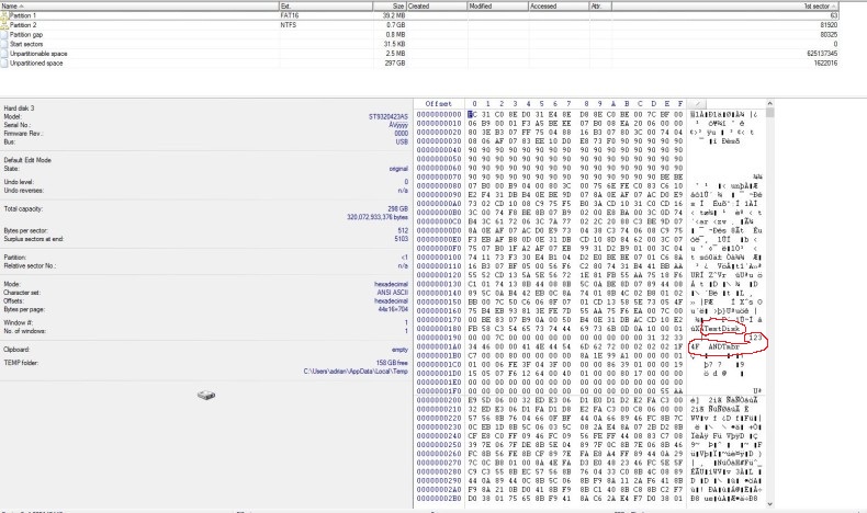

I've received this drive with the description : No data acces. Its from a DELL latitude laptop(quite old)
After connecting the drive ive notice this in Winhex
As we can see its an encryption case, whit truecrypt. Now the problem is i am not able to mount the drive.
I've cloned the disk and i am working with the image so that i keep safe user data in case off errors. The cloning went well, no errors.

can you post sector 0 please

Hola!
Aqui esta el sector 0.
Gracias por tu interes.

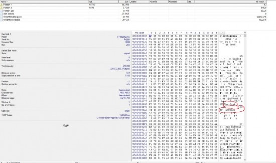

When y try to mount the drive i get the next message: Invalid password or not a truecrypt volume

This is the way ive tried to mount the drive

The partition table has been overwritten by testdisk (http://www.cgsecurity.org/wiki/Menu_MBRCode) so that why you can't recover, is not truecrypt bootstrap present on sector 0. You may want to get a working drive install truecrypt and then modify sector 0 on your image with the correct bootstrap for tuecrypt.

Probably what happened is the system failed to boot so one of the bright techies in the backroom decided to overwrite the mbr with testdisc. I have seen quite a few like this and usually end up decrpting the drive/volume to get the data back.
You should read the Truecrypt manual on how to restore the Truecrypt boot loader from a rescue disk. If you can't get the volume to boot as a Truecrypt volume you should still be able to decrypt it providing you have the correct password. Que tengas suerte!

I agree, as stated by others, that boot sector does not contain TrueCrypt.
Your only hope of recovery will be to use a TrueCrypt rescue disc to restore the bootloader. It forces you to create the rescue disc when originally encrypting the drive.
If the rescue disc has been lost then the data is unrecoverable.

The customer just notified me that he has the rescue disk...... what a relief.
Hopefully i can restore data.
