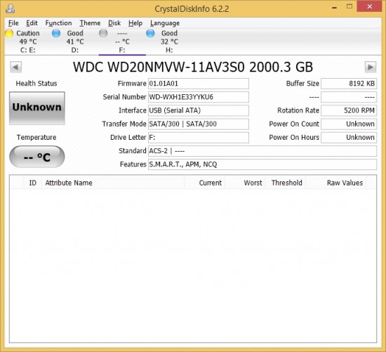

fzabkar,
Thank you so much for your response.
I downloaded and ran CrystalDiskInfo but it cannot get SMART report. It takes about 5 minutes for CrystalDiskInfo to launch, I think that is because of that bad drive. The drive is recognized, but no SMART report data. Attached you can find picture of CrystalDiskInfo.
Is it still worth to try to clone the drive with Ddrescue? Or should I look for converting it to SATA? Unless "slow fix" can be applied any other way.
P.S. I found your posts in earlier topics and found them very educative and interesting for me. Thank you.

 Post subject: Re: WD external drive extremely slow
PostPosted: December 28th, 2014, 16:09
Posts: 17225
CrystalDiskInfo has trouble retrieving SMART data via certain USB-SATA bridges. It may be that HD Sentinel or smartctl (smartmontools) would be better for this.
As for converting your PCB to SATA, perhaps the most expedient way would be to obtain a compatible SATA PCB and transfer the contents of "BIOS IC 2" from patient to donor. You would apply the "slow fix" with the SATA PCB, and then revert to the USB PCB for your data recovery, assuming that the data are hardware encrypted by the bridge firmware.
