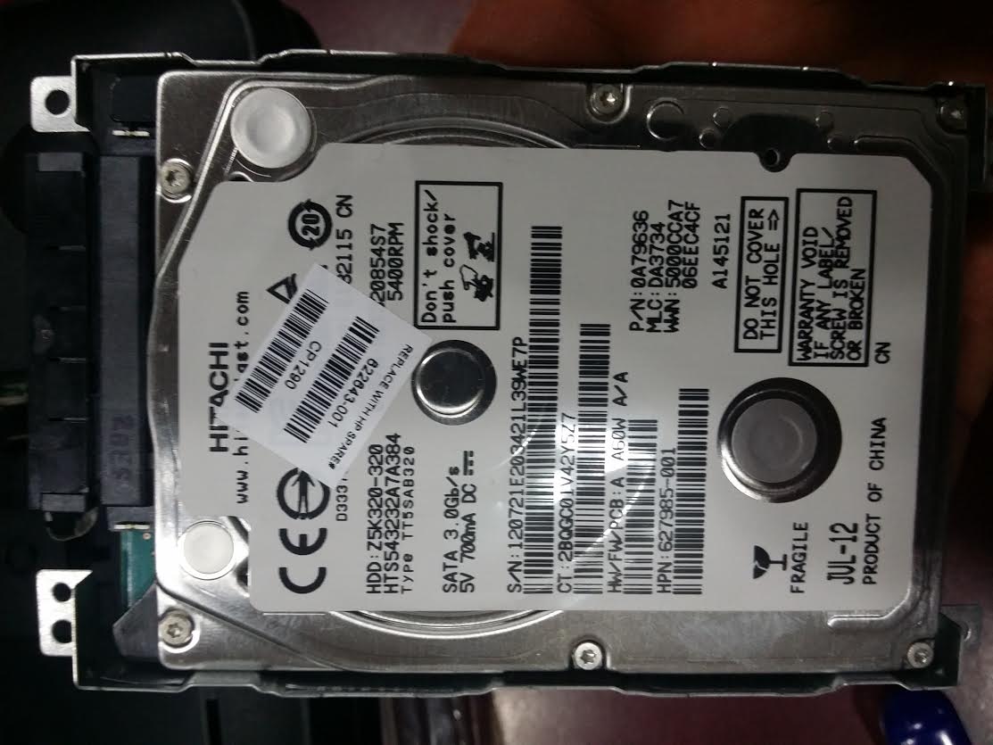

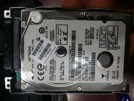

Hi guys and gurus,
I dun goofed with my dad's [work] laptop. After some unresponsive behavior in Windows, I forced a shutdown and upon powering up the disk was dead.
It spins up, it does some repetitive cycling of the heads, but that's it. No sata or sata-usb cable can detect any logic on it.
Do you have any ideas where I could start from in recovering the [very very] important data on it, without having to sell one of my kidneys to a professional?
More specifically, how important is the part number when trying to replace the PCB? Because I found an almost matching PCB, but from an older model. The main model serial still matches, i.e. HTS543232A7A384, but the part number is 0A78603 instead of 0A79636. The one I intend to buy is dated Jan11, whereas the one I want to repair is dated Jul12. Would I have any chance with that PCB? What would be the approach here?
I'm an engineer, so I have a decent 100MHz oscilloscope, a soldering station and a benchtop power supply. Could I possibly probe it to see if it needs some kind of rework, or see some voltage levels to pinpoint the issue?
I'm in [BIG] trouble, or better said, my dad is in big trouble if he doesn't have his data until the 5th of January, so any advice would be most welcome.
Thanks a lot!
Here's a photo of the serials on the unit, if it's of any help: http://imgur.com/9XVrTXN
Unresponsive behavior in Windows can be a symptom of a faulty hard drive; so I would not assume that a forced shutdown would have caused the problem if that is what you were implying. Hard drives are generally designed to handle unplanned power loss events.
h11angel wrote:
It spins up, it does some repetitive cycling of the heads, but that's it...
In general, if the drive spins up, it is unlikely to be a problem with the PCB.
You could for example have a degraded head (I would guess most likely) or a firmware problem. It is hard to make a diagnosis without proper tools.
Are they any data recovery companies in your area that offer free diagnosis?
It makes sense, given that the brushless motor has to be controlled by some kind of firmware for the spin ups/downs.
I don't see how a degraded head can render the drive unrecognizable by the SATA controller of the motherboard. Maybe my knowledge is off, but I would assume that it (the hdd controller) would at least broadcast its ID and other info on the SATA bus. So a firmware problem would make more sense (I guess). :?
In fact, I only looked at the recovery costs (an arm and a leg) . They can actually diagnose it for free in one day or for 15 bucks in 1 hour. I'll definitely check that out tomorrow. Thanks for the great idea!
To get back to one of my previous concerns:
Do you think I would have half of chance with that PCB, or it does not make any sense at all (due to firmware, calibrations, hardcoded values etc)?
I can give you an example: When a fully functional drive is powered up, it normally becomes "ready" after several seconds, the same drive with degraded heads might take 90 seconds for example to become ready (if at all). The computer BIOS may have a timeout value less than the time the drive takes to become ready, so it may not detect the drive.
I recommend you get the free diagnosis from the data recovery company, as doing your own diagnosis could make the problem worse.
