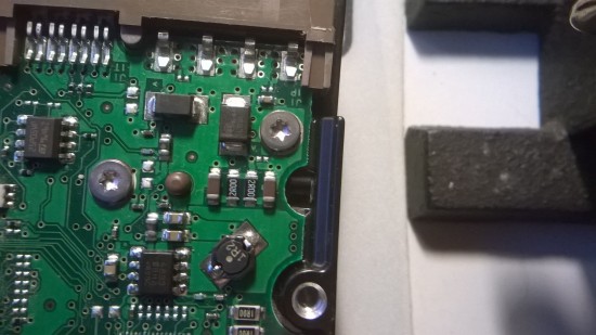

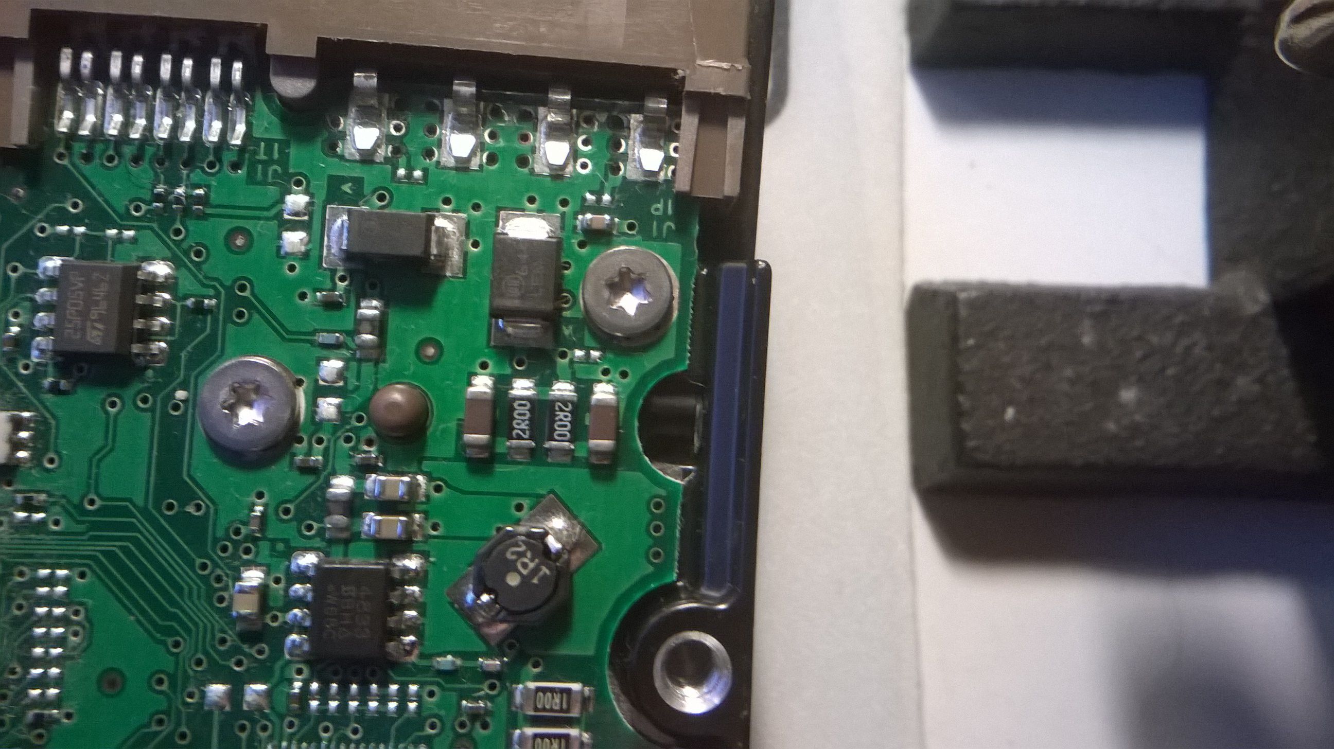

 Post subject: diamondmax 21
PostPosted: January 10th, 2015, 5:41
Joined: May 18th, 2009, 5:44
Posts: 12
Location: italy
inverted polarity on stm3320820a smoke on pwm diode is there someone in italy that can change diodes?
the hdd is stm3320820a fw:3AAE P.N:9DP03G-326 TK DATA CODE 7276
I have 2 other hdd fw:3AAE P.N:9DP03G-326 TK DATA CODE 8397
3AAE P.N:9DP03G-326 TK DATA CODE 7383
can I change the pcb? Or, if not, is there in italy someone that in case can swap also the firmware chip?
Incredible that no one here is capable to change a pwm diode.And i have a spinal cord injury so my hands are not able to do.
Any help is very appreciate.
Max

Thanks for reply.I'll post you photos asap.
The diode of 5v is short in diode mode measure.It was an external drive.
Really thanks.
Max
 Post subject: Re: diamondmax 21
PostPosted: January 11th, 2015, 13:54
Posts: 12
Location: italy
I made some measurements.
In test diode 5v and ground are in conduction on + of diode.
test pins of diode and it's in conduction.
Can I try what you suggest?
You're very gentle, thanks.
Max
PostPosted: January 11th, 2015, 15:40
Joined: July 2nd, 2011, 14:16
Posts: 463

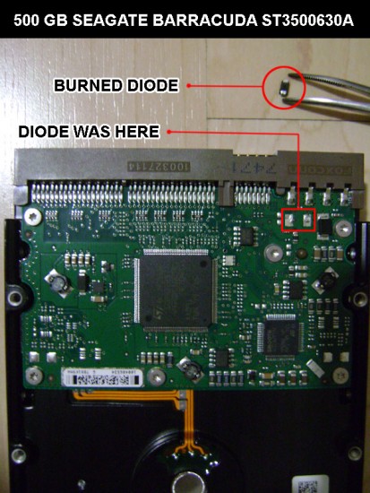

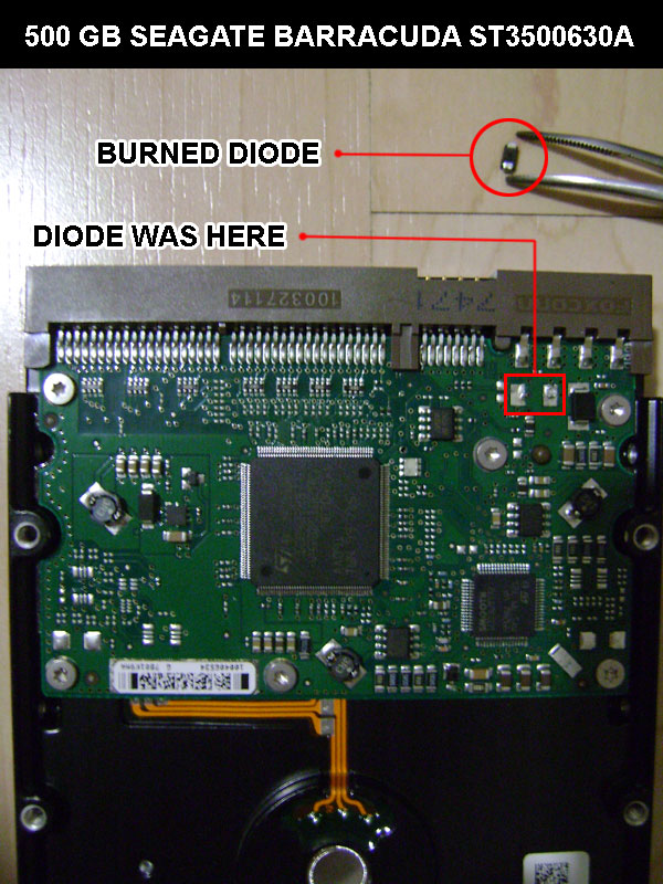

umm, I wonder where the memory chip is, on the other side?
PostPosted: January 11th, 2015, 16:10
Posts: 17226
It must be embedded within the MCU.
http://cdn.shopify.com/s/files/1/0255/4 ... 1404739105

I want to say thanks ,really thanks to everyone in this forum and a big thanks to Spildit and fzabkar.
They help me solving my problem and , really, they share their knowledge with us.
I resolve removing diode.
I'm very happy because i can't walk so my pc is my life, my little manner to communicate with other people.
Max
