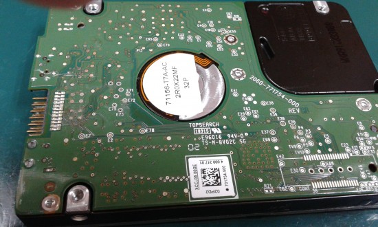

hi,
I have 2.5 inch WD USB hard drive( WD10TMVV-11TK7S1 1.0 TB.). I want to swap the pcb with the compatible sata one. what is the compatible sata pcb to this usb pcb. please see details on below picture.

The forum has a neat feature up top called the search box.
viewtopic.php?f=1&t=28738&p=197932&hilit=701754#p197932

Try donordrives.com.

In general, you would look for a SATA PCB that has the same MCU and motor controller ICs. Ideally the USB and SATA PCBs will look identical apart from the bridge hardware at the front end.
