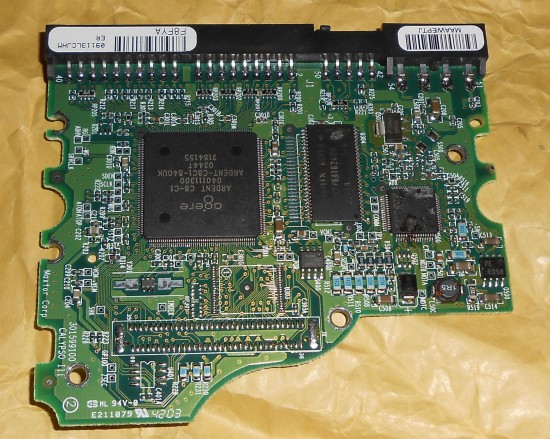

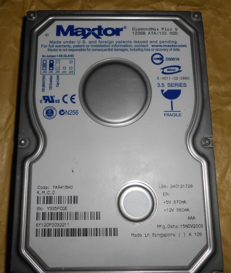

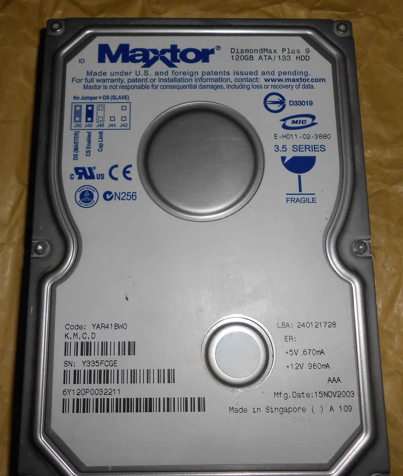

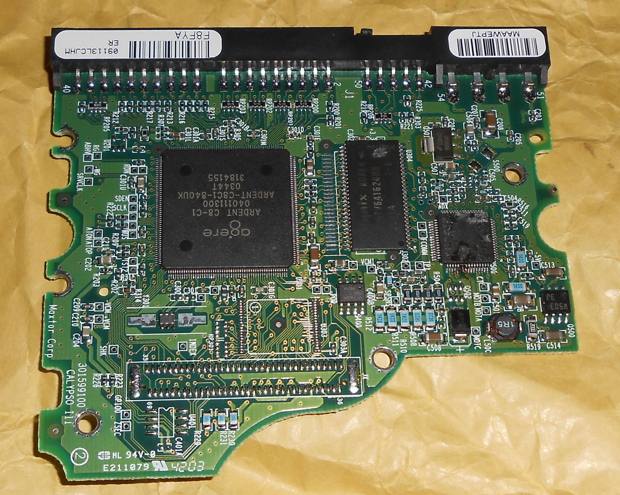

Just fried my Hard Disk and VERY annoyed by it. Luckily most of my stuff is backed up and other drives, but would like to get back my bookmarks and other things, or get the drive working again as it was really expensive when I bought it. Still worked fine until my little bobo....
One of my other drives failed to start, damn thing always messing around, should have replaced it long ago, but never got around to it, so I was disconnecting the power connector when there must have been a short or something. Don't know what happened but shortly after there was several popping sounds and then burnt PCB smell. I know my hard drives had it.
I had 3 other drives and luckily they are okay, different power rail completely I think, but to my horror, found out my MAIN HDD is fried.
I have uploaded some images for a better understanding.
What I really want to know is will the Pre-amp inside the drive be toast. Not sure on this type of drive and where is the ROM chip, if there is one.
As you can see the Motor controller got whacked, even when I had a heat sink on it. Took it off for the images.
File comment: Front of the PCB Damaged MC

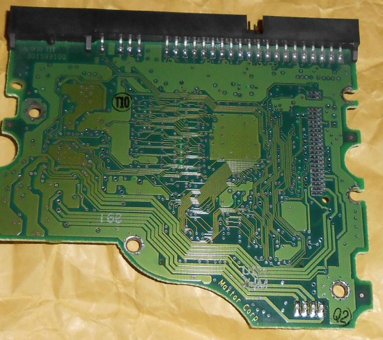

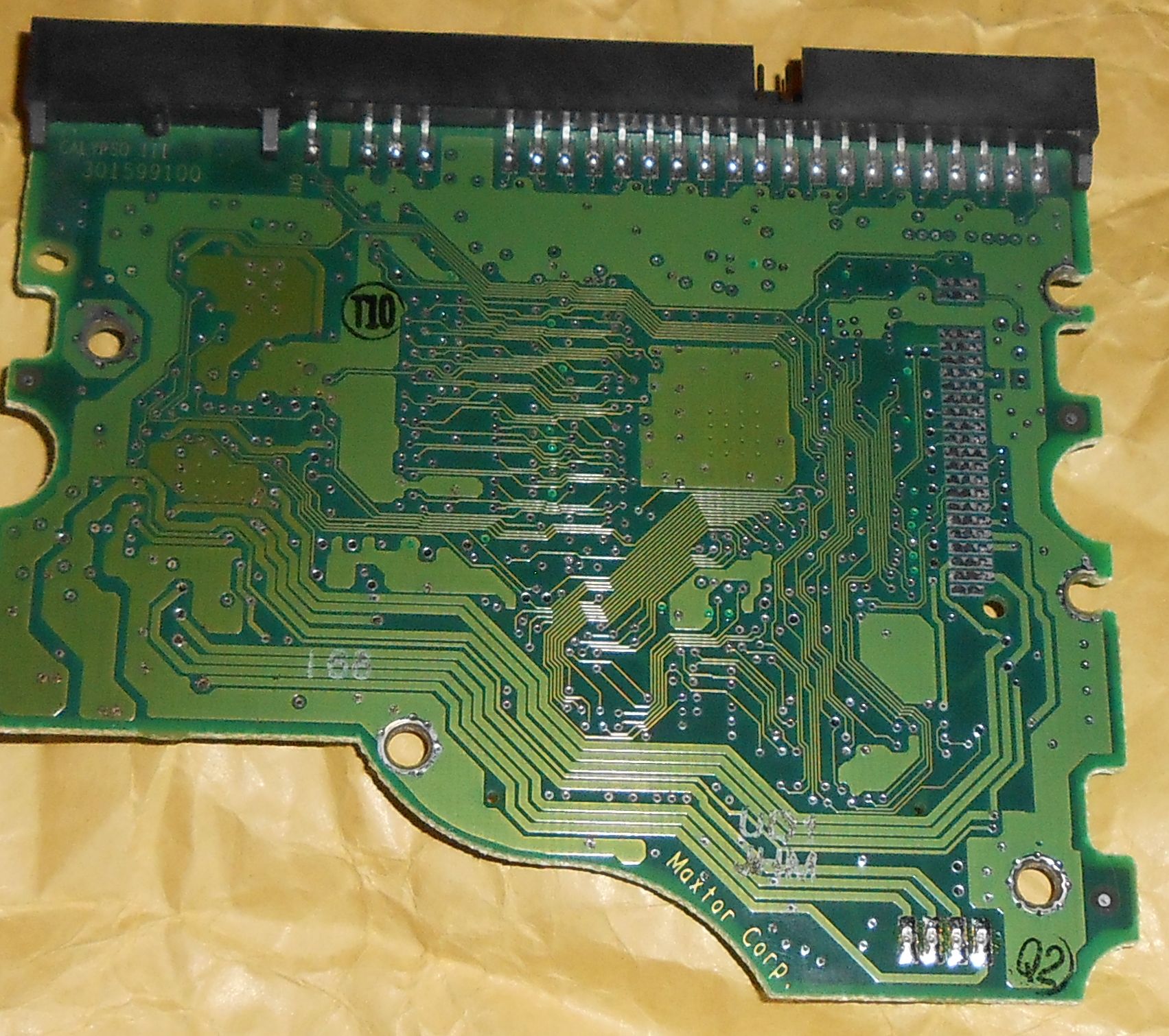

File comment: Underside of the PCB

File comment: Hard drive lael

You might be lucky with this. I think the ROM is the 8pin chip near the Controller. Not Sure as I don't do much in the way of HDD's but reason I am replying is that I may have some of these drives in systems I am replacing.
I wouldn't worry about keeping it regardless of the expense when new, as it is getting a bit old anyway and I am wary of 12 year old drives..
You may get away with a board swap, I am not sure if the rom needs to be swapped though, someone with more experience can add this.

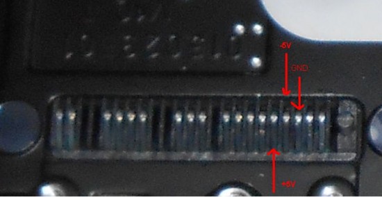

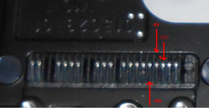

Measure the resistance between Ground and -5V with the PCB on and off the drive.

No ROM.
 Post subject: Re: Maxtor DiamondMax Plus 9 Y335FCGE
PostPosted: January 7th, 2015, 3:14
thatdellguy wrote:
No ROM.
Well, no external ROM anyway :-)
Sometimes they put one at U401 for "last minute" FW updates, but this one doesn't have one.
@OP... You have PM
PostPosted: January 7th, 2015, 3:35
Posts: 17217
@ShaneWard, I see that the SMOOTH chip is blistered on the motor side. Perhaps you should measure the resistances of the motor windings. It could be that motor problems are relatively common in this model (I've seen a few threads that would suggest this).

resistance on the -5v pin from what I understand from the diagram is 10.63 with board off the drive 150.5 with board on the drive.

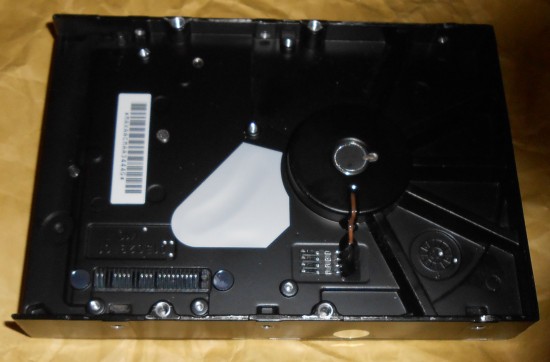

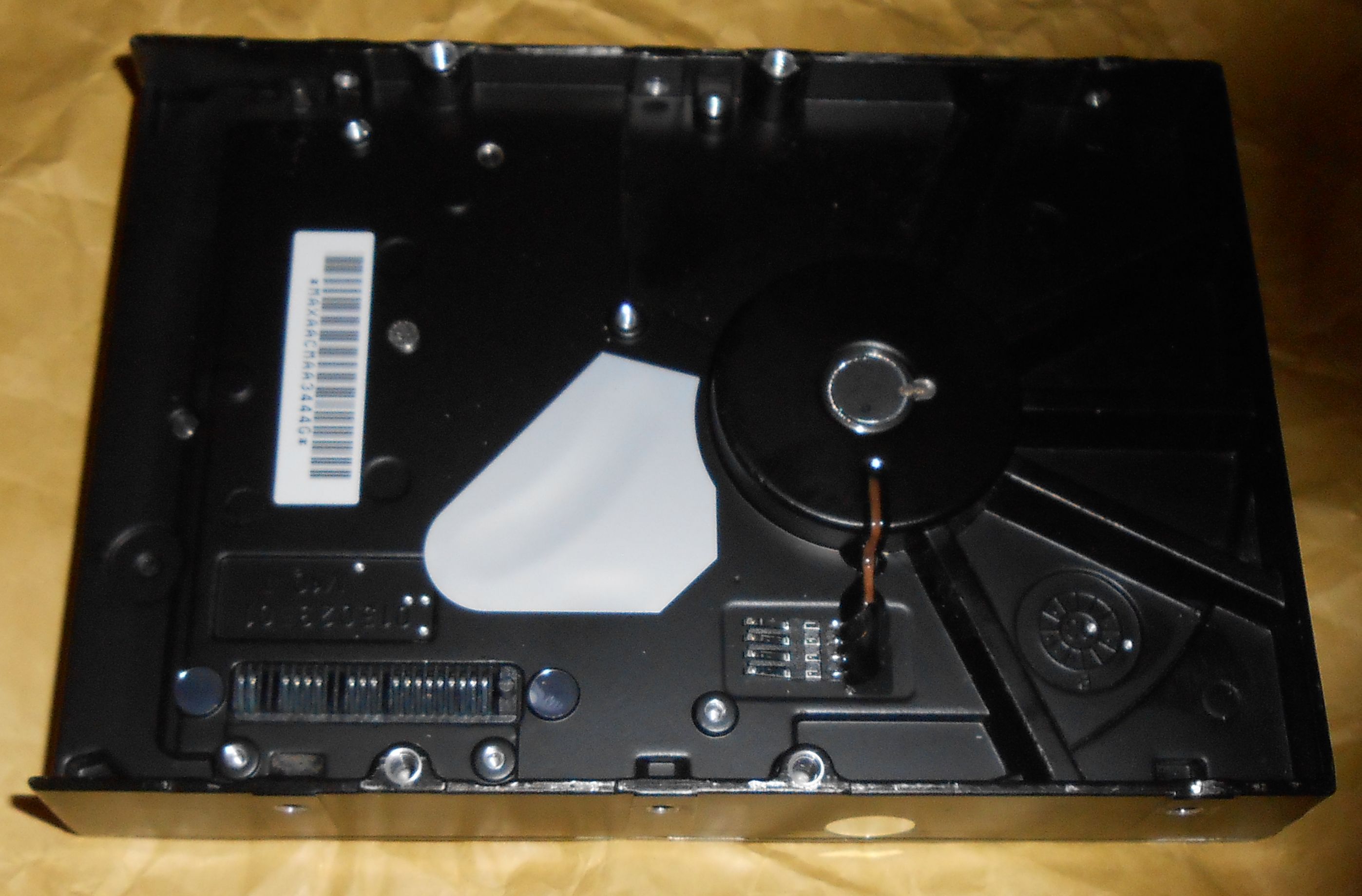

Edit, just put a different Maxtor pcb onto the drive covering the contacts of the main HSA and the drive spins fine, so nothing wrong with the motor. I don't think I will test the preamp this way incase the PCB does something to the heads or wipes something.

I've done more testing on the PCB board with the power connected as I think it might be giving me messed up readings. It's dead. here are the reading on some of the components.
+3.3V TP = 000.6 mV
-5V TP = 004.1mV
Vcore = 000.0 on lower side of chip 000.6mV on the other
All other contacts are in the mV range, hardly any current the PCB is completely toast.
Is there a way to test the preamp without using the PCB board, like using the contacts or something. Not sure if I am hitting the right pins. or the pins are correct for this type of drive.

All that you can deduce from your measurements is that the preamp's resistance is very high, ie it is definitely not shorted. For example, if the preamp's resistance were 15K, then your PCB-on-drive reading would have fallen by 1% to 149.5 ohms.

Thats what I thought. I even did I DIODE test on the pins on the underside of the drive as explained on another forum. The only sure way is to hook up a new PCB and see what happens.
DIODE test results (Was to put red probe on Grd Pin and black probe on -5v pin)
Its averages around 120.0 (nf)
Testing on the +5 reads as 1.399 (uf) and the number continues to climb with red probe on the +5 rail and black on gnd. If I reversed these the meter beeps at me.
Thanks for your help so far fzabkar, learning new things this week :)
Shane

An update for all you wonderful DR people, Just got the new PCB board in today, very fast, quite impressed and attached it to the hdd with the head contacts covered as in the image above, then the drive spin okay.
Good news, Now the pre-amp test
Then I re-screwed the PCB with nothing covered and the hard drive made the nice few clicks and then wentready... WOW.... managed to get it working fully again.
Huge thanks for all the people who recommended the new PCB. Another successful dead drive recovery.
