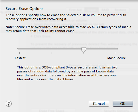

hack3rcon wrote:
It just for Windows :(
Im assuming you are using OSX then. OSX has a security erase feature built in.
If you are running the latest El Capitan go to disk utility, click on the drives partition and click erase. There will be a button saying security options.
Then this box will come up.
You can then select how securely you want you data erased.
