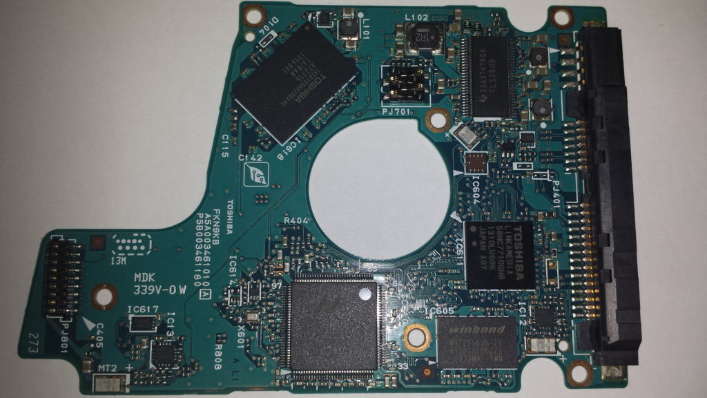

 Post subject: Toshiba MQ01ABD100H G3461A PCB Dead
PostPosted: January 3rd, 2018, 20:04
Joined: January 3rd, 2018, 19:07
Posts: 7
Location: Vancouver, WA
I have a Toshiba MQ01ABD100H drive that one day was dead no spin nothing will not even detect in the bios... I removed and put in a USB dock nothing no noise etc. Data on the drive is not to important figured I would post here maybe get a place to start to see if it can be salvaged vs. going to the landfill after a visit from the air hammer.
Nothing visually on the board looks burnt, But I am capable of minor smt surgery if required replacing diode, resistors, etc.
Thanks in advance.

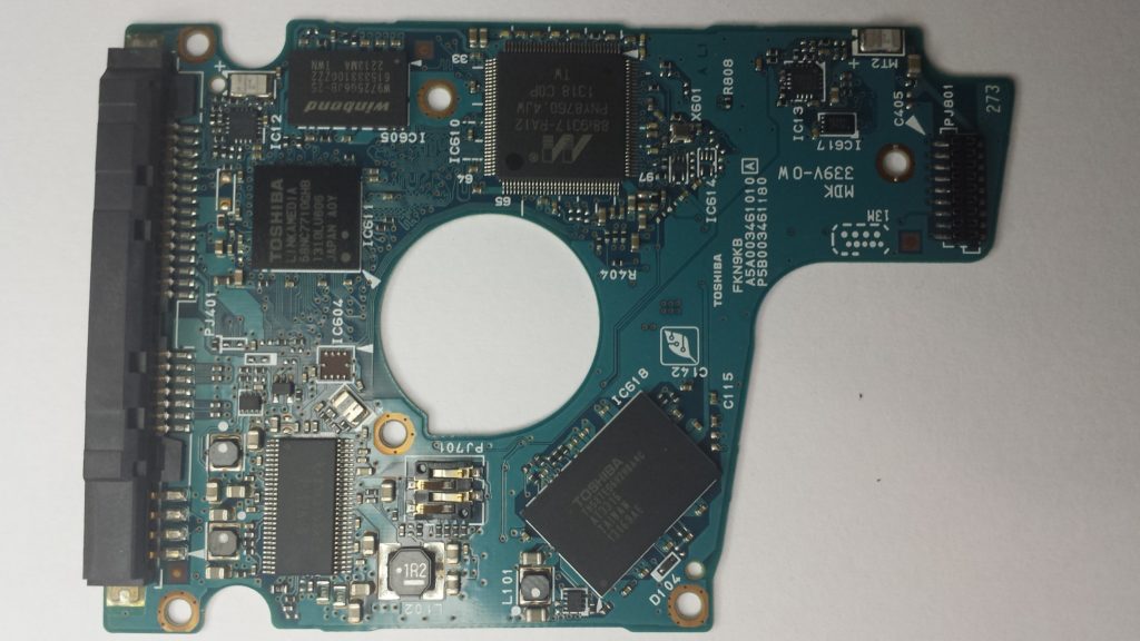

Best Photos I Can take at the Moment. Remove the -1024x576.jpg to get to larger image.
Board Image 1
Board Image 2
Flip Side

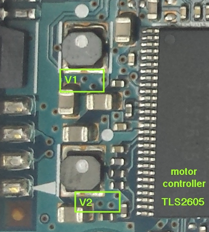

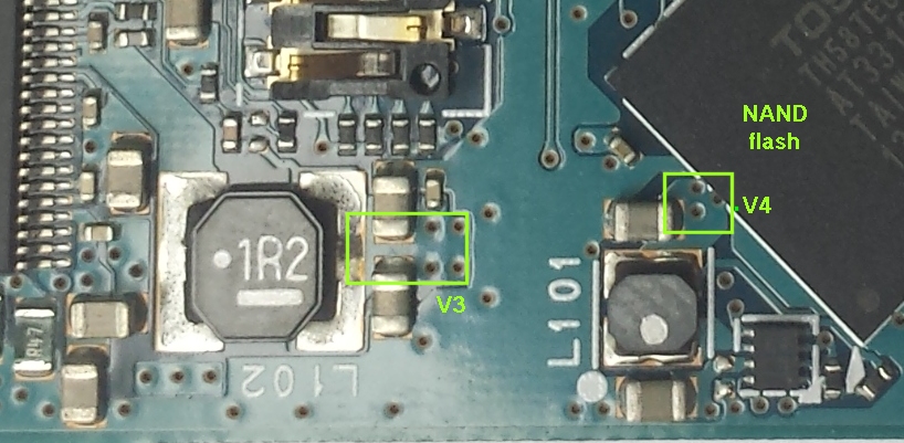

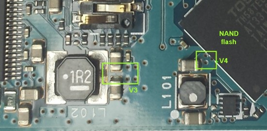

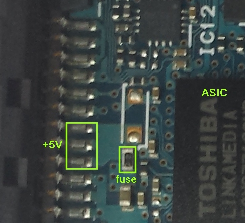

I would start by measuring the voltages at the fuse and V1-V4.
I would also like to know the markings on each of the chips, if you can make them out. IC617 is of special interest to me.

5V Line is 5V
Fuse is 5V Both Sides
V1 is 2.9
V2 is 2.5
V3 is 1V
V4 is 1.7V

I noticed on the drive where PJ701 connects to the drive that there was oxidization on the pads on the drive.
Gave it some cleaning re assembled it guess what... it spun up and it detected. but no partitions
