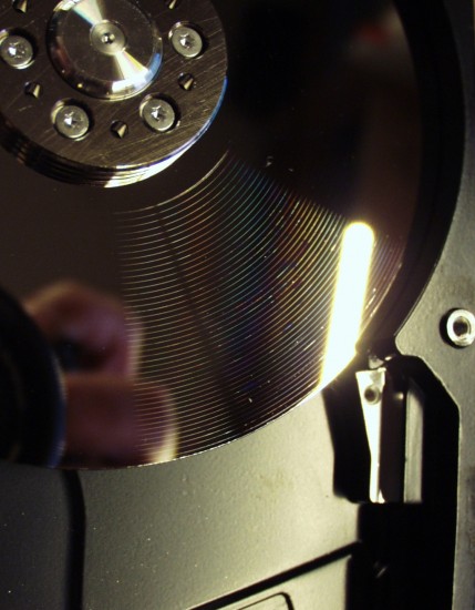

I'm currently in a job to get a HGST drive working again so data can be extracted. The heads cannot find the start sectors (high pitched noise), so I received a replacement drive.
Now I have the choice of changing the platers (and readjusting 'em) or change the servoarm.

While I do agree with Luke that you should hand a job like this off to a professional, I understand that not every job is worth the cost.
I'd recommend head swap over platter exchange any day, especially if there's more than one platter (which I'm assuming it has). Your chance of success platter swapping is about zero. I only platter swap a couple drives a year and only when the motor or bearing are beyond repair. For some drives we even replace the bearing in place rather than platter swap (though it still hardly ever works because they are usually Seagate nightmares). Head swap has much better outcomes.

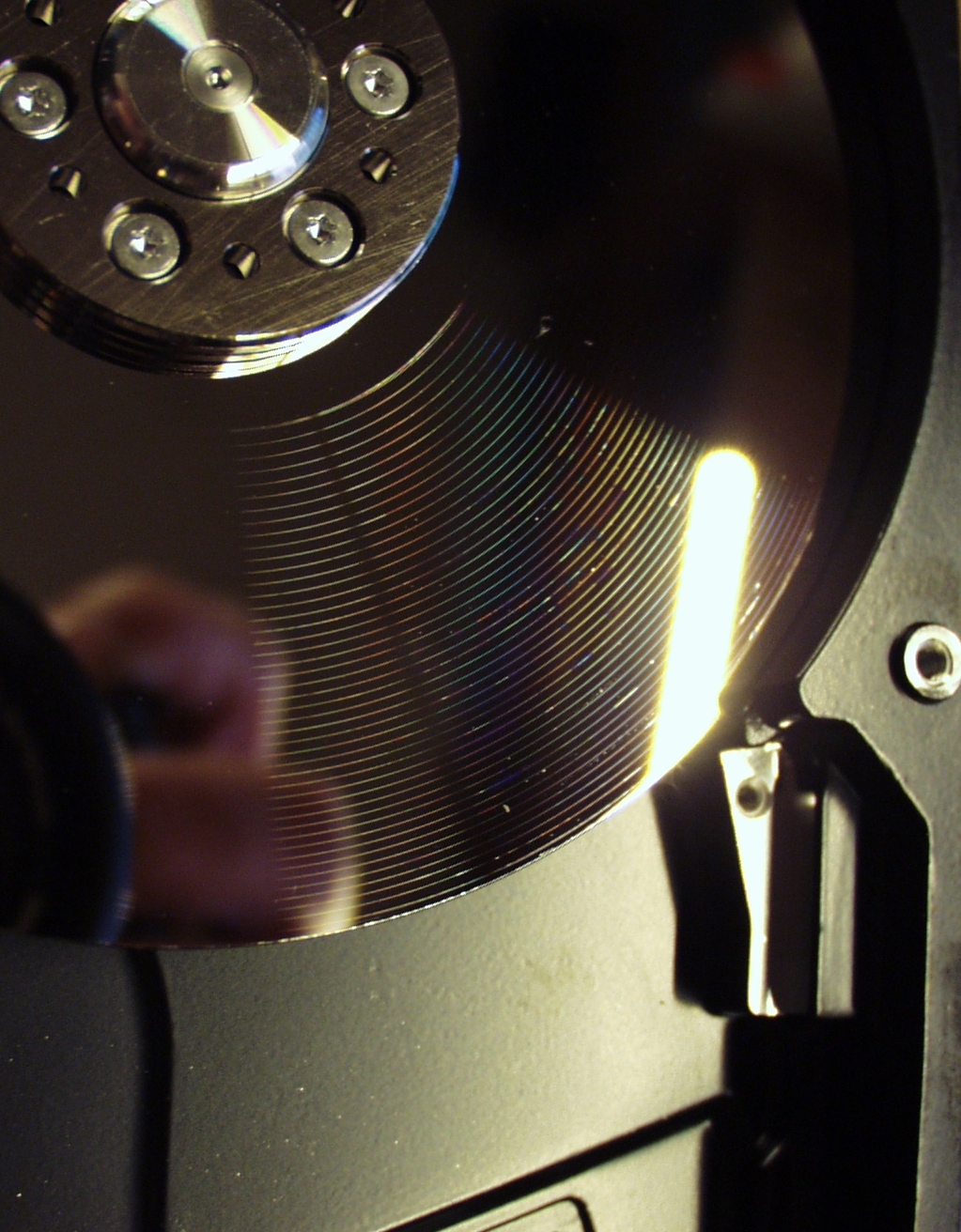

so I was successful, even when the platers were severly damaged due to multiple headcrashes (all four heads were hanging on tits wires only) so the surface was scraped off in concentric circles (I attached a picture of it). The servoarm was mounted from the downside, the headcomb for Seagate B10 or the Fujitsu drives was not at all fitting (so I bought a sortment from HDtools) but the rest was just as in most Fujitsu and SGT drives I know from disassembling. Before I attached the new arm I had to clean the surface from the "pixie dust" (with bottled N2 gas) of the scraped of platers, which forced me a few times to start the cleaning cycle of the clean room and costed me a few times waiting for the room to get ready. I calculated from the scap of/clean area of 10% direct impact and another 15% of side material and magnet contact area. Even with this crude calculation it was nearly as it showed in the read out phase. As lots of area was not there the copy job (ddrecue and ddr_help) had to be started with 1GB offset each time and restarted and with the protocol later getting nearer the damaged areas (the HD logic failed every time when the head come to far into the "not existing anymore area" and obviously lost it's sync and needed a power cycle) to get the most datas out of it. I'm using an SiI based SATA controller where I can control the GPIOs to switch power on/off on a seperated PSU board (to inhibit the power surge). It's quite similar to the PC3000 ISA Board, some might remember.
After I got the 1TB binary dump the logs showed about 27% NUL areas. With that I started my usual job with Quetek Filescavenger, GDB for Runtime, cgsecurity Photrec and last DiscRecovery from O&O, all very prone to media failures. WinHEX would be my natural 1st choice but took much to much time to get results.
I'm pretty sure everyone of you have it's own favourite programm to get results.
With about 15h (by 12h just for the mechanical part) it was a refreshing experience.
