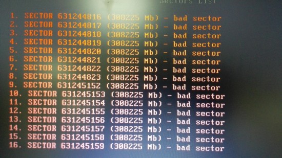

I handed it over to a professional or so he thinks. He sent me an image(attached) saying drive is detectable in bios and os.However there are bad sectors, further saying it would be bettor to send drive to India or Dubai as we dont have any local centers for data recovery.
Mostly people would run software application to recover data, which i understand could spoil it further?
File comment: Bad sectors

 Post subject: Re: Plz plz plz help me out of this situation! HDD Crashed!
PostPosted: January 27th, 2015, 15:59
For the real deal, the simplest question to rule out "those who provide very basic DR services" is: for hardware failed drives, do you image/clone using software or hardware based equipment? Hopefully they will answer truthfully, and as result, the answer should be hardware based imagers. If that is not the answer, then as you said, you should stay away from those that can do "what anybody with computer knowledge can do."

Thank you for your individual inputs. It was helpful, atleast to make sure that i dont go the wrong way.
I took hard drive to a center, who do head replacement and all. Apparently the guy can't fix a WD but anything else.
Further, he said WD drives are like usb with some board and all. Since there are bad sectors, head replacement wont work. And that the drive has integrated board that make things complicated. I dont understand most of it or atleast i dont concur with what he said.
He also said, if it was Buffalo or Seagate or any other drive he would have fixed it right away. Strange!!!
What do think, is that a fact? Its an WD Blue internal hdd for lenovo Thinkpad.
