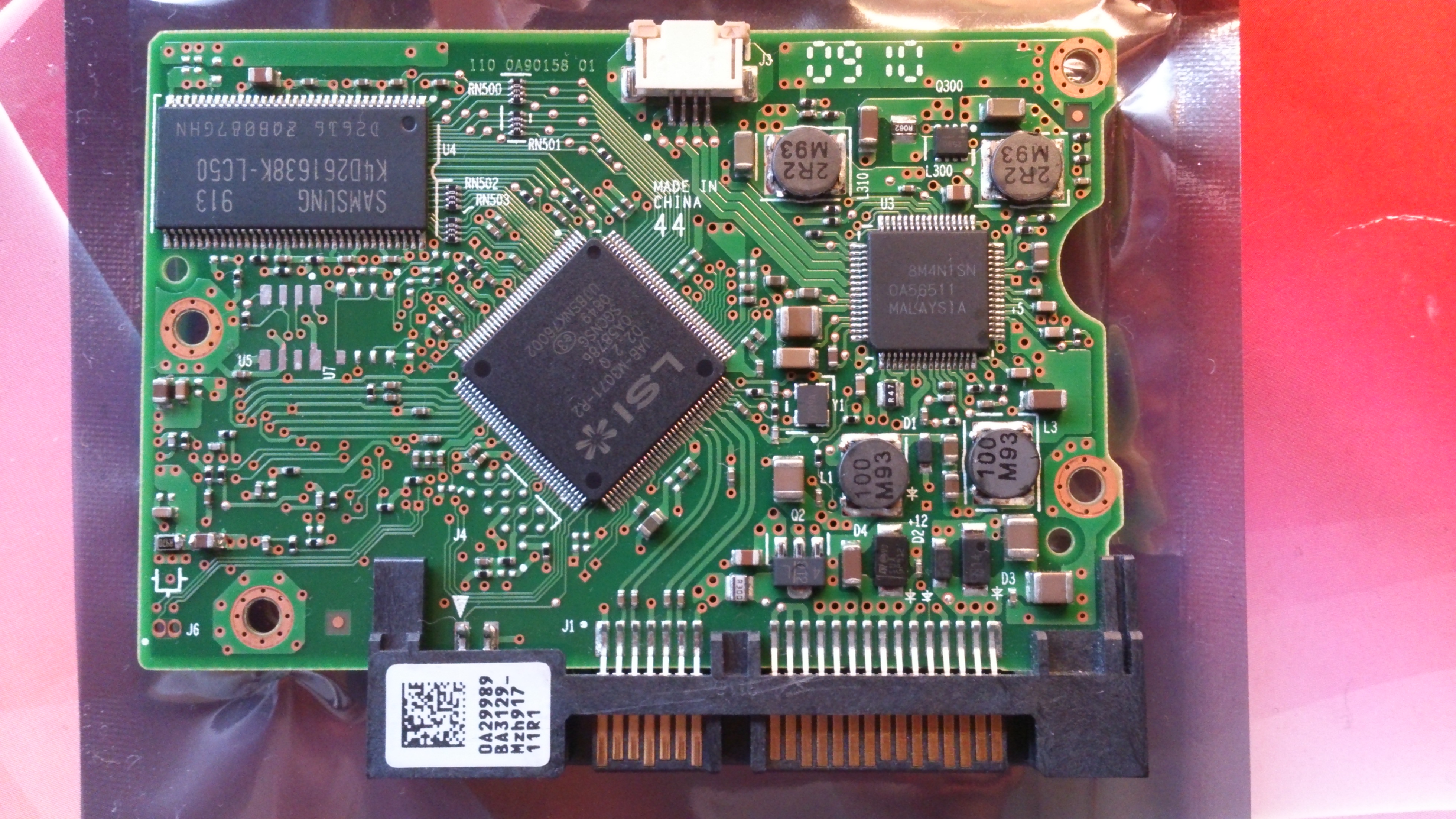

I have a problem with my HDT721010SLA360. First it was just dead, so it does not spin any more at all. Then I ordered a new PCB from HDDzone.com. I sent them a picture of my old PCB to ensure compatibility. Then I went to a professional firm which is specializing in repairs at microchip level and they swapped my old NVRAM chip to the new PCB.
Back at home my HDD is now spinning again nice and smooth without ominous noises but when I try to boot I get the error message: "4th slave hard disc error, press F1 to resume".
It needs 10-20 seconds until this message is shown. When I press F1 and go into the BIOS the HDD is recognized but has a size of 0MB. When I boot then from my main HDD Windows can't find it, neither in the explorer nor in the system management.
Will a BIOS reset of my mainboard help? Or a firmware update of the HDD?

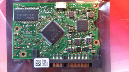

@Jenners, does your PCB have a single chip at U5, or does it have both U5 and U7?
Do you still have your old PCB? If so, could we see a detailed photo of the component side? It might help to take a few measurements to determine how the PCB failed and whether the preamp is likely to have survived.
Yes there was only one chip at U5. I attached a photo of my old PCB, where the chip is off at the moment.
Assuming that the NVRAM chip is bad can I somehow rewrite the information on the chip?

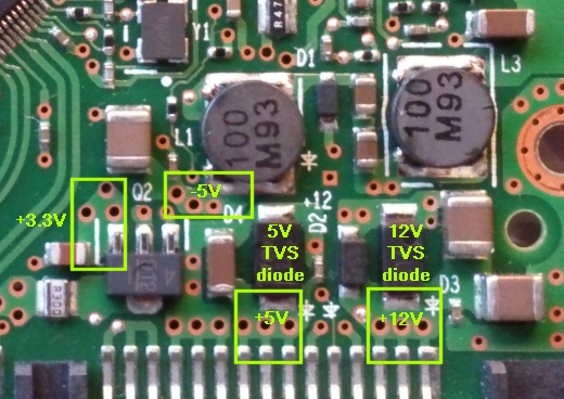

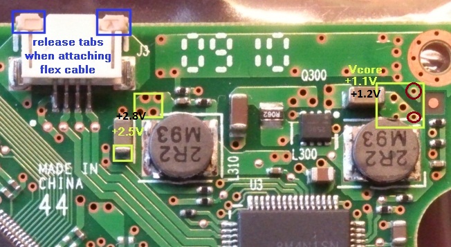

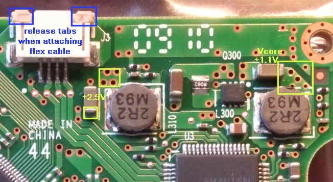

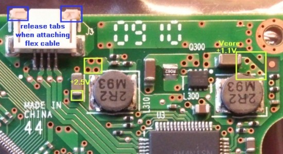

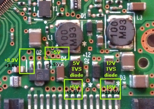

Can you measure these voltages?

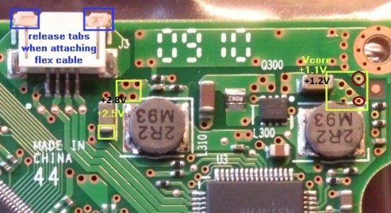

I added the measured voltages in black. At the Vcore I marked two points with red, where I couldn't measure any voltage, but I'm not sure if I should or if the other spots are sufficient.

Your multimeter is reading 11% too high. If its battery is OK, then it's time to get a new meter. Otherwise the voltages are OK.
Most preamp damage appears to be the result of an overvoltage on the +5V supply. Your PCB shows no evidence of overvoltage, so the preamp is likely to be OK.
Your "ROM" is embedded within the LSI MCU. If it's a case of incompatible ROM code, then it would be just a matter of finding a compatible PCB. That's still potentially a DIY proposition. That said, I would have thought that hddzone.com would have been able to determine whether their PCB was compatible.

Do the first two lines of the white sticker match on your original/new PCB's?
 Post subject: Re: Hitachi HDT721010SLA360 "4th Slave Hard Disc Error"
PostPosted: December 20th, 2015, 11:48
Joined: December 16th, 2015, 7:19
Posts: 5
Location: Hamburg
Yes the first two lines do, but not the last two.
