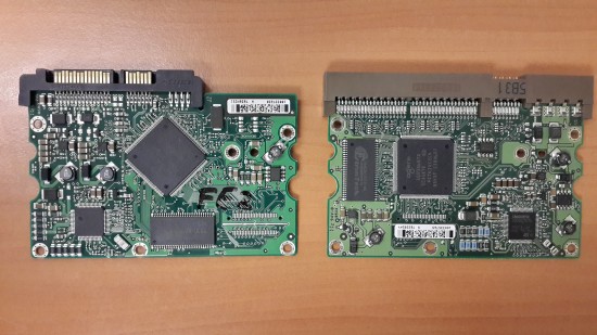

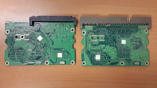

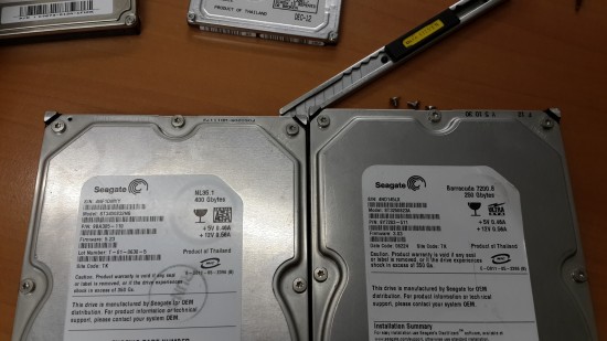

Had a 400GB NL35.1 which had a damaged PCB. Didn't have a compatible SATA donor PCB, so I successfully used a PATA PCB.
Patient SATA NL35.1:
100337233
MCU: Agere 100328756
Donor PATA ST3250823A:
100354297
MCU: Agere 100356070
Hope this helps someone.

Nick,
Please Upload The HDD Top And PCB Component Side Photo If Possible Please

Here are the images

Drives:
