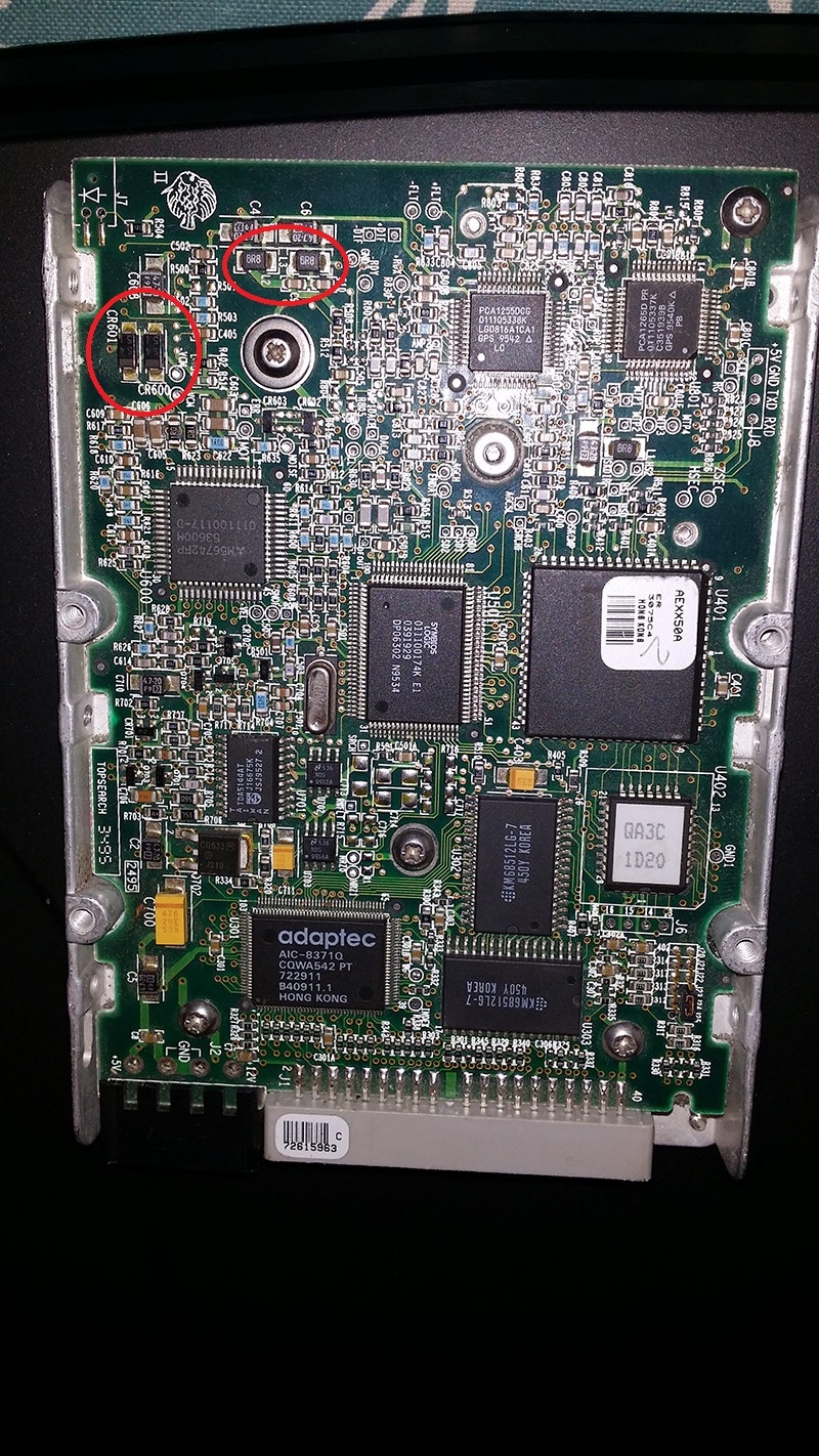

Hey everyone,
So about 10+ years ago, the power supply on my tower fried everything in my machine. I was bummed, so I tossed all the drives in a box and moved on.
I came across these old drives a few weeks ago and I started researching PCB swaps, and I'd really like to get the data off of these drives as they hold old pics and docs from my HS days.
Anyhow, I've done some scouring on ebay, amazon, and pretty much every PCB site I could find and couldn't find the exact firmware number I was looking for for one of the older drives.
What would you guys recommend doing, short of sending it to a data recovery company. Don't really have the budget to shell out a couple G's for this.
Thanks everyone!

 Post subject: Re: Really old HD with a bad PCB. Is this recovery possible?
PostPosted: February 8th, 2015, 20:20
Posts: 3966
So what happens when you plug it in? totally dead, no signs of power?
I would start by looking for all components marked with an "L" and checking for continuity. If any are open, then these could probably be bridged with a wire temporarily to get your data off.
Also maybe the Chip Resistors could be checked.
Chip Resistors are general passive components which are primarily used to create and maintain a known safe current within electrical components.
Other than that, keep searching for PCB..

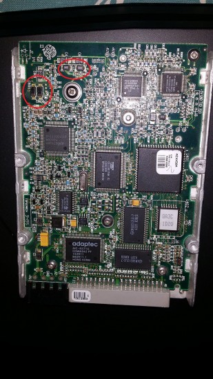

Yes, drive is completely dead upon plugging it in.
Donordrives just got back to me and said they don't have this PCB in stock.. i guess the next option would be to start checking the components for continuity.
PostPosted: February 9th, 2015, 17:16
Posts: 17217
The crystal to the left of the Symbios Logic chip appears to be dented. If the quartz has shattered, you may be able to hear the shards rattling inside the metal can. If the drive sustained a significant impact, then there may be other damage as well.
