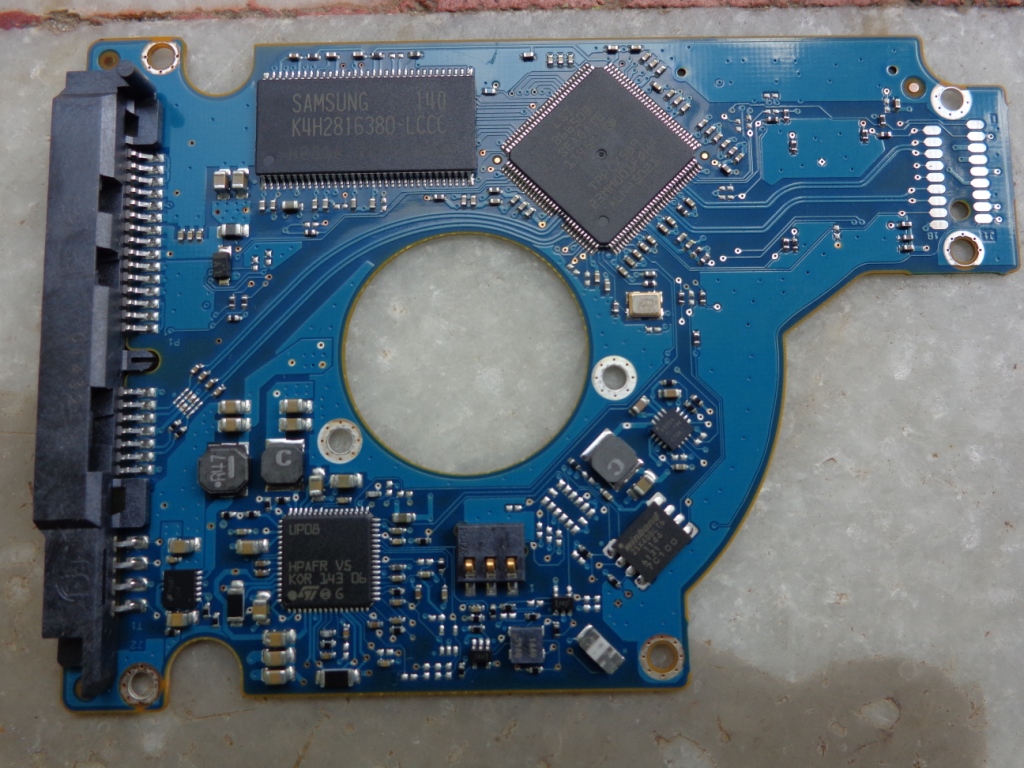

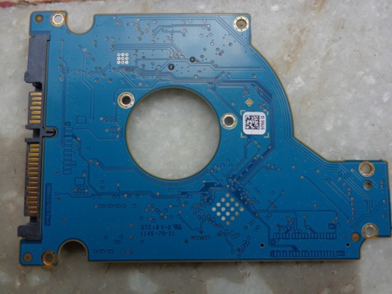

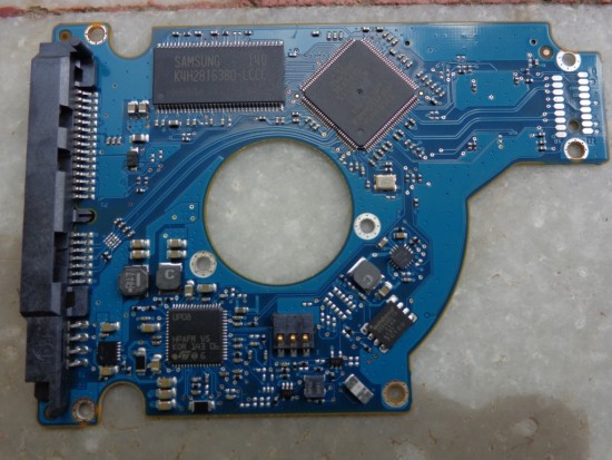

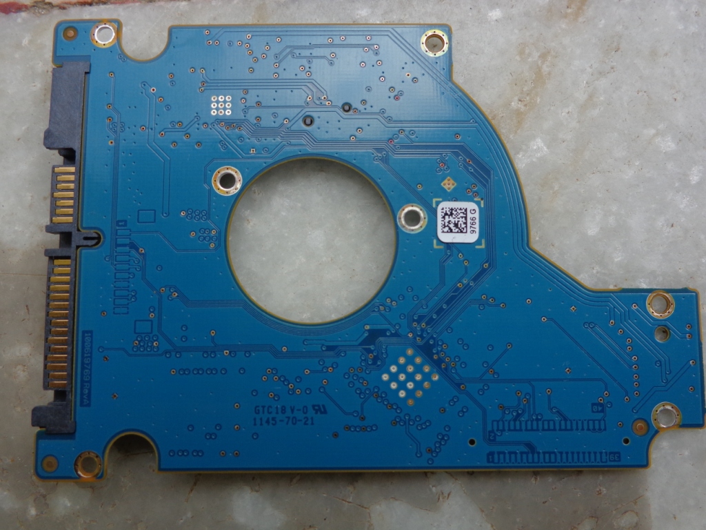

Hello everyone,
my Momentus drive connect in F3 mode
this err showing is :
EarlySpinup Enabled
Rst 0x10M
Execute
SpinRequest
LED:00000067 FAddr:00380338
any PCB short need this one.

can you list the full model, FW etc....?
what are the symptoms ? clicking or anything ?

Hello MindMergepk,
Seagate Momentus ST950042AS
FW : 0001BSM1
Normal spinning, no clicking sound

Try transferring the ROM to a healthy donor PCB and report back your findings.
+1
