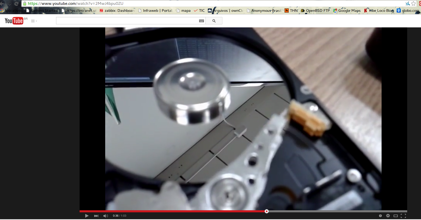

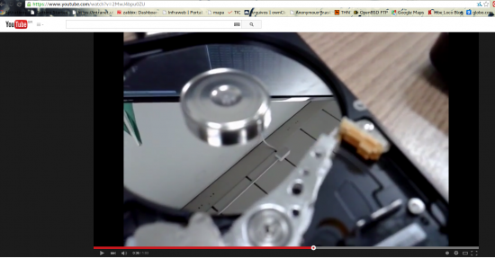

Today my external usb hd stop working.
It seems to be a physical problem because it does a weird noise and nothing appears in dmesg.
Ps.:The driver is not stucked the plates runs, the needle moves e the led keeps on, but no blinks.I have already opened it but no success.
This was the last "talk" between my system and the HD:

Maybe it helps:
http://youtu.be/2MwJ4bpu0ZU

Is it one that uses a SATA to USB adapter bridge board, or is the USB board build right onto the actual hard drive?

Yes it is USB board build, no adapter.it does a repetitive sound.
The HD dont suffer any impact or damage, i dont have a clue about it.
I just put a video on Youtube, maybe it can help:
watch?v=2MwJ4bpu0ZU
Thx
