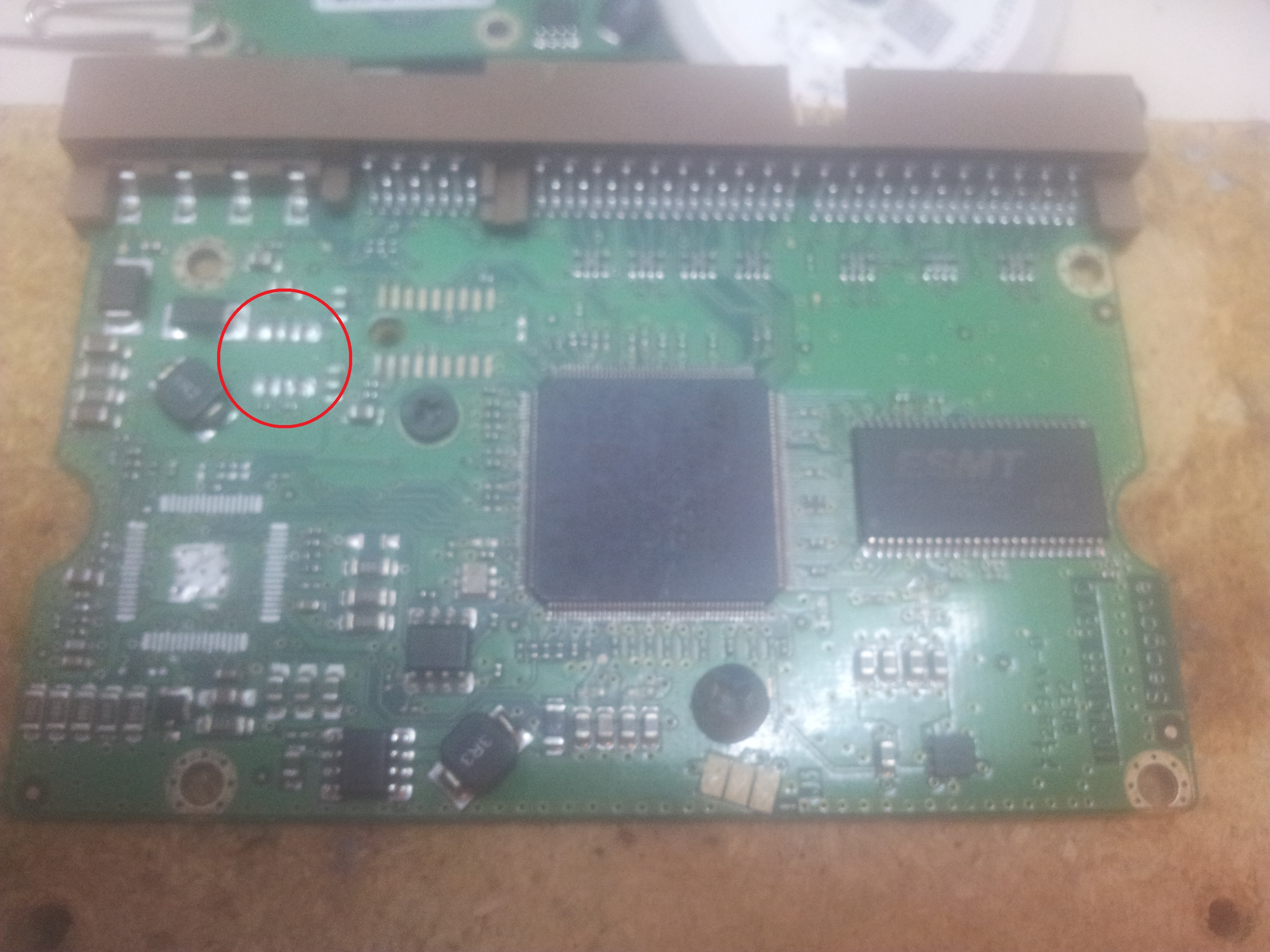

I want to repair this board but this mosfet (circle) is missing. Pcb Maxtor DiamondMax 21 hard drive model STM3160215A
Thank you

Looks like the motor controller is missing too. Why waste time fixing a PCB that is so cheap to buy on ebay?

I know. I want to solder mosfet and chip controller. I don't know the name of the mosfet.
Thank you.

I believe that an Si4833DY or equivalent should do the job. The MOSFET appears to be the chopper for the negative regulator for the preamp.
The following PCB appears to have a similar circuit in that area.
Seagate Barracuda 7200.10 ST3320620A hires PCB photos:
http://www.hddoracle.com/viewtopic.php? ... =111&p=129
Examples of Negative Switchmode Regulators:
http://www.hddoracle.com/viewtopic.php?f=59&t=231&p=596
