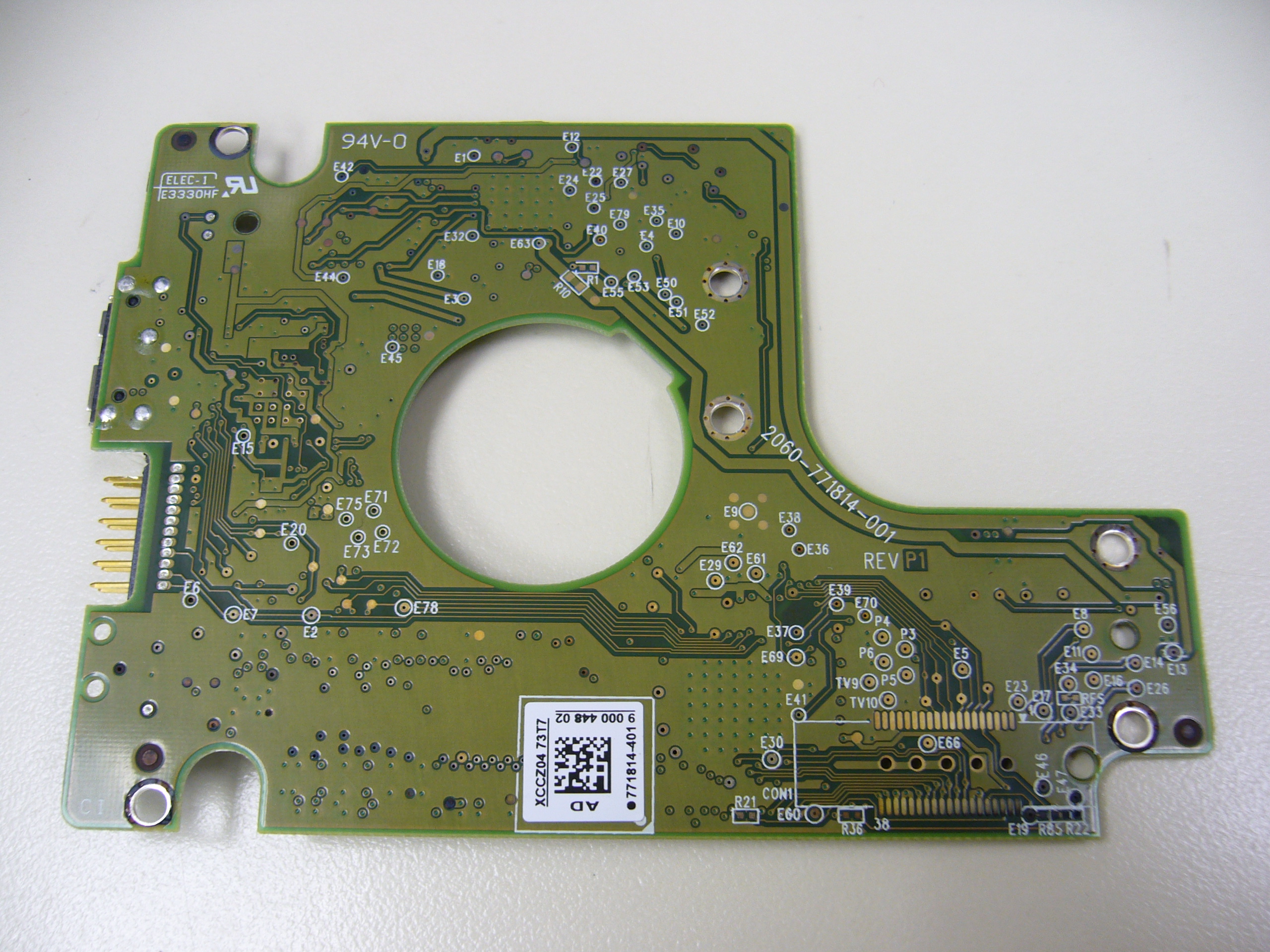

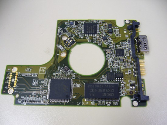

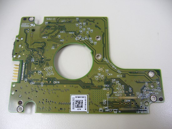

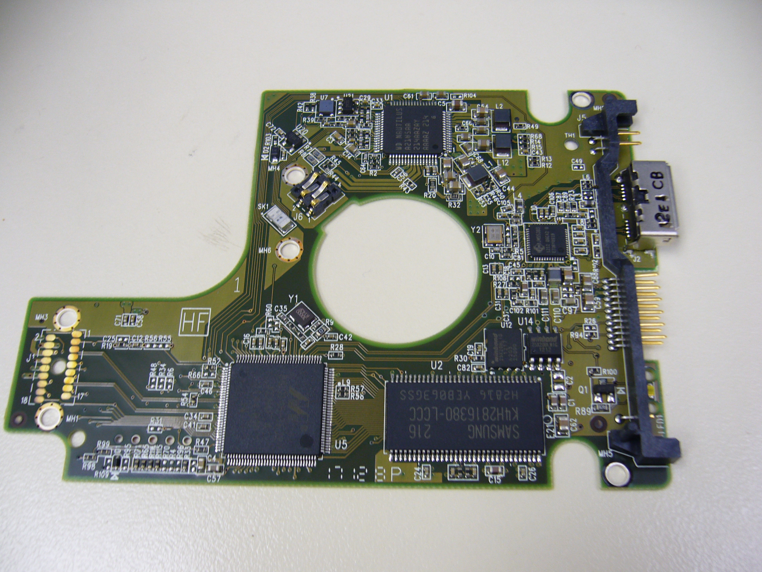

I'm currently involved in a recovery in which I require a compatible SATA board for a WD10TMVW-11ZSMS5. I have tried several with the same controller chip and none have work. Is there something I'm missing? If a SATA board cannot be found, would anyone know the points to solder a SATA connector to it? Thank you all for your help in advance.

You say you've tried a sata PCB with same controller (Marvel) chip, right?
Is the motor chip the same (in this case Nautilus)?
Did you transfer U12 chip?

Yes, I have tried it even with the same motor chip. I did not transfer the u12 chip I just copied the ROM and ROM modules to the SATA board and it wouldn't even power the drive. I have a total of 5 boards. I feel as if my last resort would be to find the sata point and solder a sata connector to it. Would you know per chance?

E71, E72, E73, E75

Which wires does each go to??
E71 -
E72 -
E73 -
E75 -
And where do you solder the grounds?
 Post subject: Re: WD10TMVW-11ZSMS5 HELP
PostPosted: March 19th, 2015, 16:45
Posts: 1388
Location: isreal
E71 - pin 2
E72 - pin 3
E73 - pin 5
E75 - pin 6
Ground (wherever you have on the board) - pin 1,4,7
Then remove capacitors: C13, C18, C31, C37
