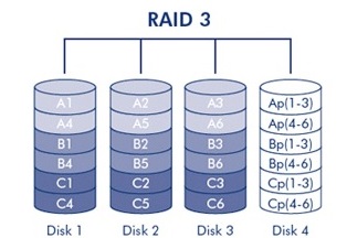

Anyone know of software to recover a Lacie with RAID3 (see attached configuration).

Generally you should be able to recover such RAID 3 with UFS Explorer Pro.
If not, I'll be happy to assist remotely.

It's also possible to create a RAID3 structure in R-Studio.

Are you sure it is setup RAID 3?

The client has 4 of these NAS boxes and set them all up the same. There is a counter on the back of the box that lets you select the RAID type rather than through software (older NAS box). This show as a RAID 3 set up (not with Spare). I can also tell that its byte level striping, so according to LaCie its a RAID 3.

Then, RAID 3 it is...it should be pretty easy to handle with R-Studio, I would think.

Can't get a good read in R-Studio or UFS Pro (which has RAID 3, byte level stripe as a default). Some significant corruption when the client tried rebuilding the RAID I think...... I will let you know how I get on.
