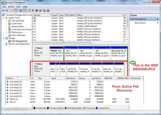

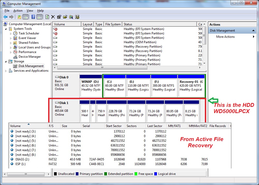

Disk management image attached with Active File recovery Partition info
I can't access any partitions data

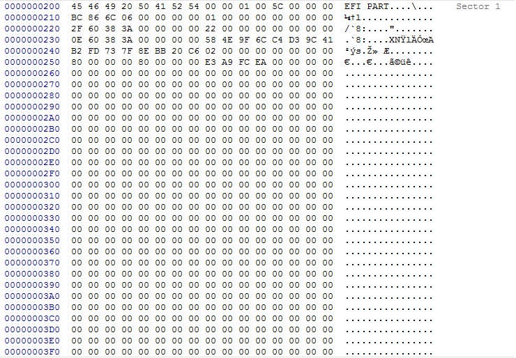

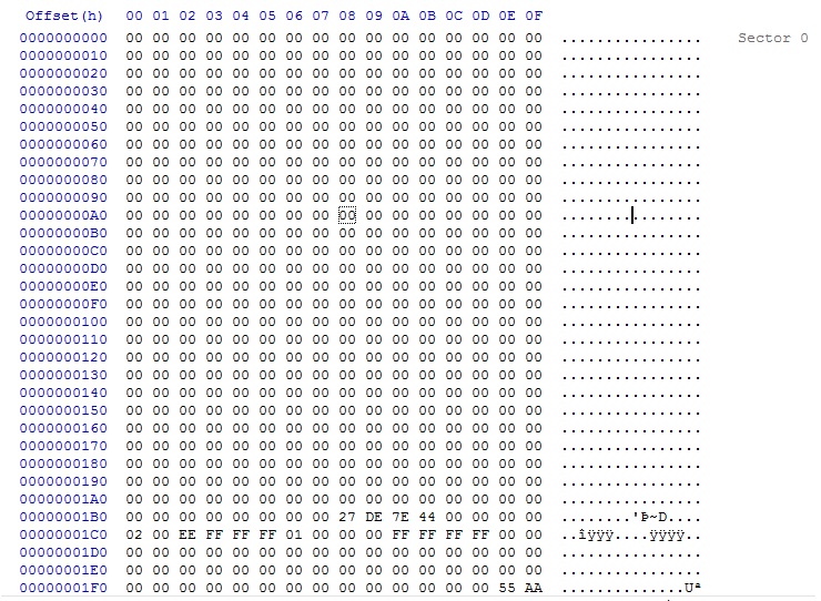

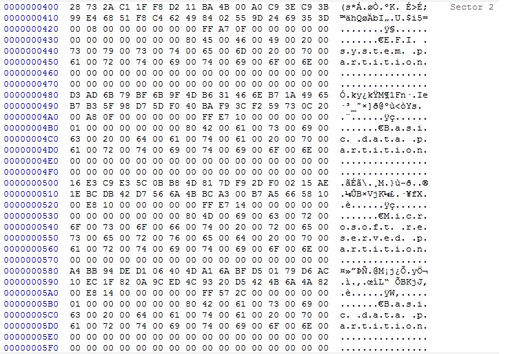

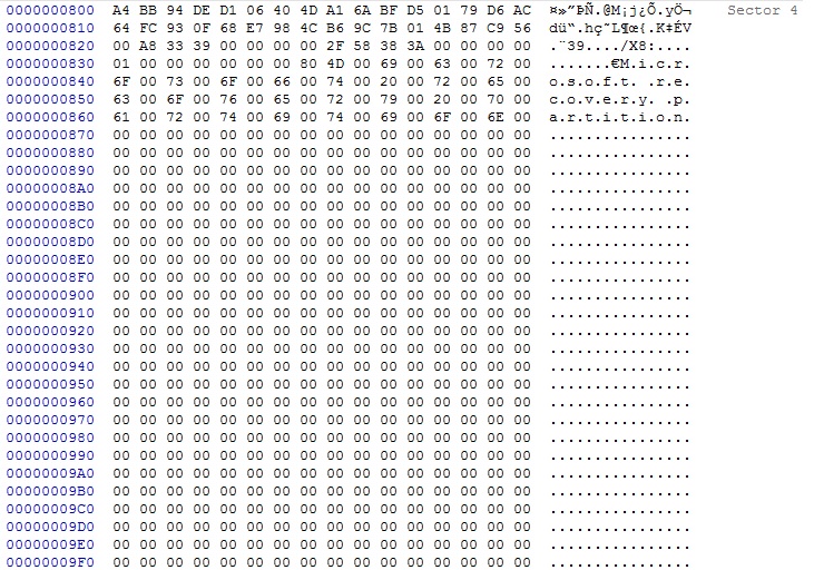

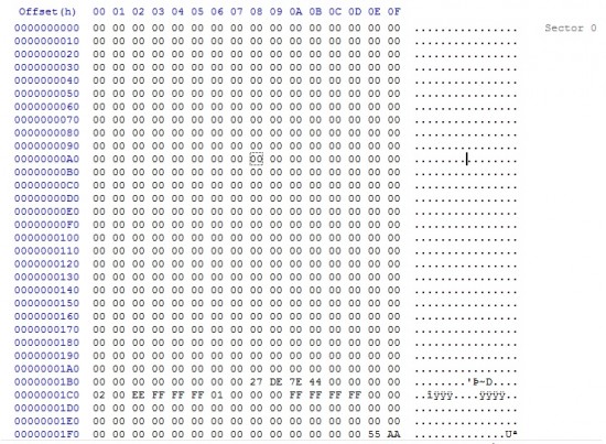

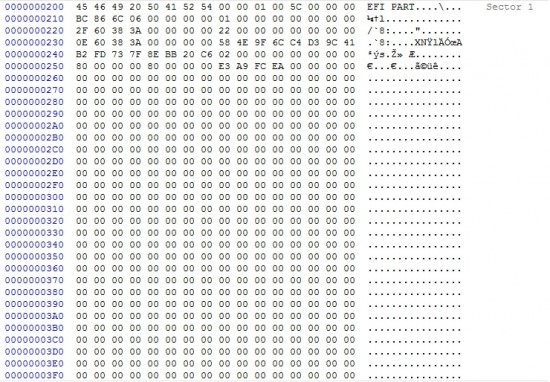

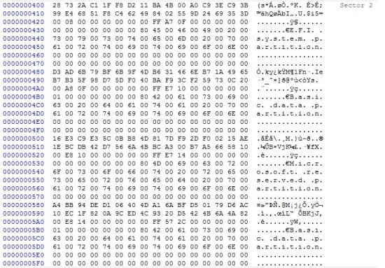

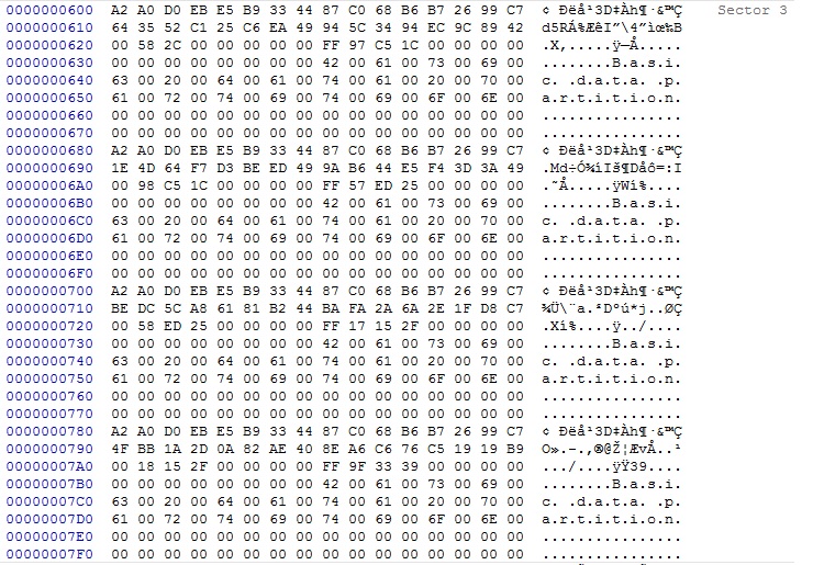

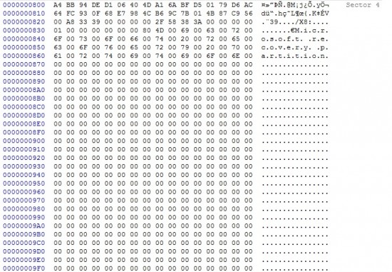

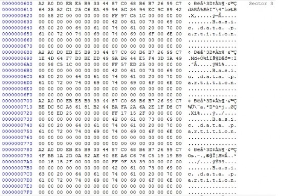

Added First 5 Sectors (HxD)
 Post subject: Re: wd5000lpcx P-list error
PostPosted: May 10th, 2016, 3:18
Joined: February 21st, 2006, 4:59
Posts: 109
Its looks like hdd is ok.
Must be a Logical problem.
does this disk belongs to dvr?
PostPosted: May 10th, 2016, 10:43
Posts: 17226
The GPT partition data appear intact. They match what Disk Management is reporting.
    start       end              partition
   sector      sector    size      type
    0x0800    0x0FA7FF  500MiB  EFI System Partition
  0x0FA800    0x10E7FF   40MiB  Basic data partition
  0x10E800    0x14E7FF  128MiB  Microsoft reserved partition
  0x14E800    0x2C57FF  750MiB  Basic data partition
  0x2C5800  0x1CC597FF  229GiB  Basic data partition
0x1CC59800  0x25ED57FF   73GiB  Basic data partition
0x25ED5800  0x2F1517FF   73GiB  Basic data partition
0x2F151800  0x39339FFF   81GiB  Basic data partition
0x3933A800  0x3A38582F    8GiB  Microsoft recovery partition
I would examine the first and last sectors of each "Basic data partition". You should see NTFS boot sectors (except for the first FAT32 partition).

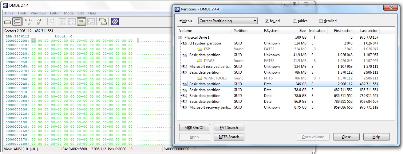

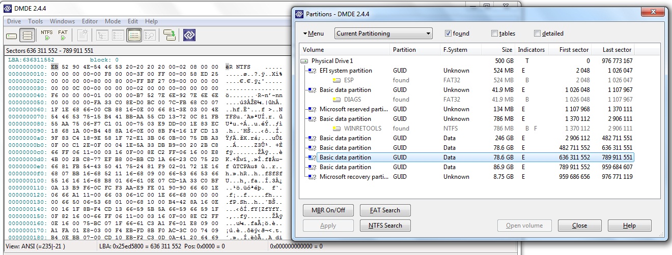

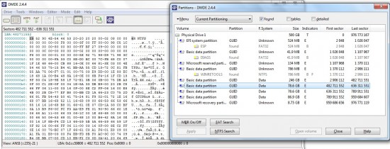

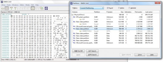

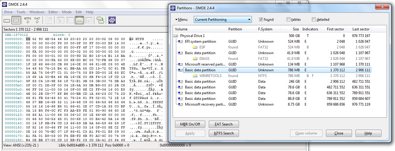

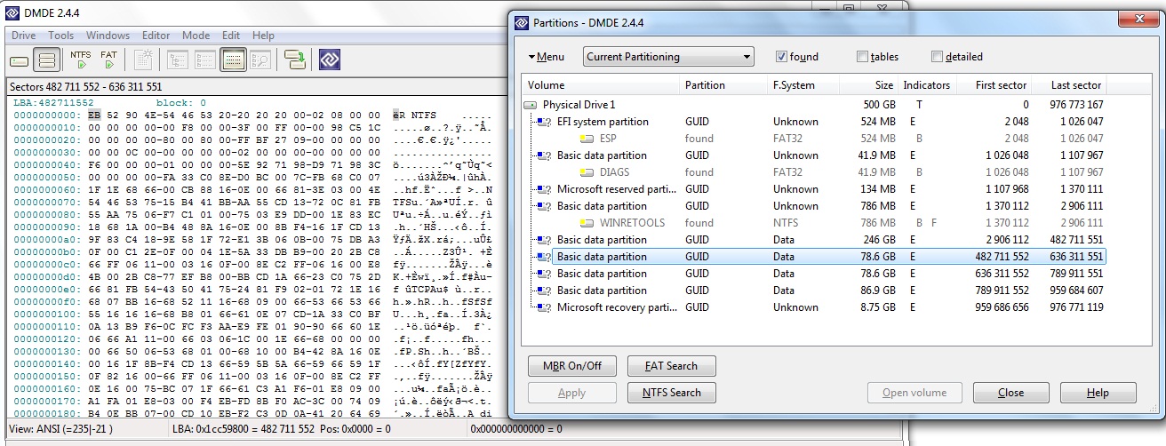

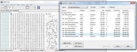

PostPosted: May 11th, 2016, 12:04
Posts: 347
Location: india

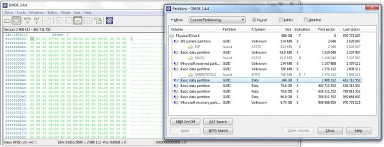

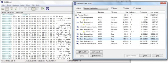

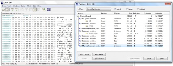

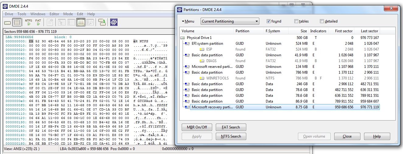

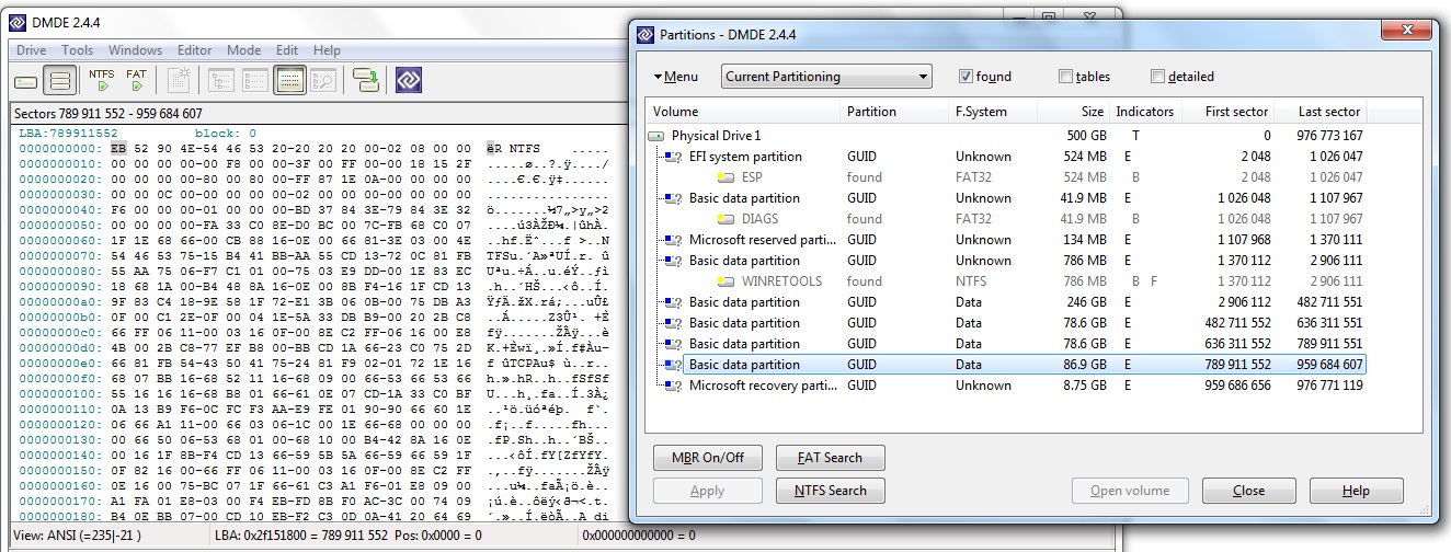

The 246GB / 229GiB "Basic data partition" has an empty boot sector but the other boot sectors appear to be OK. Therefore it seems strange to me that DMDE did not identify the boot sectors with a "B" in the Indicators column.
I would select each of the Basic partitions and perform an NTFS Search. This will look for MFT records, etc. Then Open Volume to examine any file/folder structures that DMDE finds. You can stop the search (and resume it at a later time) by saving the search results to a log file. Before beginning each search, I would scroll through the volume to make sure that it has not been zeroed, particularly the one with the empty boot sector.
