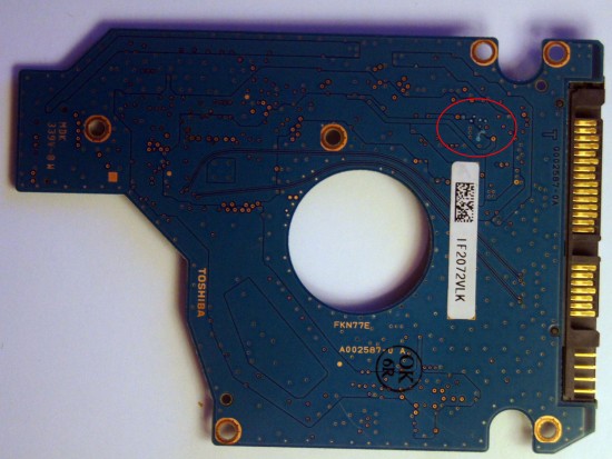

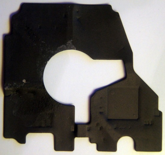

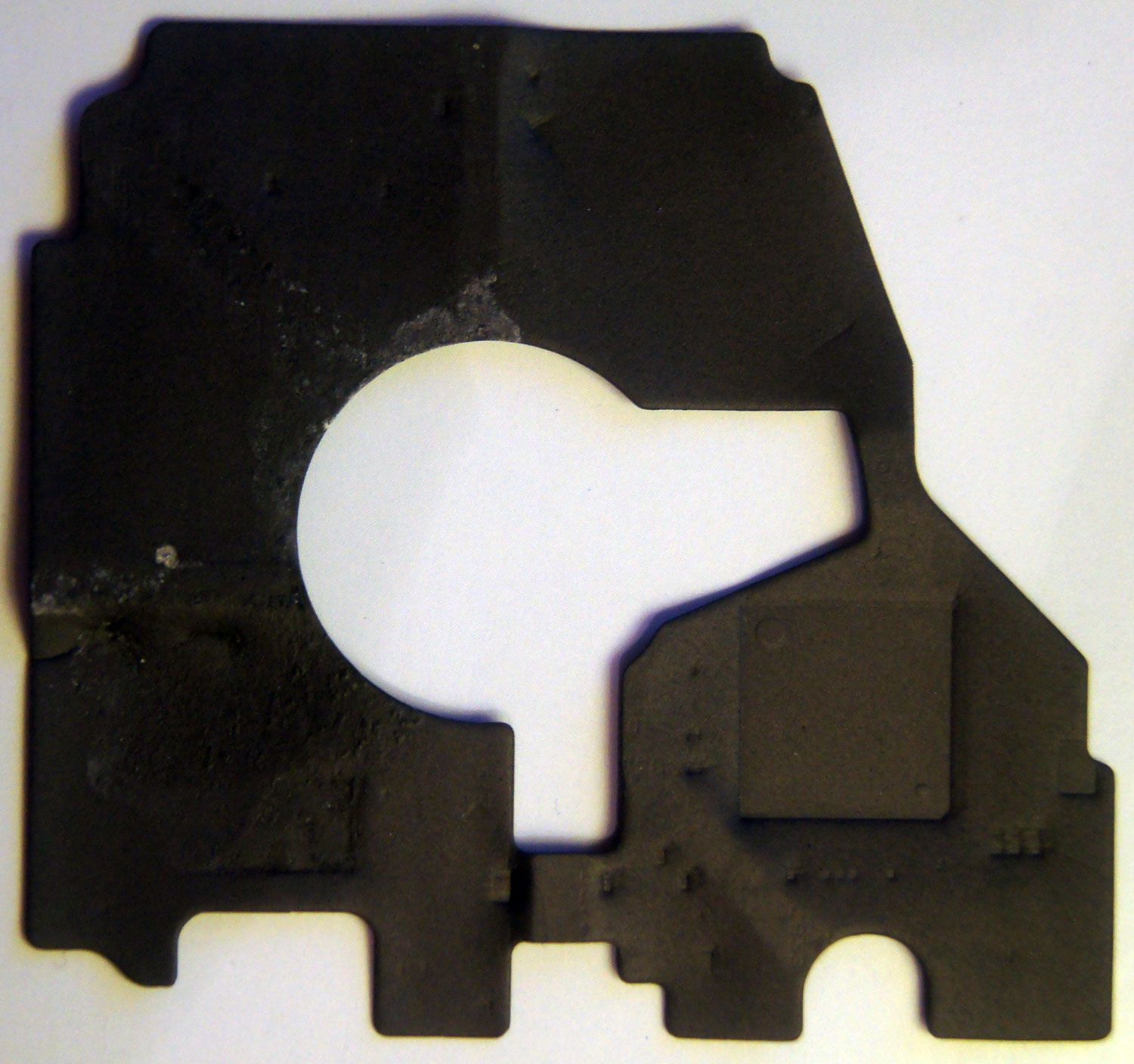

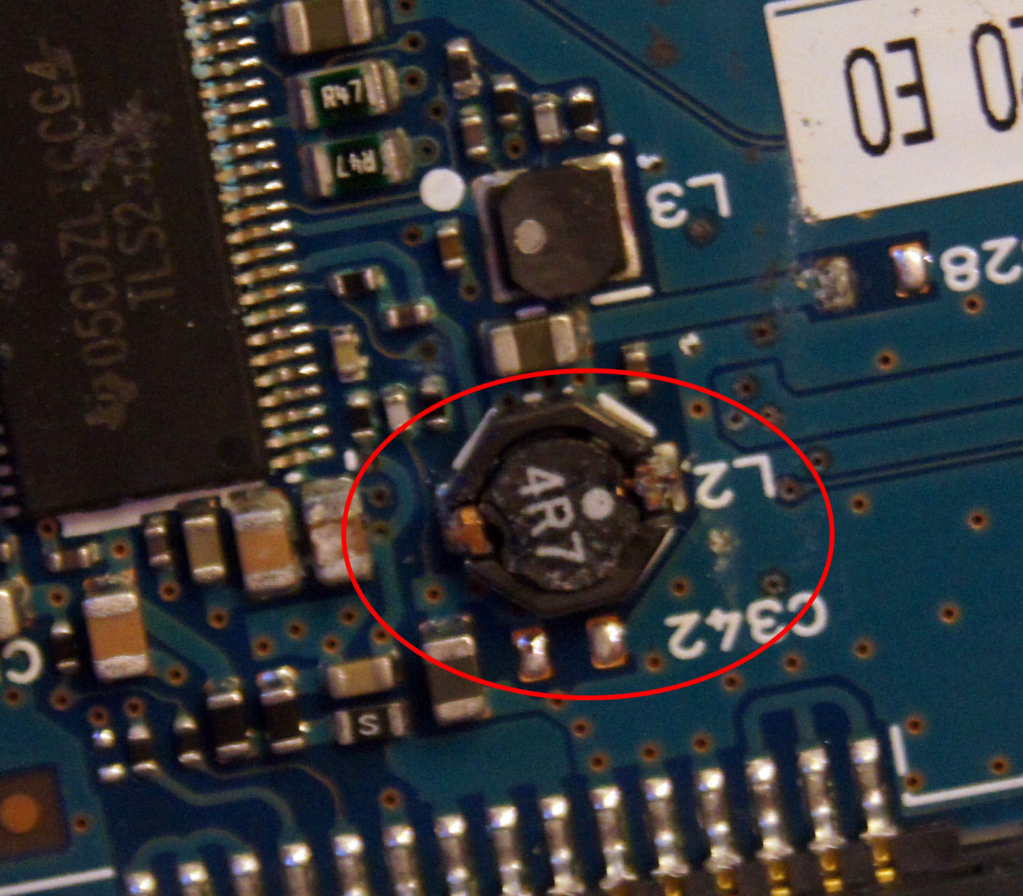

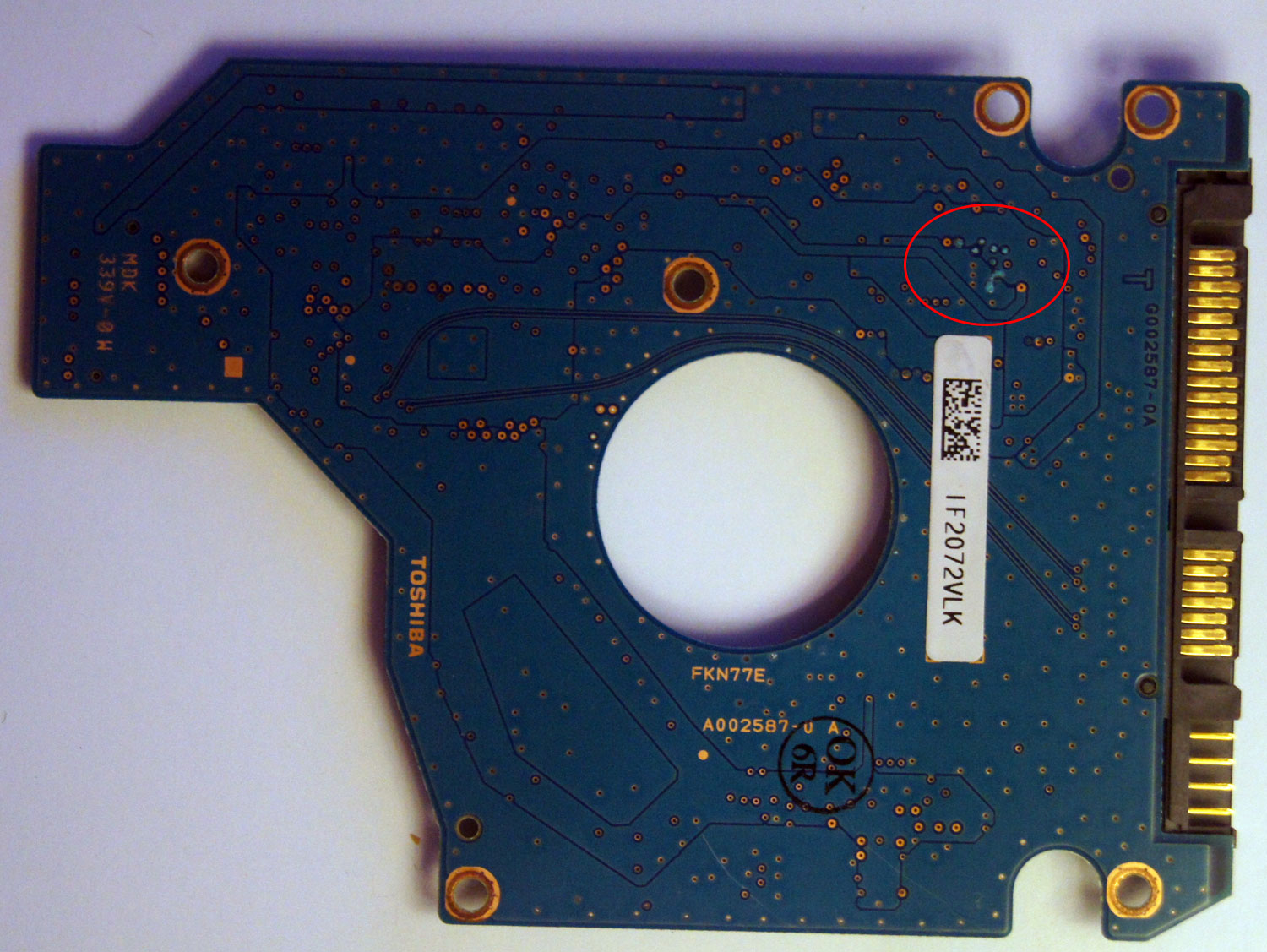

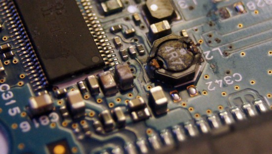

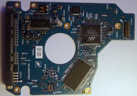

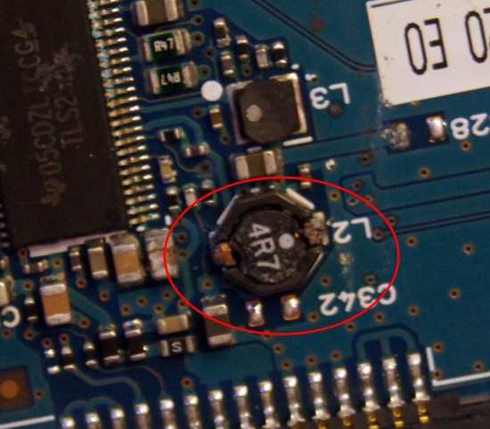

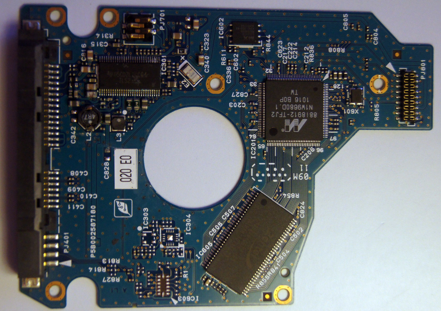

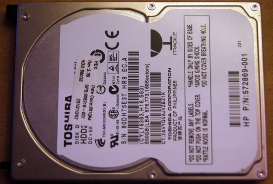

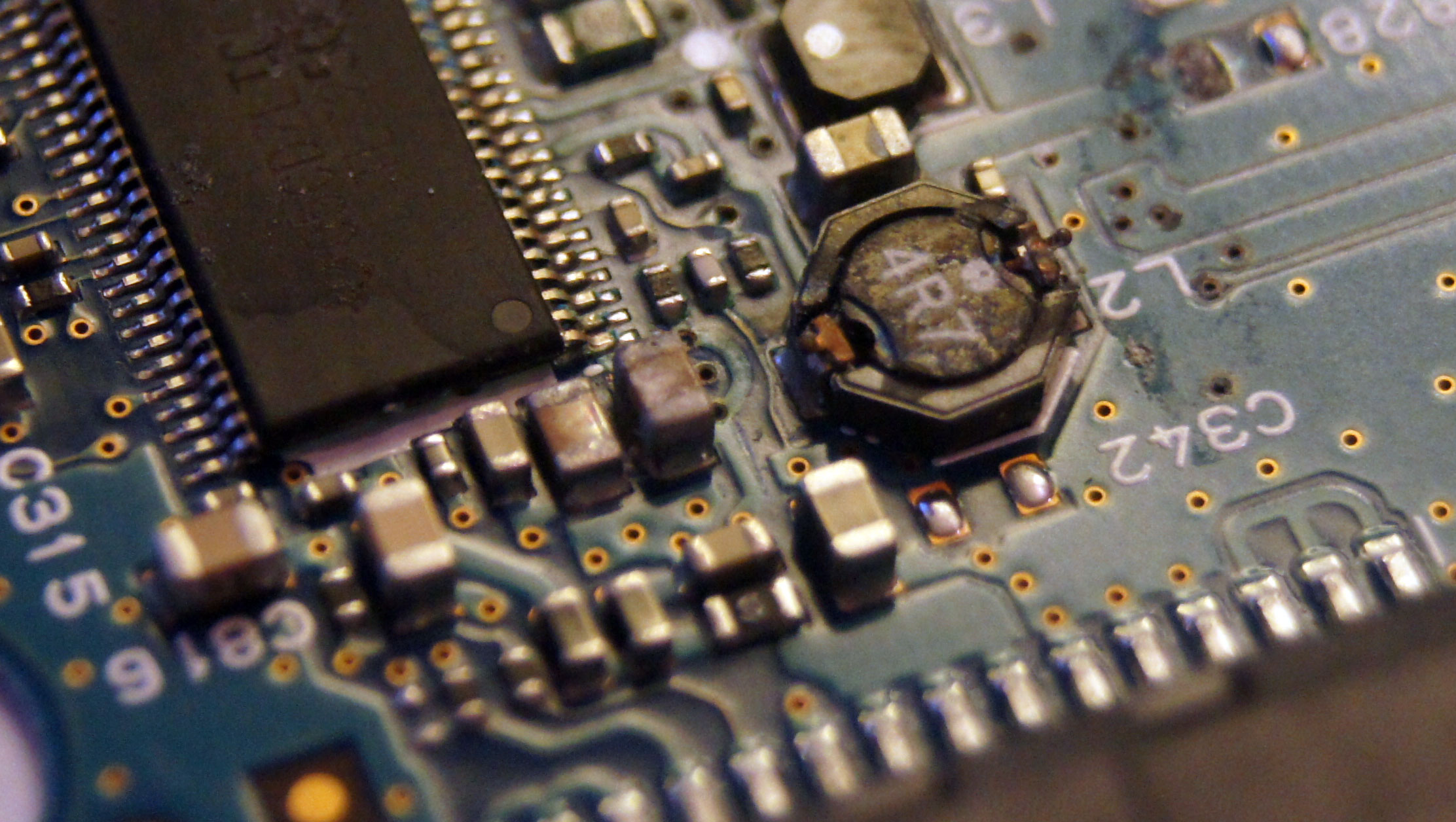

It is a Toshiba 500 GB sata HDDfrom my hp pavillion notebook. It has no physical damage. It just died after 6 month of usage. I used Spinrite to fix some bad blocks but after 2 days of run it can't be seen from even BIOS. I see some leakage there and 4R7 thing corrupted. Can you give me some advice on what is that and if it is possible to fix it. Some images are attached. I circled corrupted parts. Any help will be appreciated. Thanks.
I have a lot of questions.
What does it mean "it just died"?
Why did you use SpinRite?
How did you decide that the drive has bad blocks?
I have seen worse corruptions yet the drive would still spin up. Does your drive spin up?
If not, which is the most likely, you now need a new PCB and transfer of IC602 onto the new board. But since you left Spinrite run for two days, you might have bigger problems now. Spinrite is a drive killer.
If it does spin up, then you have other problems.
In any case, if you value your data, take this drive to a professional to evaluate it.
If the data is not very important and you want to experiment, do what I described above, and hope that spinrite did not turn the drive into FUBAR.
Good luck
The 4R7 coil (L2) appears to be part of the Vcore regulator. The L3 coil is probably the Vio regulator. As bad as they appear, if the drive is spinning, then they would be OK.

northwind wrote:
Good luck
I meant it stops spinning by 'just died'.
OS started to freeze from time to time. Spinrite showed there were some bad blocks.
I have no valuable info on that drive. I checked the prices of new PCB and 500GB HDD, they are about the same (~40$). So I think it is better to buy a new one.
Thank you for help.
 Post subject: Re: Is it possible to fix that HDD. Toshiba 500GB.
PostPosted: March 30th, 2015, 9:09
Posts: 3551
Well yeah, if the drive has no valuable data, just buy a compatible PCB and swap IC602 and you're good to go, hopefully.
If your soldering skills aren't good and have no prior experience in swapping these kinds of chips, I suggest you ask someone skilled to do it for you, because if you damage the chip in any way, then you can forget about your data.
By the way, when you say 'it stops spinning', does it mean it DOES spin up and then stops spinning, or it just doesn't spin up at all? It's two different things. However, it's rare for toshibas to spin down due to mechanical failure. Just sayin.
