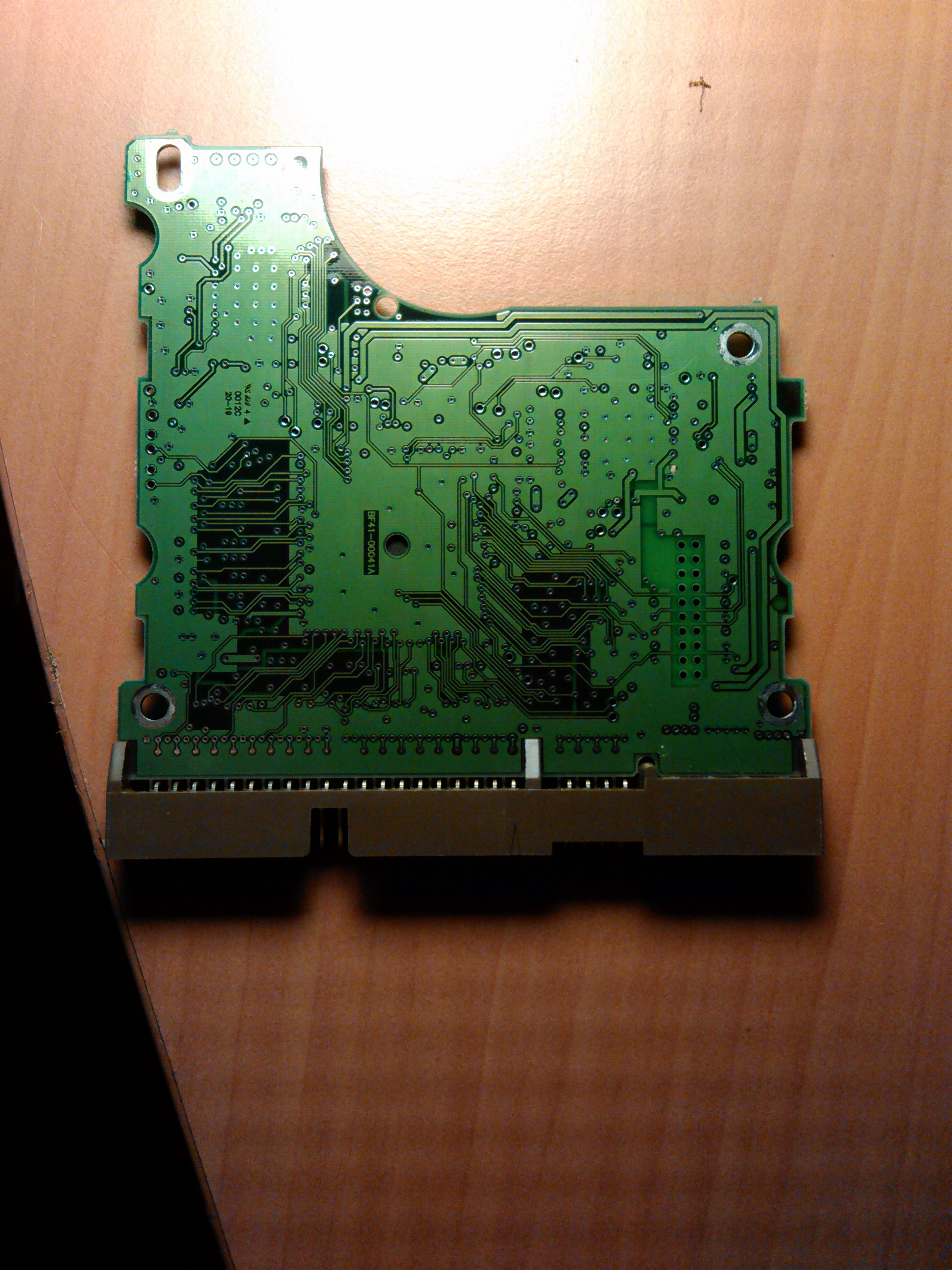

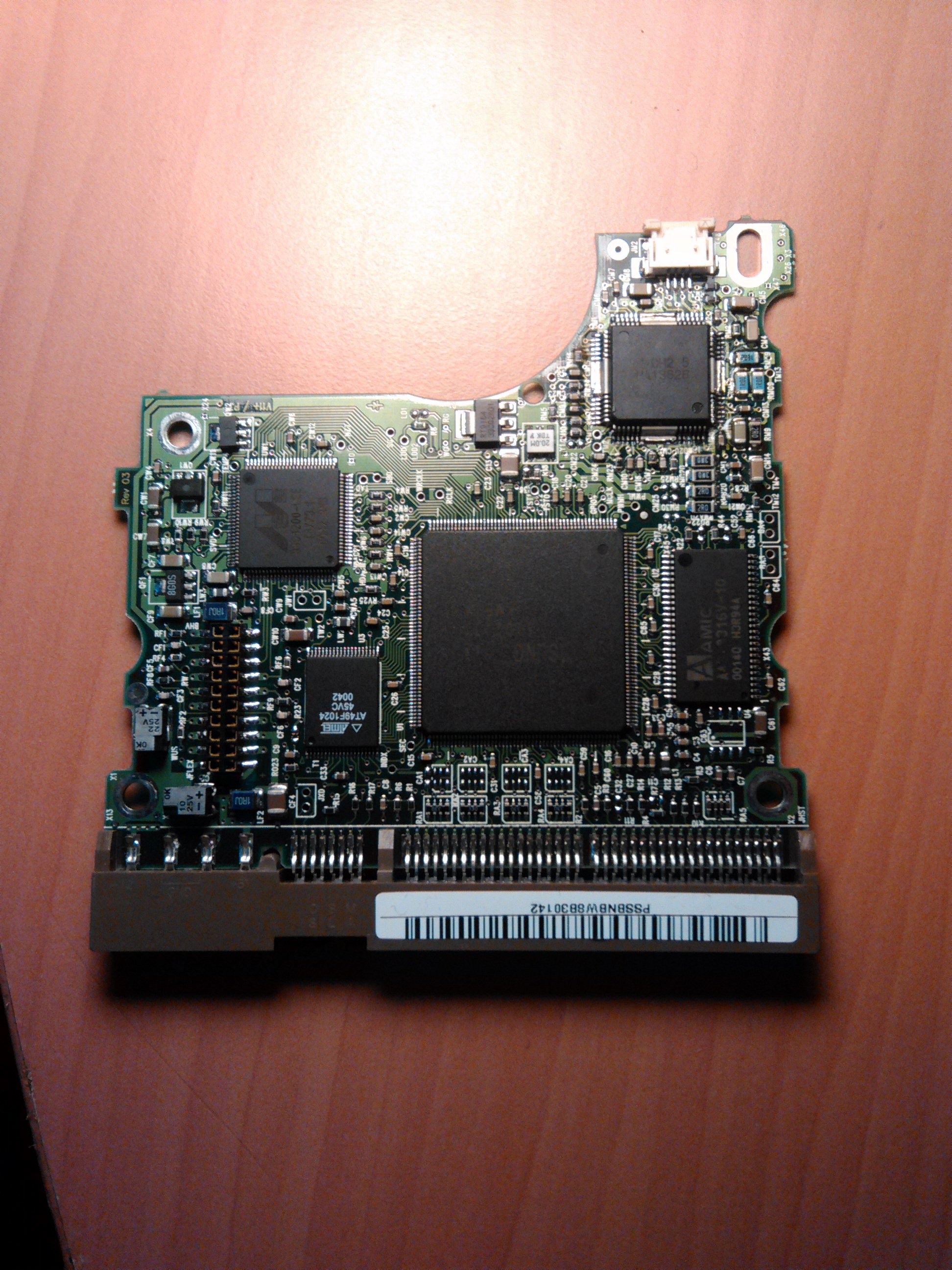

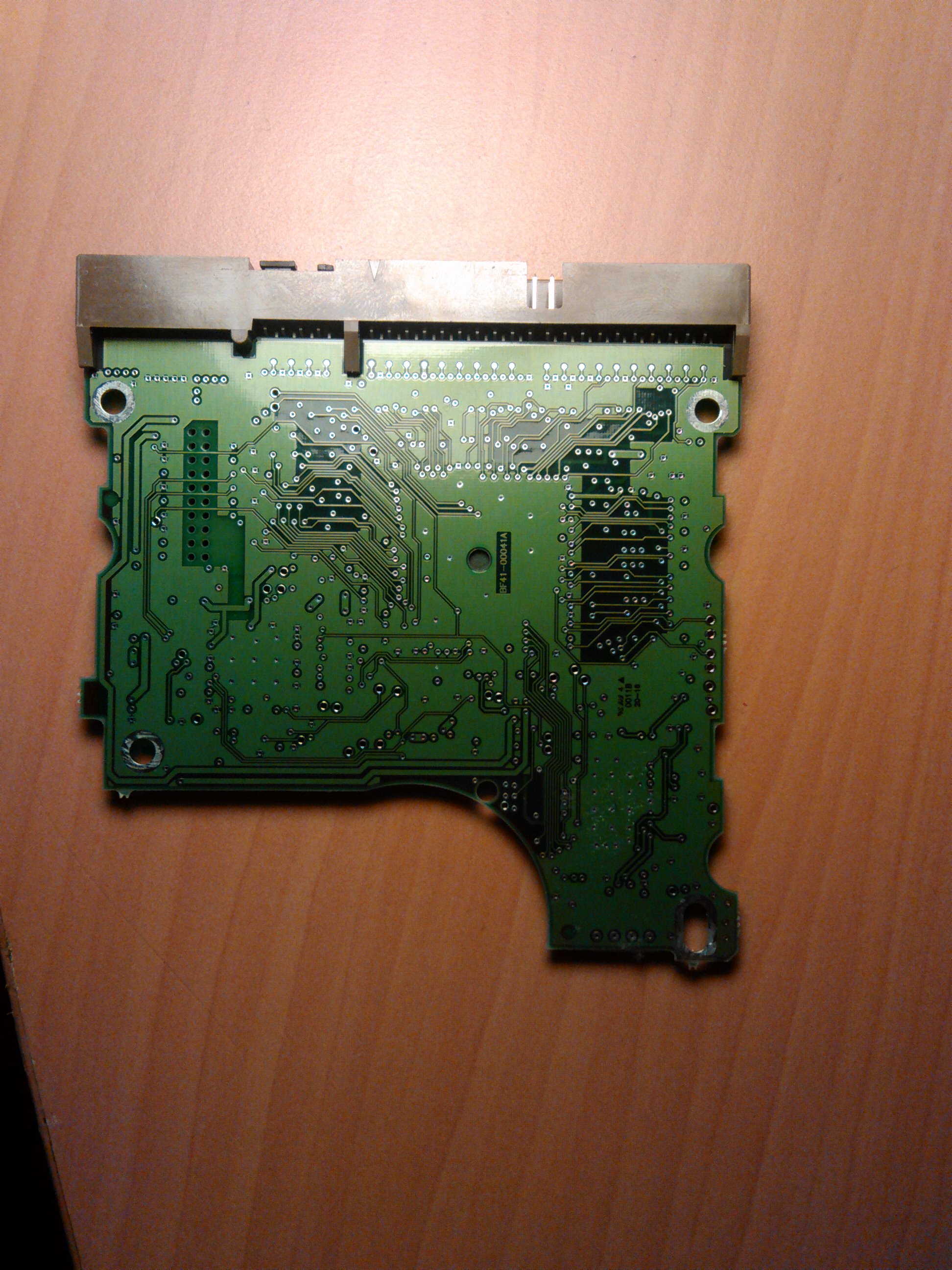

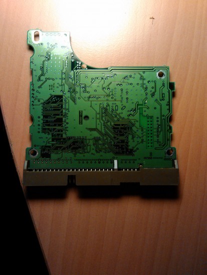

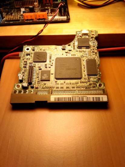

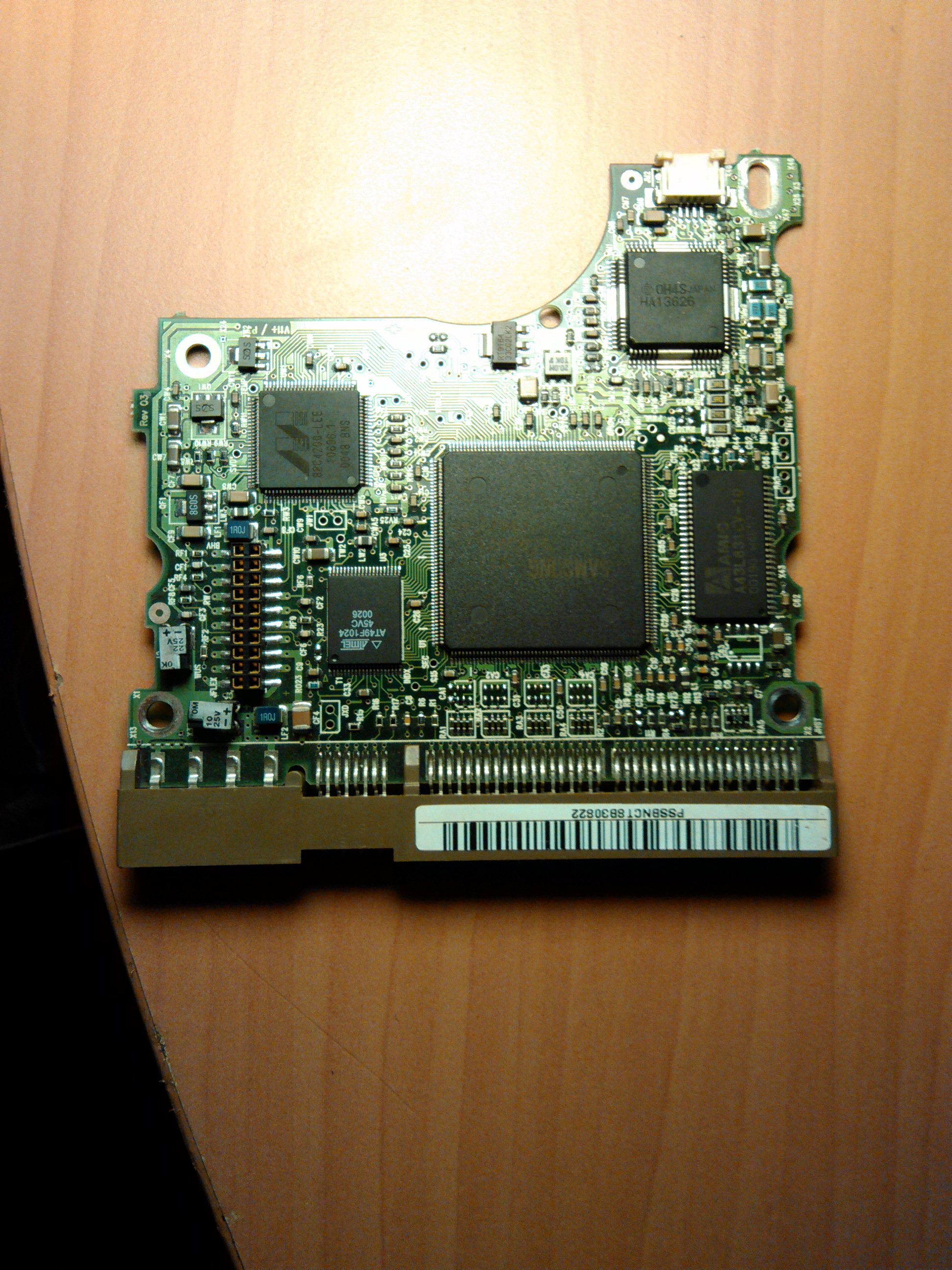

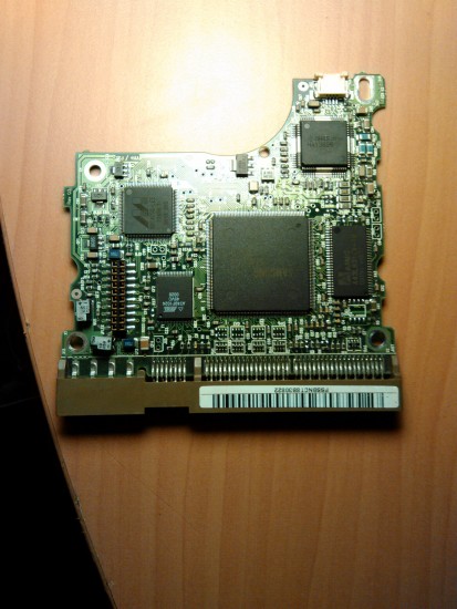

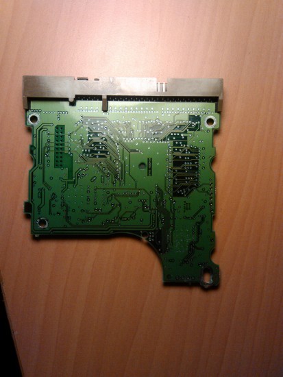

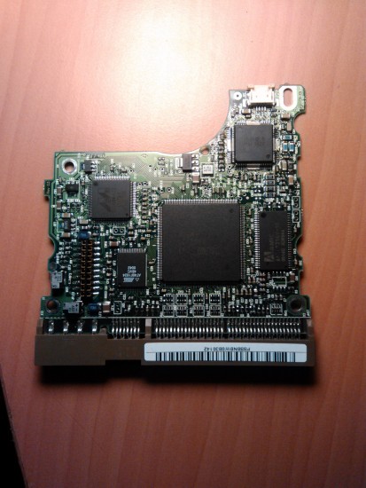

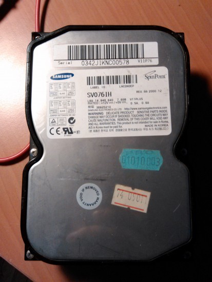

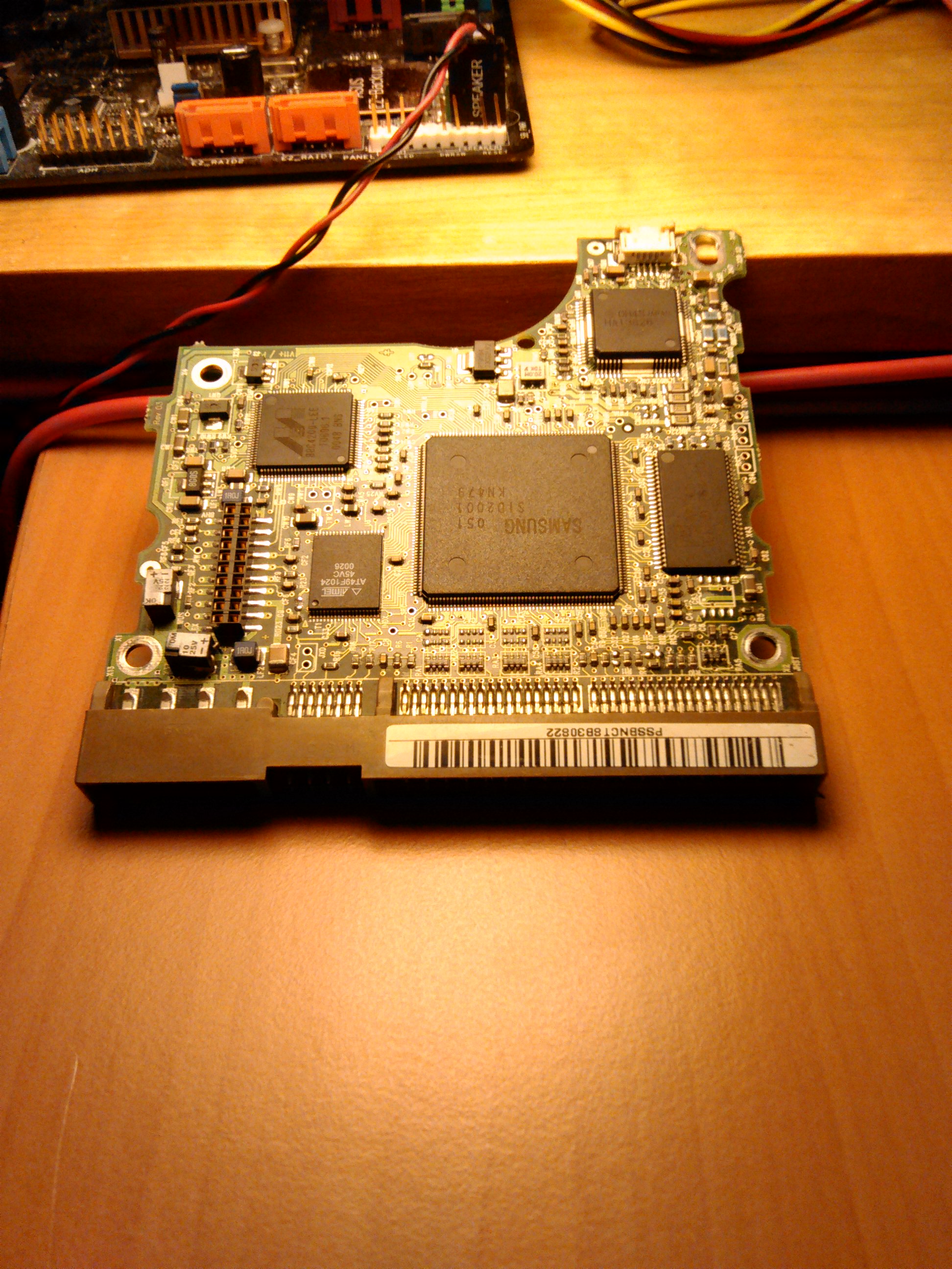

Hello folks,
Thank you very much for your reply.
First of all @data-medics, i do not consider you rude, but you are over underestimating someone that you do not know and your answer it's off-topic, but i do not mind as everybody it's free to answer whatever they want, i do not feel offended in any way. :)
@fzabkar, thank you very much for your reply. I was suspecting that pin having to do something with the HDD communication to a terminal, but i just couldn't find that info, however i didn't searched too much as these drives are just sitting for some years and i decided to have them fixed as the problem , indeed, seems to be power related or something...like a bad voltage regulator which when on load cease to function...anyway ! I will study the documents and see if they enlighten me !
Attached are the photos of the PCB'S and the filename of each photo represents the HDD model. For one model i put two chip side pics as i do not like how one of them looks, but hope they are good enough. You can magnify the pics and they look very good actually.
Thank you very much for your kindness.
Alex.

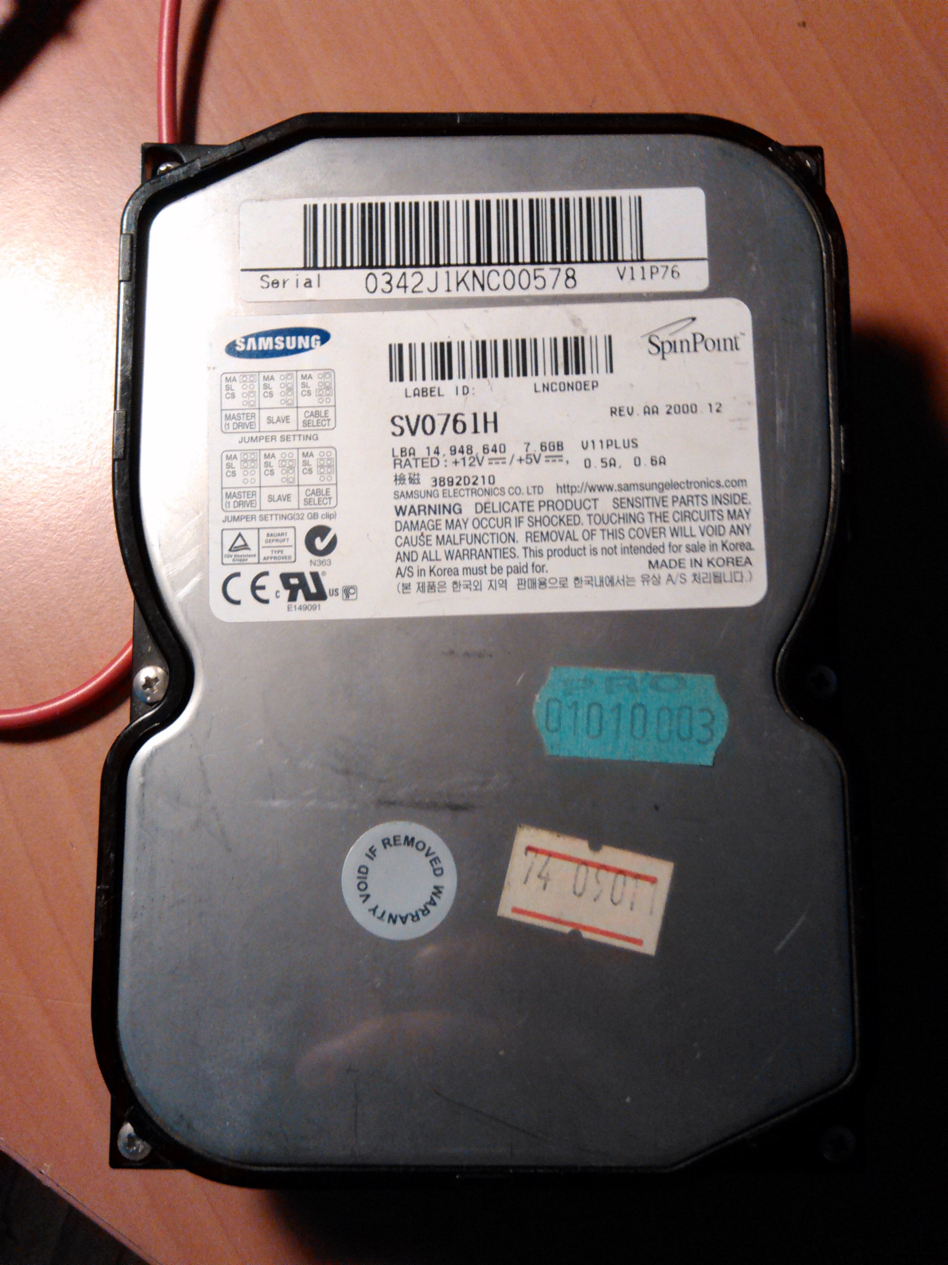

@fzabkar: i must say that after reading those two articles, they surely enlighten me. Thank you very much for your kindness and information.
After reading the post about the terminal connection for the Samsung drives a possible scenario came up to me, regarding these two Samsung drives. It goes like this : On the sticker they have a schematic of how to set up the drive to be SL, MS or CS...The schematic it's very ambiguous as you can not tell how it's lined up with the power connection and the IDE connector so one could accidentally short pins TX/RX when setting Master.
In the case ( very probable ) that this was done and maybe that's why it doesn't start, shorting the Tx/Rx pins could damage a part , or maybe the drive entered a protection mode of some kind...whatever the outcome of shorting those pins would be i think this the right place to start,,,pins shorted on Tx/Rx
Below you have a photo of the sticker on the HDD with the set up pins. As you can see you can not tell if you should short pins from the left or pins from the right to set Master. Also the print on the PCB plastic, adjacent to the pins it's very hard to see

Here is a tutorial that I wrote when I was working with an older Samsung PCB.
Tutorial - how to locate the basic test points of an unfamiliar HDD PCB:
http://www.users.on.net/~fzabkar/HDD/Tu ... 0411N.html
Your BF41-00041A PCBs are a few years older, but the tutorial should still be helpful.

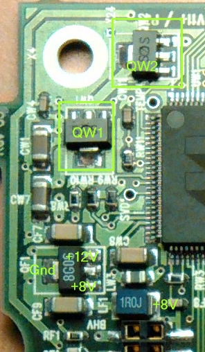

I usually begin by identifying the major ICs and their power requirements. The 88C4200 Read Channel and A43L8316V SDRAM require 3.3V, so I would be looking for a 3.3V regulator. This appears to be the RT9164.
The "8G0S" device (QF1) is probably an 8V linear regulator. It appears to supply the preamp via an 1R0J inductor (LF1).
I haven't determined the function of transistors (?) QW1 and QW2, but it appears that all "xWn" components are associated with the read channel. Similarly, all "xFn" components appear to be associated with the HDA connector/preamp.
I would measure the test points identified in the attachments.

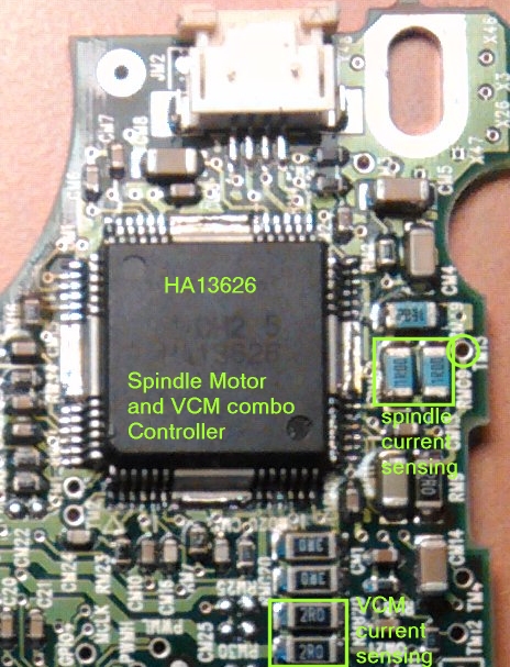

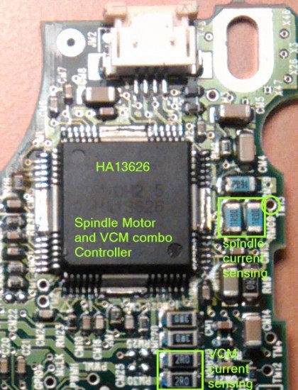

It sounds like your drives have a seized spindle bearing or a stiction fault (heads stuck to platters). The PCBs are probably OK, but you could check around the motor controller (HA13626), and measure the resistances of the motor windings.
You could also measure the spindle motor current, probably at the 1R00 resistors.
Measuring VCM and Spindle Motor Current:
http://www.hddoracle.com/viewtopic.php?f=59&t=204&p=484

After doing some measurements here's what i compe with :
1. According to the schematic for the IC 13614FH ( i guess it's close enough , i couldn't find the exact datasheet ) we have the following :
Pins: 20,21,27 control the 3 phases, they go directly to the motor. With the motor disconnected i get a good reading to ground, about 0.5 ohm , 99% pure ground. This is the spindle controller. On the sensing resistors, of course i get nothing with the hdd plugged in the power source. The spindle driver it's feed by a mosfet. The mosfet gets power in the drain at pin 31, the gate it's controlled by the brake control inside the IC and the source exists on pin 31 and goes to pin 28 were it feeds the spindle driver. I checked the drain to ground, no problems and the source to ground and again no problems.
After letting the hdd to sit for about 30 minutes ( without power ) the short on the phases pins disappears, but as soon as i connect power to the drive the condition occurs again.
The only problem seems to be the output for the phases, they are ground, which might explain the cycle, short.
2. The VCM current sense resistors are getting pulses from 20 mV to 55-60 mV according to the noise, the frequency it's the same, which i think it's normal as long as i have that short on the spindle driver.
The motor measures 2.7-3.0 ohm from COM to phases and 5.0-5.4 ohm between phases. I do not see any problem here.
Judging by all this i think that the IC it's bad, what do you think?

The uppermost MOSFET is turning on, so it's OK. ISTM that the low-side MOSFETs for each of the motor phases are OK also. The reason that they test shorted and then recover could be due to residual capacitance which is turning them on until the capacitance decays.
I don't know why you are measuring activity at the VCM current sense resistor, but that could be just my lack of understanding. I would measure the voltage across the motor current sense resistors (ISENSE). That should tell you whether there is any current flowing through the motor. I would have expected that you would see voltage pulses at each of the motor phases.

No current flowing thru the motor. Just those pulses at the VCM, which after a period disappears completely, something it's shutting down... and then after a time it begins again the same cycle of on and off at a very low voltage...but indeed nothing on the motor spindle.
I will investigate further and come with results, if any :)

I haven't been able to find a good photo, but there are two "BC" components (QW2 and QW1) that look like they may be power related. Can you tell us the voltages at these components (and upload a detailed photo)?

As I have no information about these transistors(QW1 and QW2) So I measured its voltage in the same way as 8G0S device(QF1).
I placed black probe on largest pin on the top and placed red probe on pin1 and pin3.
It was measured 0.025-0.028VDC between pin1 and largest pin and measured 0.645-0.648VDC between pin3 and largest pin.
