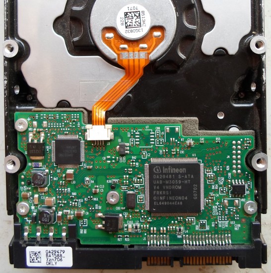

Hello everybody,
Yesterday, my HDD stopped spinning. I think, I am not sure, that a shortcut circuit with the desktop case happened while the HDD was running. Apparently, there is no sign of burn.
First, I cleaned up the PCB and checked the voltage at J3 (input voltage for the motor) = 0v.
At this moment, I replaced the PCB with another working hitachi family (not the same family) the motor did spin (=>the problem is not the motor).
I don't want to try hotswap and nvram resoldering for now, I just want to leave it as my last resort.
Any suggestions, schematics ,partial or full support, are welcomed. Thank you.
P.S.: The picture of the pcb is attached

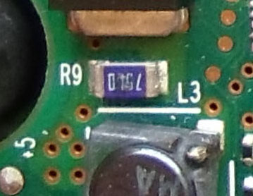

The D2 is good, I checked. However R9 resistance is short-circuited. Do I just need to replace R9 only or check something else before running the HDD on?

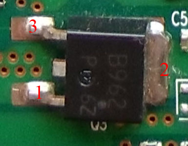

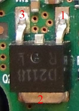

I would measure the voltages at transistors Q1, Q2, Q3, and coil L3.
Compare the resistance of R9 against your working board.

R9 has been changed successfully,it was broken, but the HDD is still not spinning.
As requested, the voltage of Q1, Q2, Q3 are as follow:
Q1 1=2.56 2=1.54 3=3.29
Q2 1=3.97 2=5.29 3=3.29
Q3 1=3.29 2=1.58 3=2.60
I pray to god it will not be the IC motor, my live depend on that HDD.

It looks like the Vcore and Vio voltages (1.6V, 2.6V, 3.3V) are present.

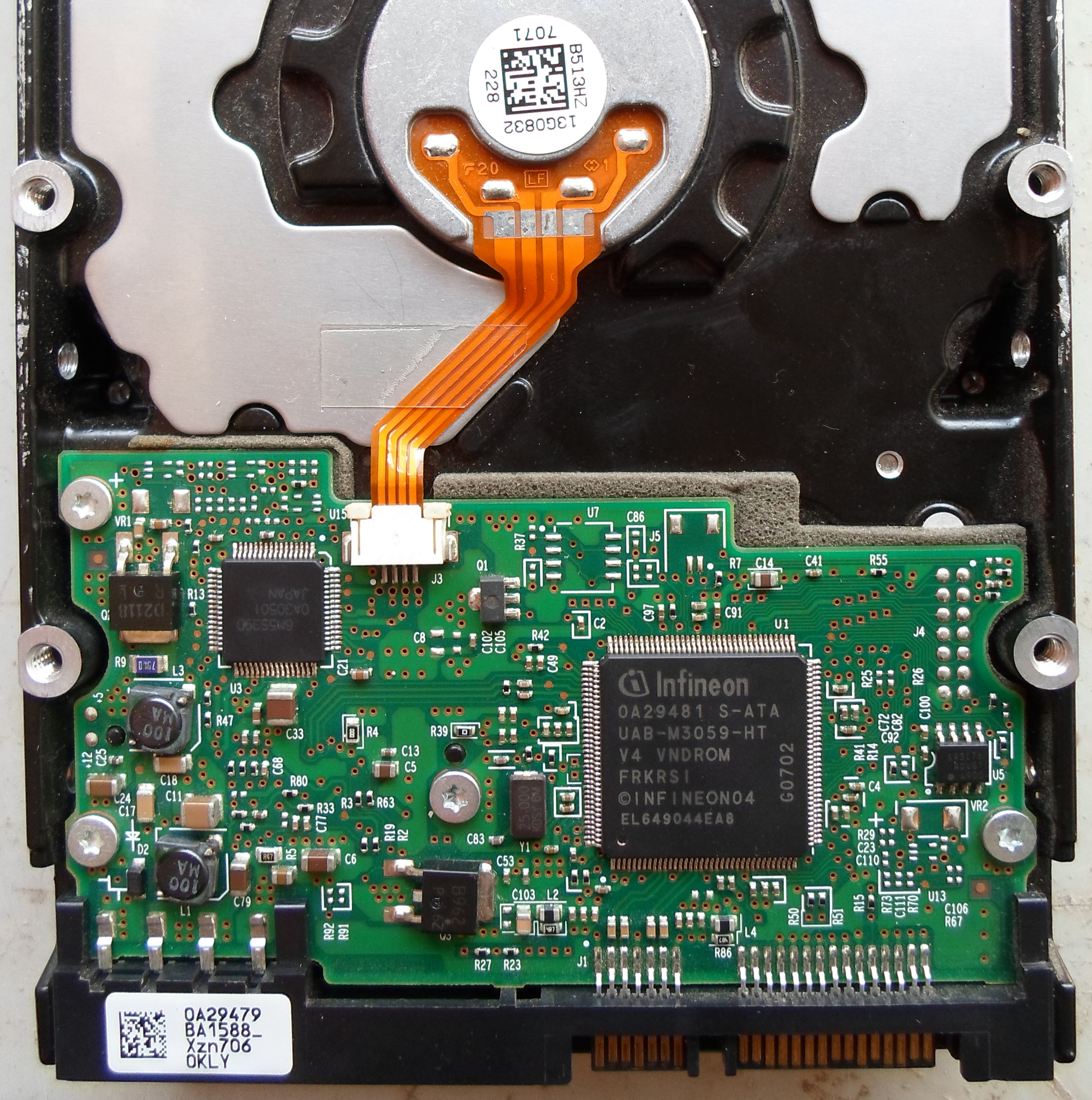

I should have asked for the L1 coil as well. L1 and L3 constitute a Cuk regulator which supplies -5V to the preamp. Do you measure -5V at L1?
Other than those measurements, I don't see what else you could do other than measure the resistances of the zero-ohm resistors and the two 4R7 resistors below the MCU, plus L4 and L2. There is also R5 (R47) near the lower 100uH coil.

here are the measurements:
L1 = -3.03v
4R7= 0,8 ohm
L2 and L4 = 0,8 ohm
R5 (R47) = 1 ohm

Everything looks OK to me. The resistance measurements would be affected by the resistance of the meter leads.
If the NVRAM is OK, then ISTM that a PCB swap and chip transfer would be your next logical step.
