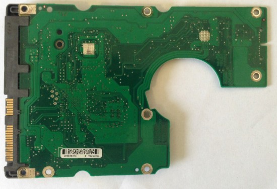

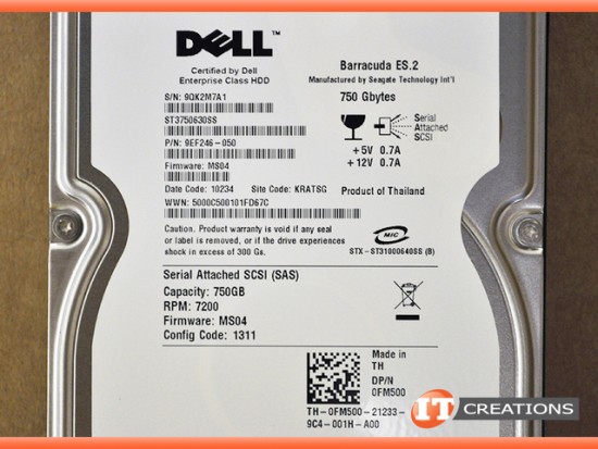

hello everybody how are you hope you will fine. todya i am facing sas hdd in bad sectors so i want to try termnal access but i can not access terminal can any one have suggesst me how can i access terminal thanks in advance

Thanks For your reply spildit i want to refurb this drive don't need data and getting new experiance please tell how can i access terminal
 Post subject: Re: st3750630ss sas harddisk
PostPosted: April 19th, 2015, 12:47
My approach with a drive like that is to see if you can ddrescue it. If it's impossibly slow, or only has partial sector access you might be able to use plscsi to rebuild the translator. I've never personally done it with an SAS drive, just SCSI, but I assume it should be possible to accomplish. Hard part is finding an SAS card with actual DOS drivers. :shock:
