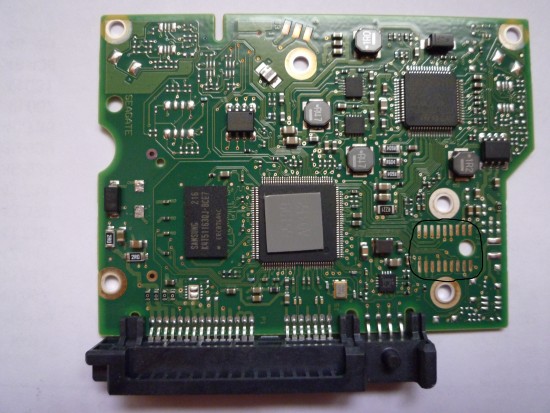

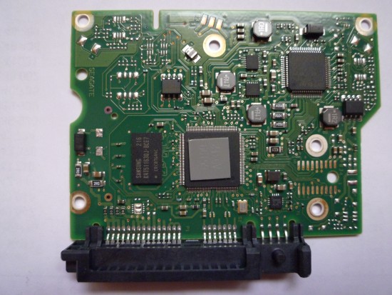

 Post subject: Re: Dead 3Tb Seagate (ST3000DM001)
PostPosted: November 23rd, 2012, 5:26
Joined: November 23rd, 2012, 3:10
Thank you for your quick reply.
I uploaded a picture of my PCB, but I don't know if it is sufficiently clear. Please let me know if you need more detailed pictures.
PostPosted: November 23rd, 2012, 6:01
Posts: 17316
There are 4 zero-ohm resistors near the SATA power connector. The two on the right are probably open circuit.
Unfortunately you say that there is still a short circuit at the 5V TVS diode pads. This points to a failure of one or more components on the +5V supply. Potential culprits would include the motor controller and the two LX7157B PWM controller ICs adjacent to the R47 coils. I suspect that the chip near the 1R2 coil may also be powered from +5V, as well as the 6855A chip near the jumper block.
The flash memory is the chip located above and in between the SDRAM and MCU. Measure the resistance between its power pins (pins #4 and #8).
The upper rightmost three pins in the preamp contacts appear to be the +5V, ground, and -5V pins for the preamp. You might like to do resistance checks at these points with the PCB mounted on the drive. This will tell you if the preamp is shorted.
EN25S40, Eon Silicon Solution, marking cFeon S40-75GIP, 4 Megabit 1.8V Serial Flash Memory with 4Kbyte Uniform Sector:
http://www.essi.com.tw/upfile/p20122717317.pdf
LX7157B, Microsemi (MSC), step-down PWM regulator IC with integrated high side P-Ch MOSFET
and low side N-CH MOSFET, 2.2MHz, 3V to 5.5V:
http://www.microsemi.com/document-porta ... -lx7157bds
PostPosted: November 23rd, 2012, 6:28
I measured the components as you indicated.
Each one of the four 0-ohms resistors state 1 ohm.
Pins #4 - #8 state 759K.
I still didn't measure the preamp contacts, but can this measurement risk the preamp in any way?
Thank you for your help.
PostPosted: November 27th, 2012, 17:15
Posts: 17316
If by "1 ohm", you mean 1.0, then that will be the resistance of your meter leads, in which case the resistors are OK. However, if you mean "1", then this is indicating that the meter has overranged, in which case both resistors are open and I would expect that there will be a problem on both the +5V and +12V supplies.
As for risk to the preamp, IMO that's just DR mythology that has taken root long ago and is taking forever to die. Sure, the heads are susceptible to ESD, but if you take standard ESD precautions, then I can't see why the preamp is any more delicate than any other IC, CMOS or otherwise. In any case, you will be testing the IC's +/-5V power pins with a multimeter whose open circuit voltage is 0.55V on the 200 ohms range, and whose short circuit current is only 100uA.

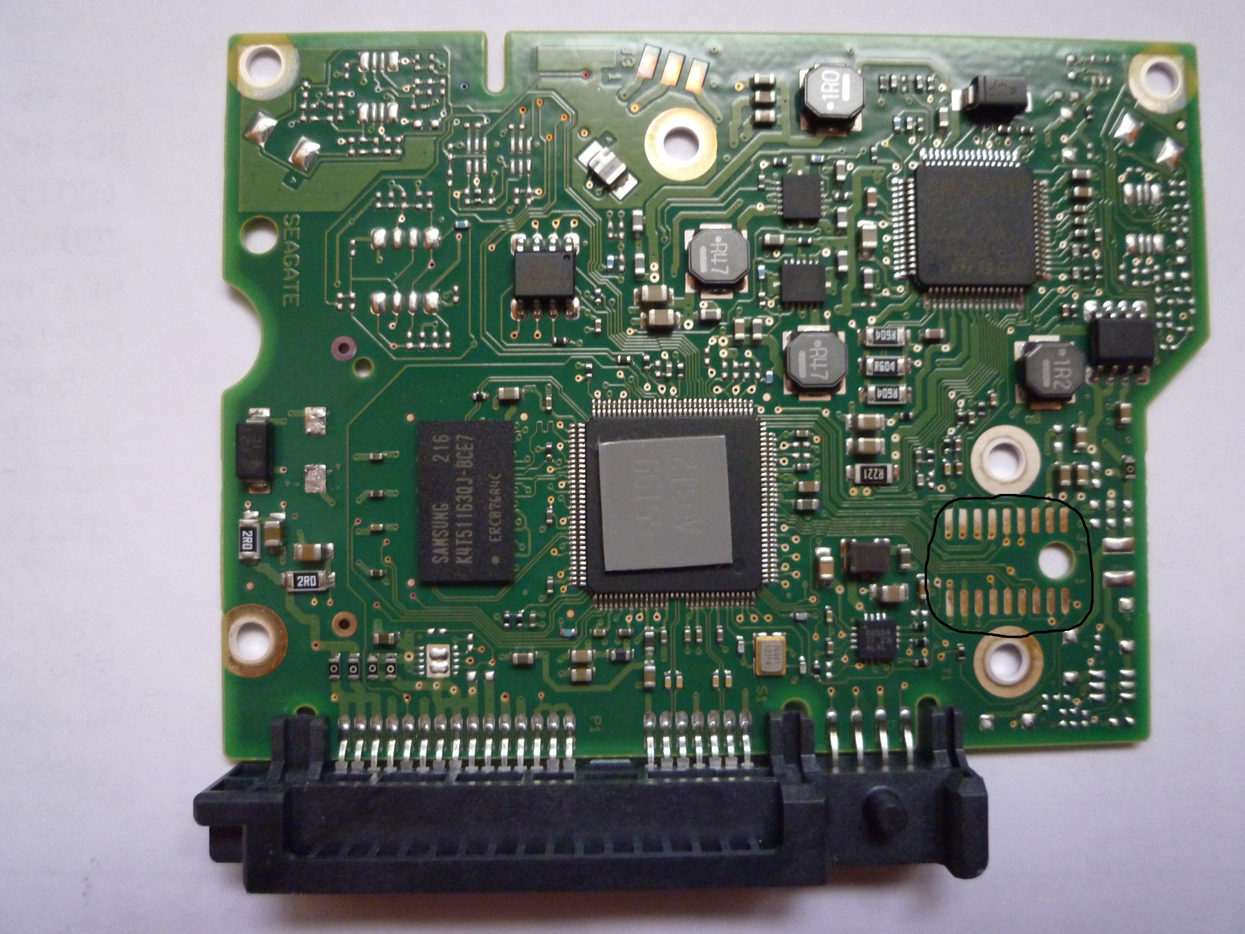

HEllo... is the typical "asian spit" in seagate drives. You must carefully sanding and clean it with alcohol (marked zone in black). Believe me, I saved several drives with that method. Good Luck.
