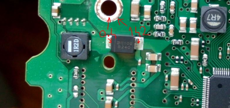

Hello to all !
Please for help, yesterday i attach sata cable(computer is on :(), then sata power cable, small part stj009 is blown, pcb is unscrewed, as you can see on the picture, 8pin mosfet is removed.
My question is:
Is this part stj009 same on 1.5Tb samsung HD154UI , i'll buy a used, defective disk because this part, so i replaced it ?
How to know if it's something else burned ? Do you advise me to measure something ?
Three pins that I marked, from right to left, at the same pulse, right ?
Please, any help is welcome.

The MOSFET, coil and diode constitute the -5V supply for the preamp inside the HDA. With the board on the drive, and with power off, measure the resistance between ground and the RHS of the diode. If this resistance is close to zero, then the preamp will be shorted.
You should still be able to measure the Vcore and Vio voltages with the MOSFET out. That should tell you if the board is still partly alive.
I would expect that you should be able to find an equivalent MOSFET at Farnell, RS Components, etc.

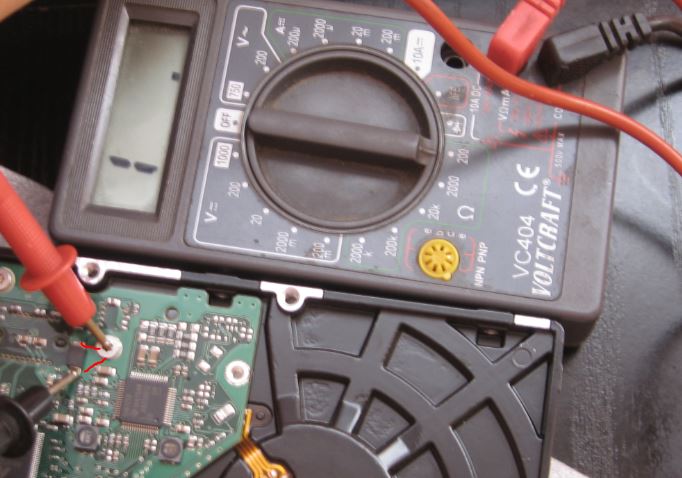

Today i checked multimeter, i suspect that is not working as it should, i was right, not working properly.
I found another and i repeated measurements, now look like this. (200 om range on multim.)
0.4 and 142, pcb without mosfet, mounted on hdd with screws.
 Post subject: Re: Hard Disk Samsung F4 HD204UI - Mosfet stj009 is blown
PostPosted: April 24th, 2015, 16:19
Posts: 17222
The cathode of the MOSFET is connected to ground via the coil. The coil is the reason for the low resistance.

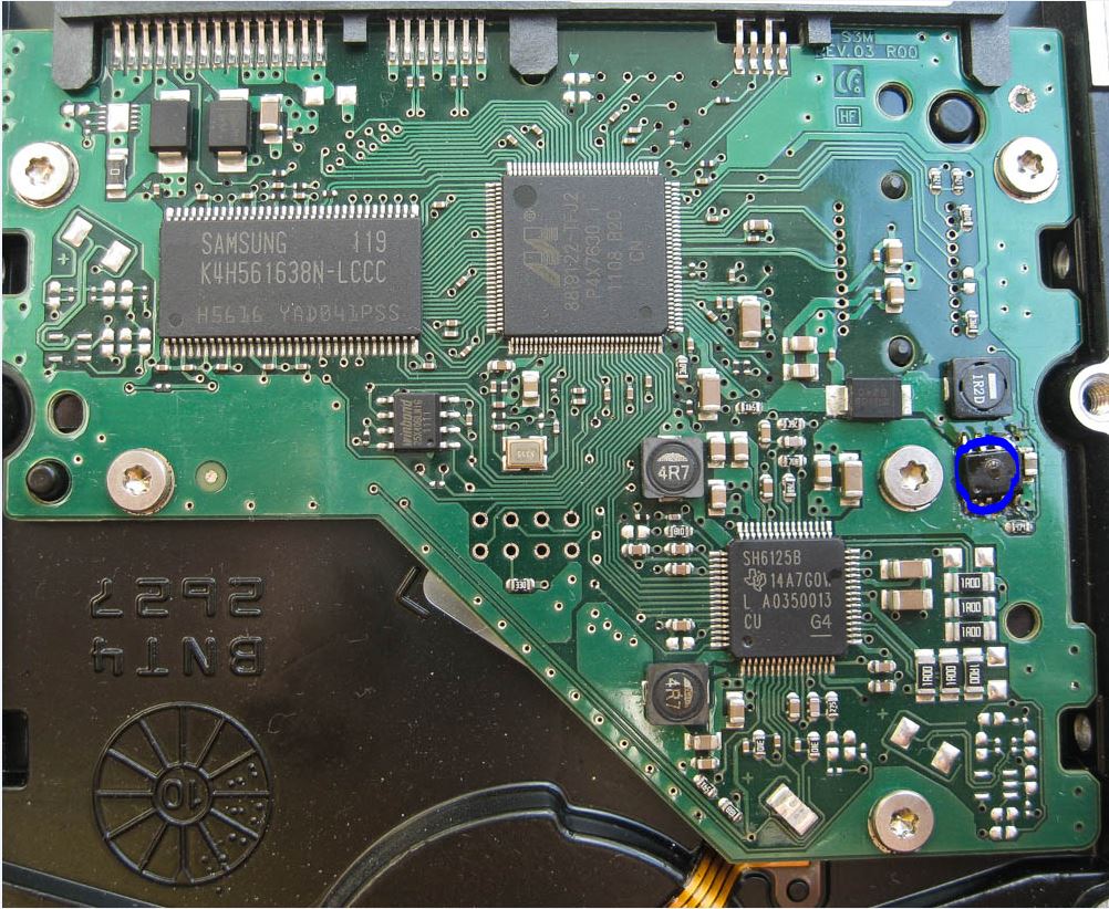

I replaced 8pin mosfet stj009, then i put the disk into the computer. I started, before boot i pressed f12, disk appeared in the list of boot menu, spin up etc, right after that (2-3sec) same mosfet stj009 is burn :(
A second element which is located before the MOSFET leads to problems.
fzabkar, what causes this, what do you think, do i need to measure some other value ?
Tomorrow I'll have another one mosfet, which part i should also to replace ?

This is a photo

You should really test the board on its own before installing it on your drive.
AFAICS, aside from a flaky preamp, the only other culprits could be a leaky diode, intermittent coil (shorted turns), or an intermittent motor controller. It's not an easy fault to troubleshoot. At this stage I agree with Spildit, ie you should consider swapping the PCB, with a "ROM" swap. In fact, if you obtained your MOSFET from a functional donor PCB, then it would have been easier to swap the ROM rather than the MOSFET.
