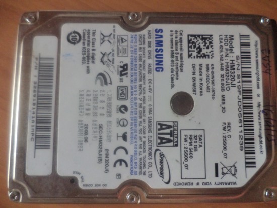

 Post subject: Samsung 320GB USB hdd, withincasing busy-constantly lit
PostPosted: April 22nd, 2015, 12:03
Joined: April 22nd, 2015, 11:55
Location: india
I have taken it out of the USB casing, now no detection in PC. Also no spinning of motor feeled.
I do not have important data, but want to make the hdd usable, anyone can suggest what to do?

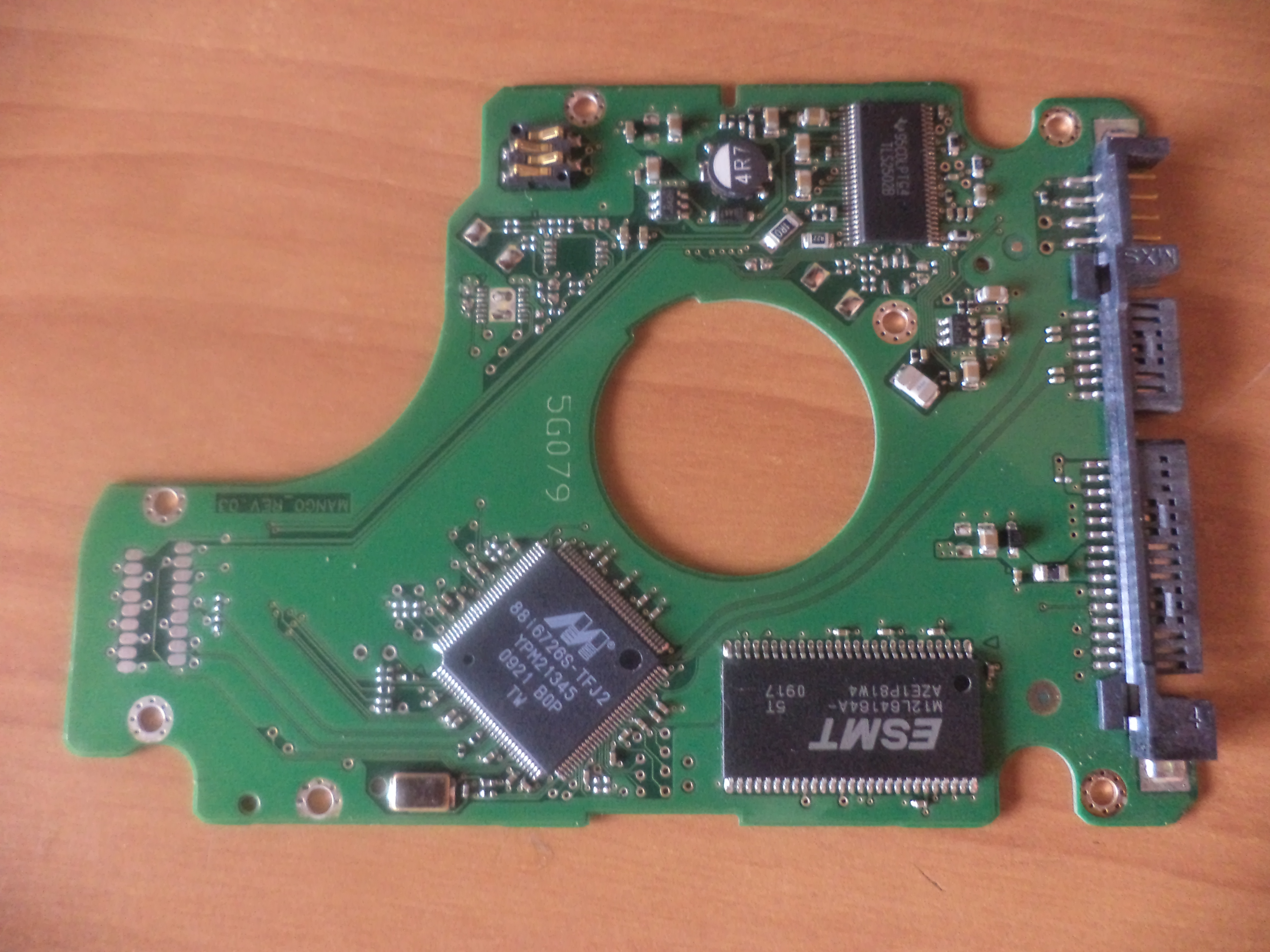

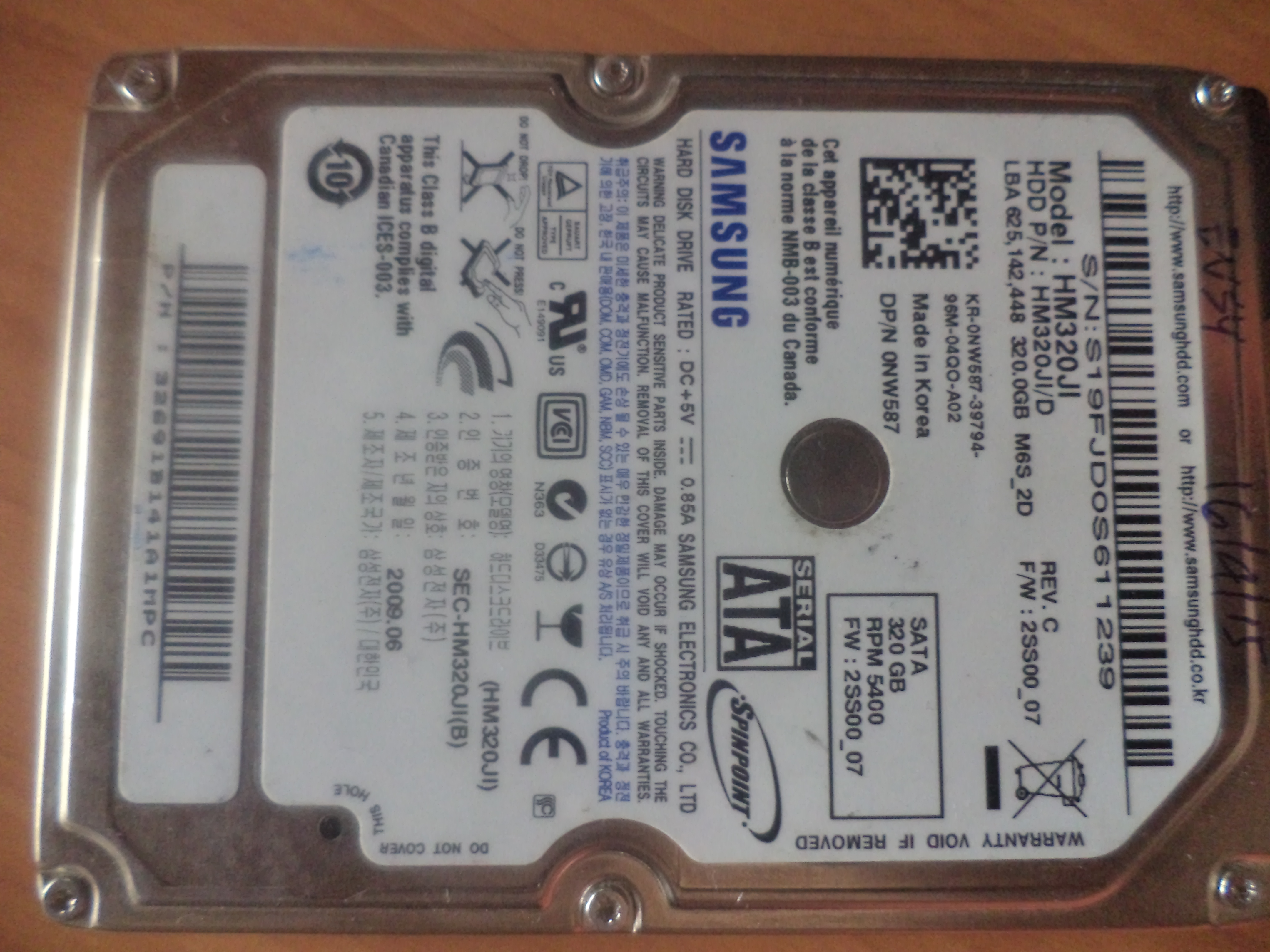

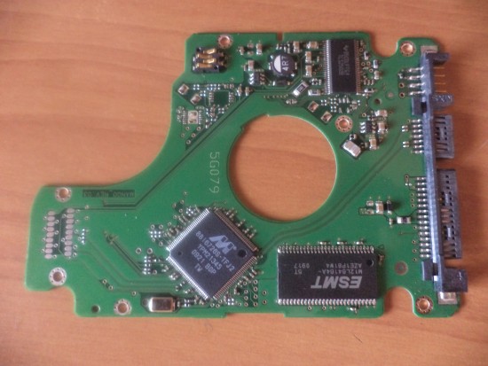

 Post subject: Re: Samsung 320GB USB hdd, withincasing busy-constantly lit
PostPosted: April 22nd, 2015, 22:34
Location: india
Spildit,
here are the pictures.
PostPosted: April 23rd, 2015, 3:15

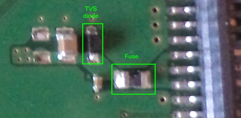

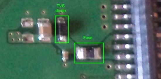

Posts: 17323
Check the resistance of the fuse and TVS diode with a multimeter. Let us know what you find before proceeding.
PostPosted: April 24th, 2015, 21:56
Joined: December 9th, 2010, 2:59
Posts: 241
Location: kolkata
In both cases of TVSE and FUSE, Multimeter put at 200M gives reading of 0.9 (both straight and reverse way)
PostPosted: April 25th, 2015, 17:09
Posts: 17323
Confirm the resistances on the 200 ohms range. If the fuse is open (which appears to be the case), then that may be the only problem.
You should also confirm that there is no short between the 4R7 coil and ground (Vcore), and between pin #1 of the SDRAM (Vio) and ground.

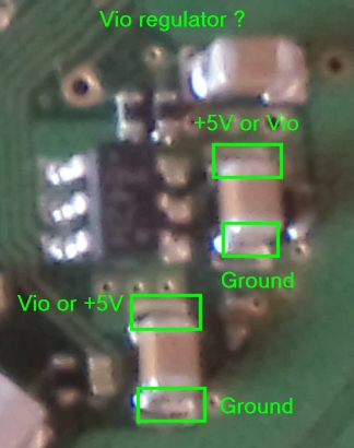

PostPosted: April 26th, 2015, 1:21

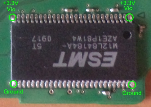

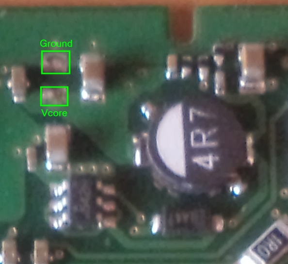

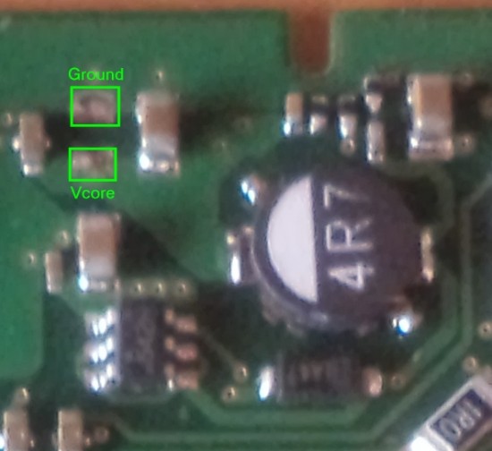

Posts: 17323
Attached are the power supply test points, AFAICT. Set your DMM on the 200 ohms range and measure the resistance between ground and each of the Vio, Vcore and +5V test points.
