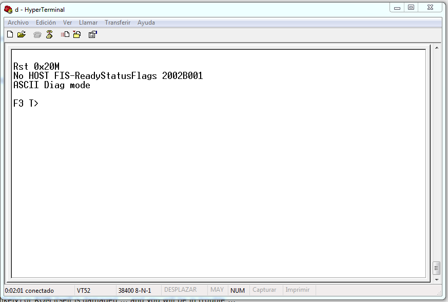

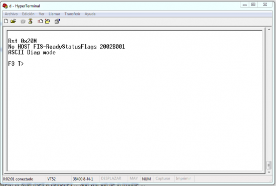

My fault! Sorry. I was writing the prompts with the PCB atached to the HDD. Without it this is the prompt:

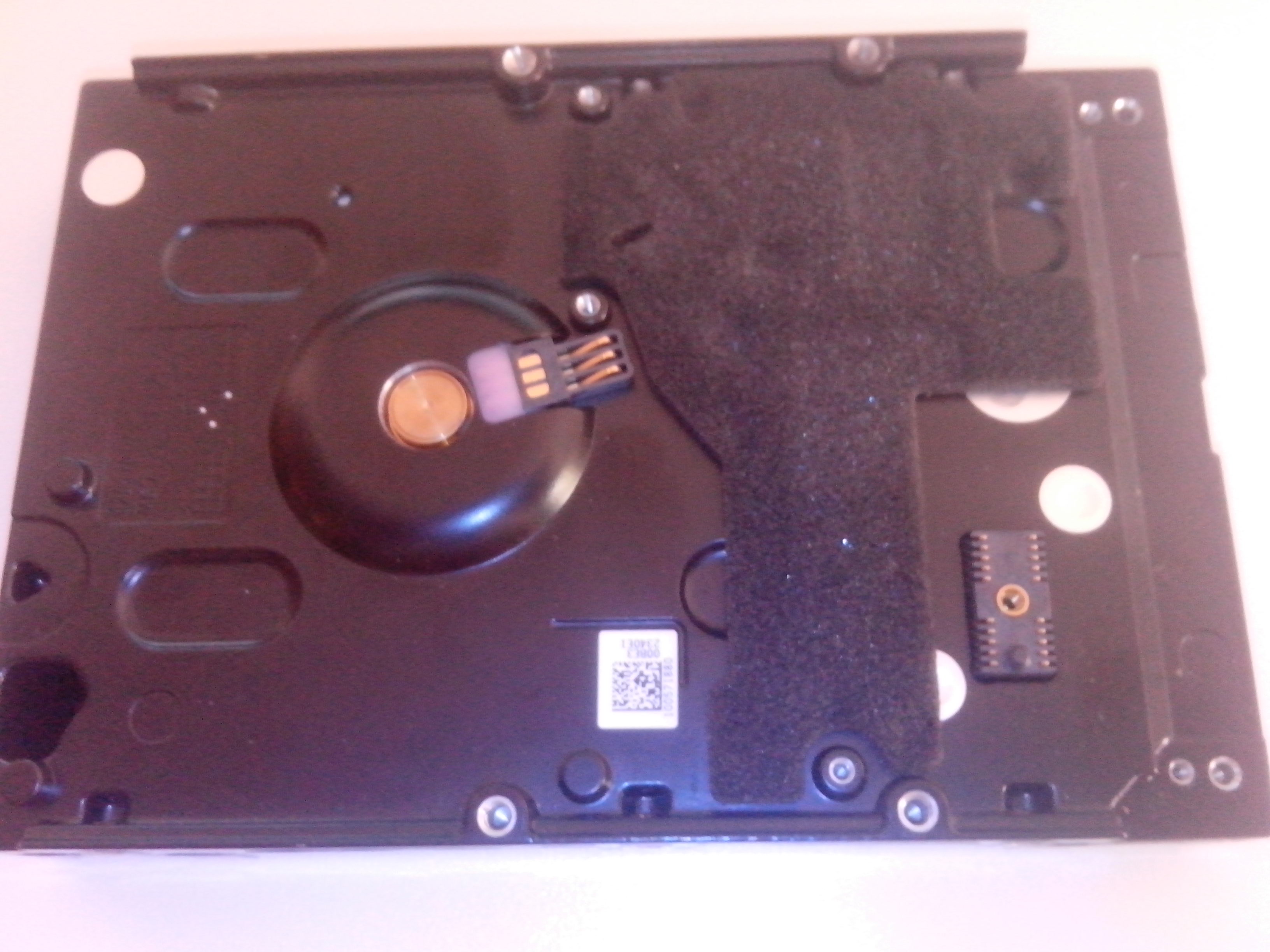

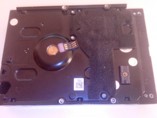

Wich contact is wich?
 Post subject: Re: Seagate Barracuda 7200.12
PostPosted: April 22nd, 2015, 7:02
Joined: April 18th, 2015, 17:42
Posts: 12
Location: Spain
Spildit wrote:
The set of contacts that connect the pcb to the drive but leave the contacts that connect the spindle to the pcb. Post a PCB photo component side and i will mark it for you.

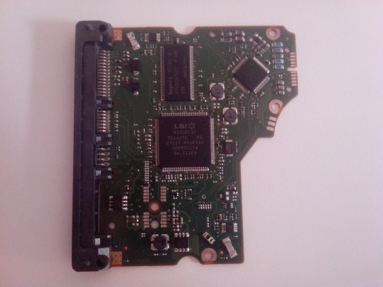

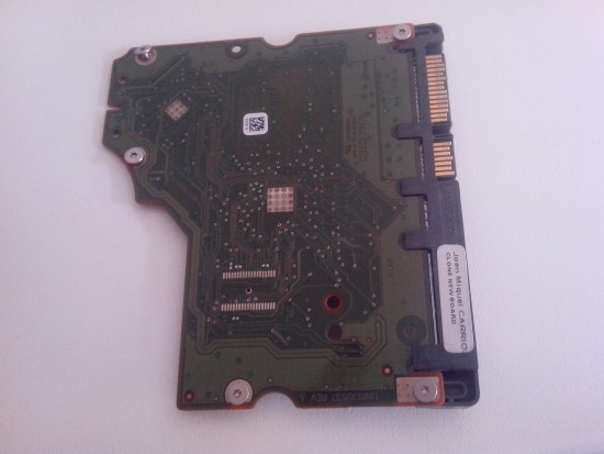

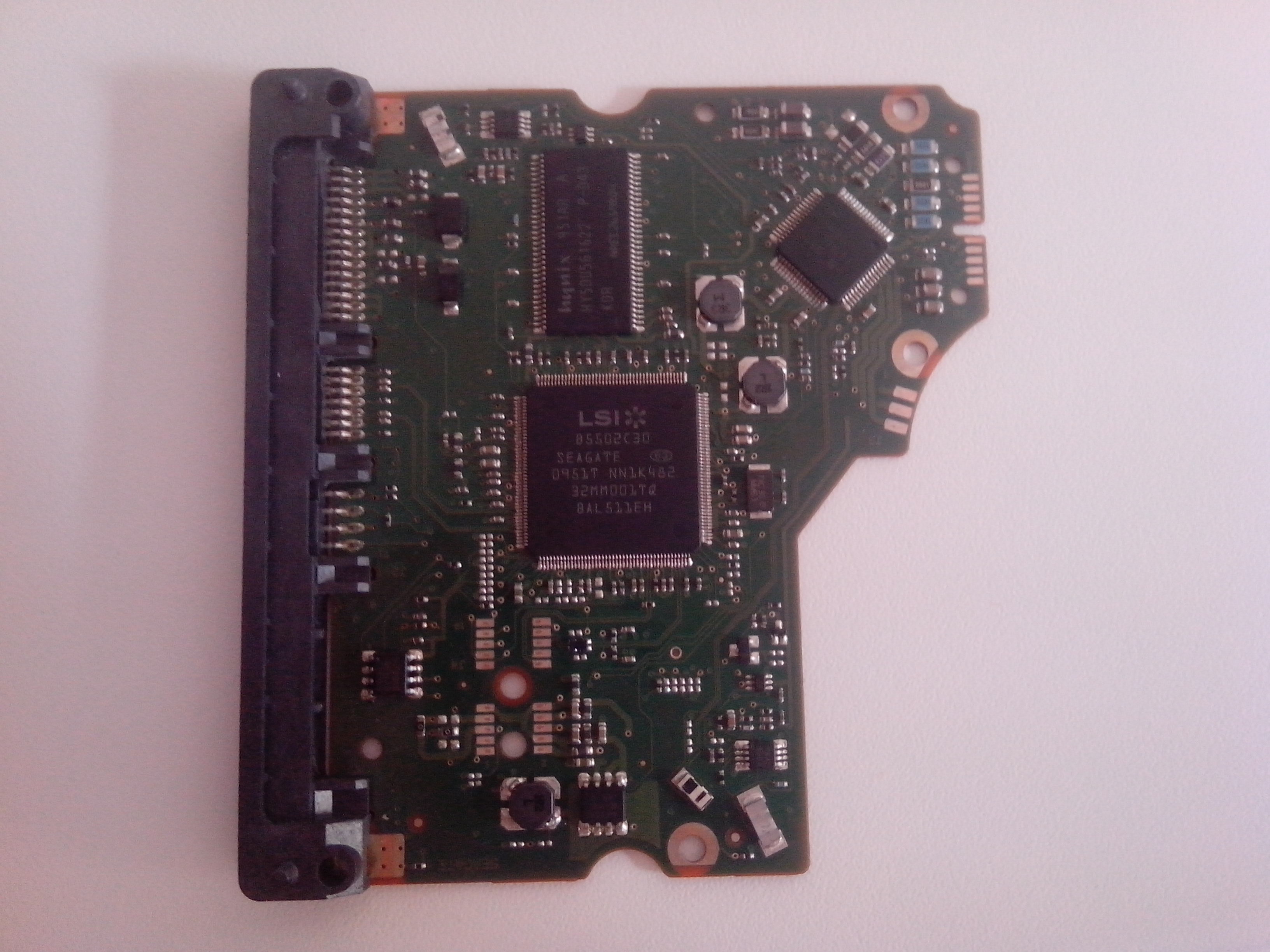

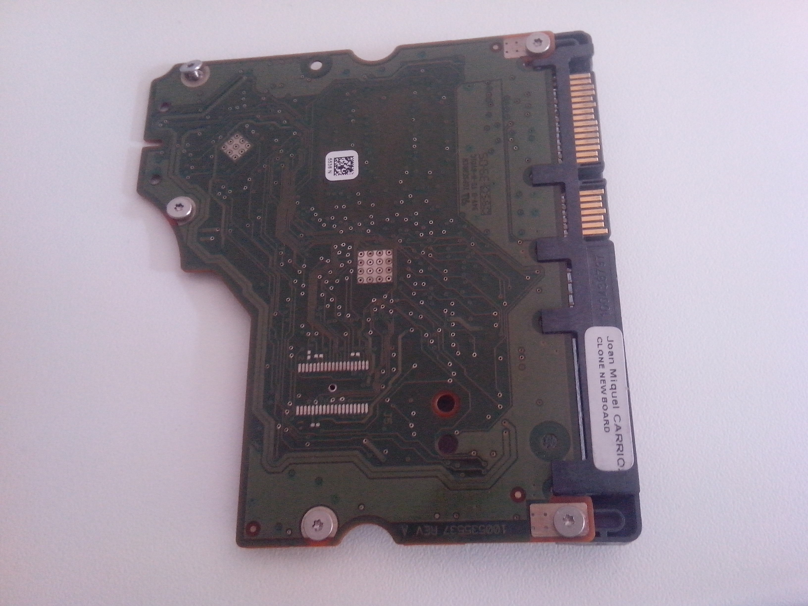

Onestly Spildit Thanks for everything. Here are the photos:
PostPosted: April 22nd, 2015, 11:17
Joined: July 2nd, 2011, 14:16
Posts: 463
Maybe when the company cloned the ROM chip, they did not do it correctly, best to move the Rom chip from the old drive to the new one. Just a thought.
PostPosted: April 25th, 2015, 8:24
Posts: 12
Location: Spain
I don't know where to start from. I insulated the head as you said and everything still normal. But suddenly the spindle spinning with some difficulty to finally stop. After few minutes it starts spinning very fast (I suppose its normal speed). I could stop it by terminal with the Z command. Tried to start it again with U and it spin as fast as before. But this time I couldnt stop so I unnpluged it. Now the drive is spinning as the beginning, with some difficult. Y must say the headers where out of the platters.
