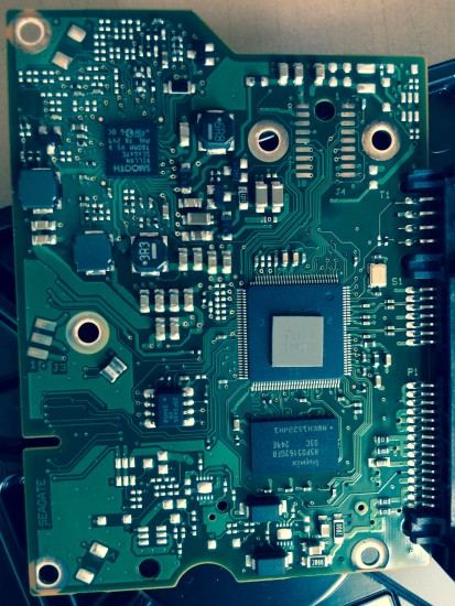

Does this look normal? It seems like several of the connectors are corroded...
 Post subject: Re: ST3000DM001 spins but no longer seen by OS
PostPosted: April 29th, 2015, 5:51
You can try cleaning them with a soft pencil eraser, but it's very unlikely to make any difference.
