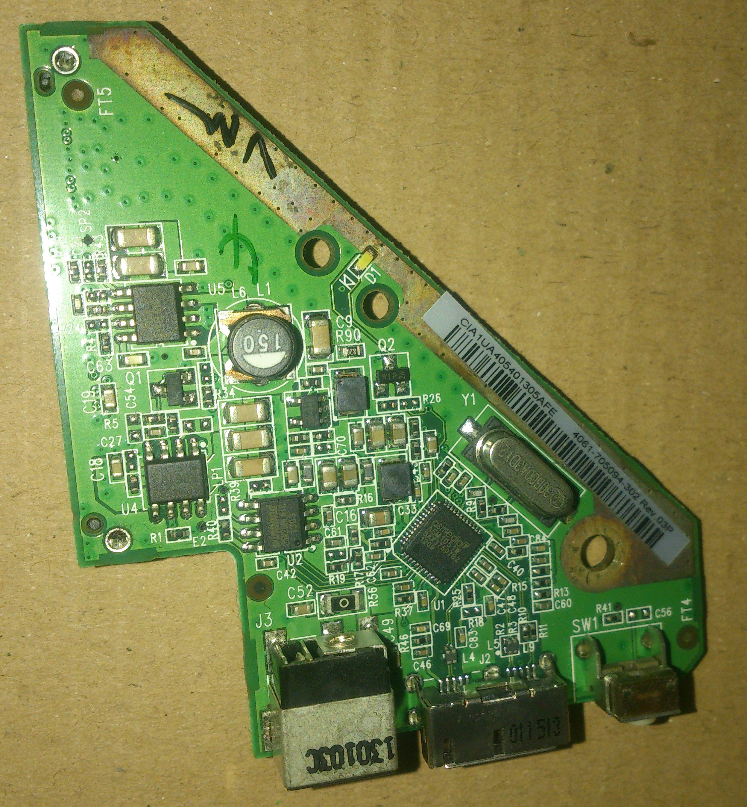

I dropped it last week, but I am not sure if used it since. I recall unplugging the USB once without doing the safely remove thing recently. Anyway
1- When connected through USB, it lights up, spins, LED is on but windows doesn't show anything. Not even in disk management. On a different PC, it shows its name for a split second on safely remove then it goes away and says windows can't recognize it.
2- Took it apart, removed the USB board and used SATA instead. Windows freezes. BIOS won't detect it as a hard disk even.
3- There's hardly any noise. Only when it fires up, then it just idles with a faint tick ever 5-10 seconds.
4- Disk never had a password on it.
5- Recently I changed the drivename but I don't remember if it was before or after the drop, or the time I unplugged it.
6- No I didn't use any power adapter apart from the one that came with it.

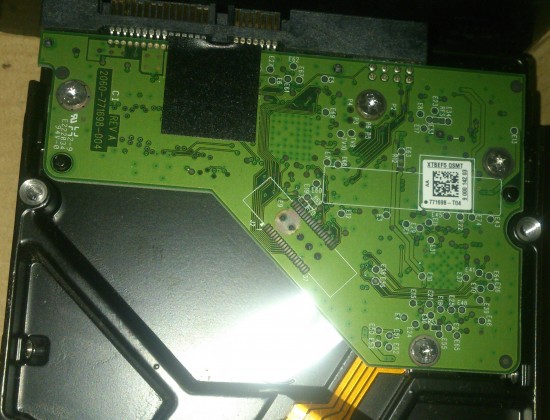

I attached pictures of the boards. I can't find replacements for them anywhere. There are NO recovery professionals in the region, at all. I don't have the tools to swap the U2 chip if that is necessary.

The problem is more than likely of mechanical nature with the internal read-write system. Nothing to do with the electronics.

Yes, a dropped drive gets R/W heads problem, and you should not power on this drive anymore.
Where you from? Maybe someone here in the forum can help you.
This external WD model does decrypt the data on the drive on default, without you setting any password.

this is entirely different situation, because OP of the post has damaged enclosure, not a dropped disk.
Because of WD MY Book the options are really narrow, these drives are encrypted by the USB bridge.

Just a question. What is supposed to happen when you run a WD mybook as an internal 3.5? Does it show up normally in windows or not?
 Post subject: Re: WD Mybook won't get recognized - HELP
PostPosted: April 25th, 2015, 13:14
Posts: 256
Location: Turkey
these Western Digital drives are encrypted by USB bridge, it is useless to connect them as internal disk, you will not see any data.
Essentials models are encrypted whereas Elements are not.
An additional potential complication is that 3TB+ enclosures are configured with a sector size of 4096 bytes. If you remove the drive from such an enclosure and attach it to your computer's SATA port, you will expose the drive's native 512e sectoring and end up with a 4Kn file system on a 512e physical drive. Windows will see partitions that are reduced in size by a factor of 8, but all the boot sectors will be in the wrong place, so Windows will offer to format the drive.
