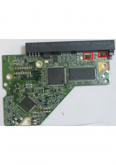

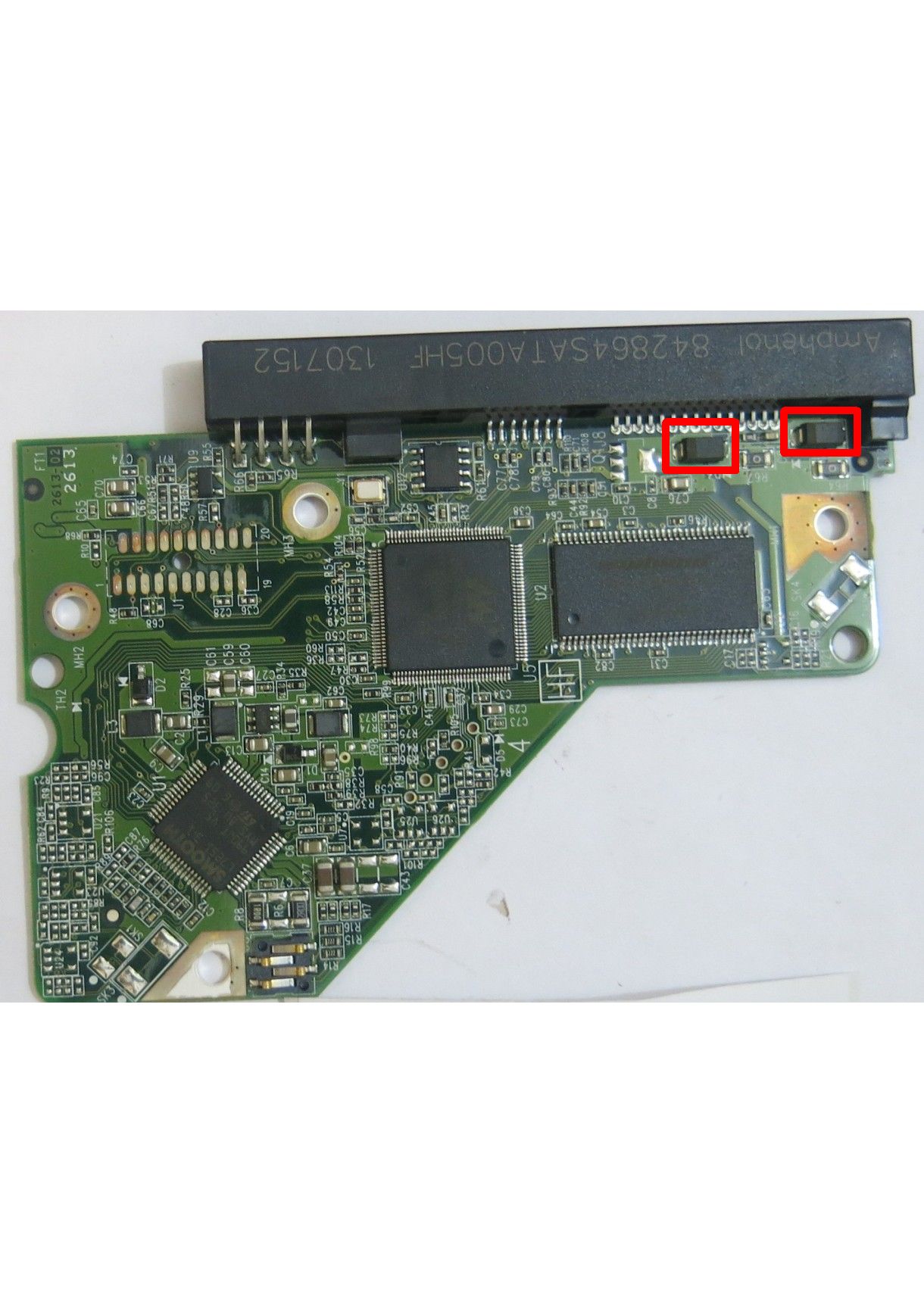

There's a chance that the issue is just a blown TVS diode on the drive. That model typically has PCB number 2060-774640 which has TVS diodes on both the 5V and 12V rails.
Get yourself a multimeter and check for resistance across these two components. If either one reads dead short measured in both directions, it can simply be removed.
Just be sure you're running on a clean power supply, preferably plugged into a UPS battery, since removing that will expose other components to power surge damage.

Thanks DM, I could not find one handy to take a picture and show. Usually the one I see damaged the most is the one on the far right at the edge of the PCB

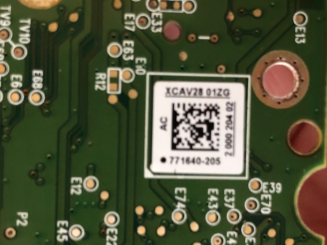

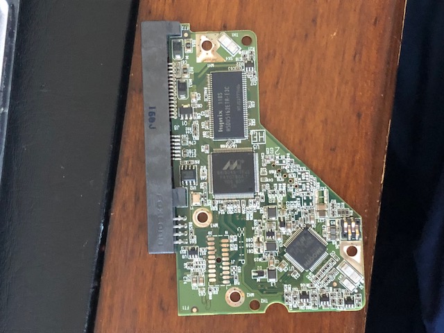

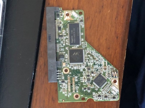

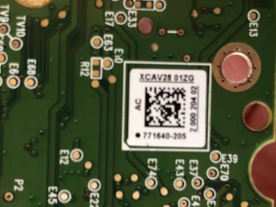

Ok here is a picture. Also I tested resistance and it works oneway but not the other is that correct? Or am I doing something wrong?

@SSStang, are you saying that both diodes test the same way?
Can you give proper resistance readings for the diodes and zero-ohm resistors?
http://www.hddoracle.com/download/file.php?id=5420&mode=view
You can read the instructions in my FAQ:
