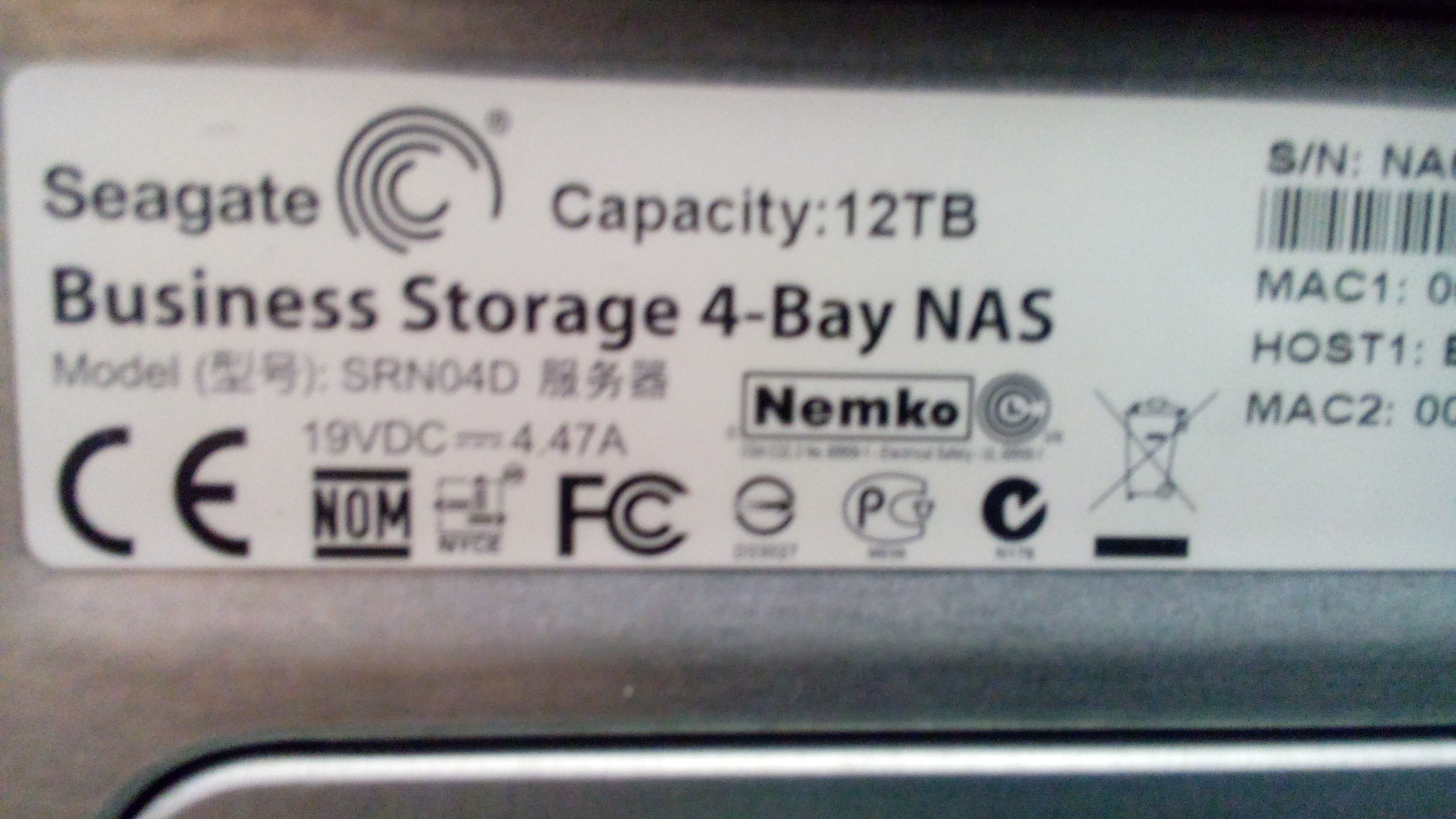

I have a Seagate NAS storage with 4x3Tb hdd.
First hdd failed, can I power on case with a new hdd or without first hdd?

Oh man, those NAS... they were one of my first recoveries.
Was really the hdd that failed or the NAS itself ?
If it was the NAS and now you can't acess the files on the disk, try this:
a) You may try a new hdd, but things might get even more strange (trust me, I've been there)
b) If i remember correctly those NAS disks are formated in ext4, the case I got on my hands, the NAS had a pcb malfunction and that was affecting the disks. Remove all of them from the enclosure and with a external dock and a linux distro, use MDADM and one by one you will be able to retrieve the files.

Your box is RAID 0 (stripe) or SPAN RAID (JBOD). To keep data alive better to make max image from bad drive. Further, you should use this image for new drive or constructing your box raid systems virtually.

databack wrote:
I think RAID 5
Your box is 12TB, you have 4 of 3TB drives... Think better ;)

Suitsof wrote:
databack wrote:
I think RAID 5
12TB?! When use RAID 5!!!???

databack wrote:
Suitsof wrote:
databack wrote:
I think RAID 5
On the photo you shown is determined the box capacity. If it's configuration was changed (for example, to 8TB) you need to tell about it.

Suitsof wrote:
databack wrote:
Suitsof wrote:
databack wrote:
I think RAID 5
Oh man, this is a model of this box, this is a max capacity supported by this model. You can buy 16TB or other models
